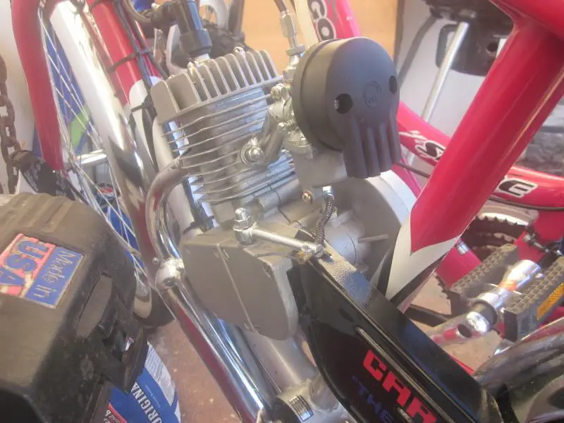

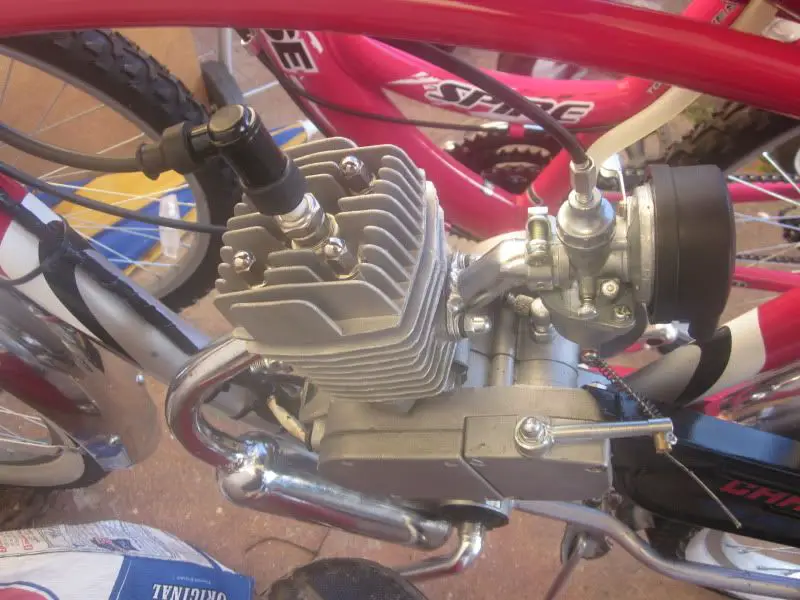

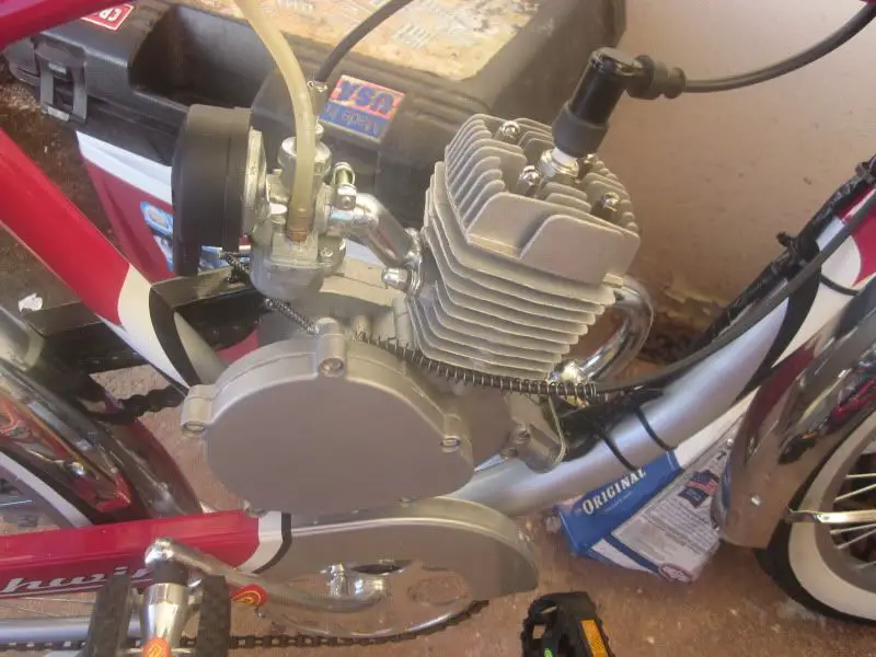

    Cool. Thanks for all the advice. Rode with a moped equiped with a speedometer and it rides 25MPH on straight ground but im worried
    of over revving. I have no clue how to measure bore and stroke but
    heres a quick pic of how it looks mounted on the bike.

    Your engine looks just like the bgf 48cc I have, but then again it looks like a 66cc also. mine has nuts that hold the head on that are a 10mm wrench size.

    Looks like you have the NT or Speed carb, definately not the CNS carb. As for bore, I'm not sure you can tell from looking from the outside, so not sure if its 48cc or 66cc. Were there any stickers that were removed or other documentation with the motor?

    Wow, 10mm nuts on the head??? My Grubee 66cc has 13mm acorn nuts, and the newer Grubee's have 14mm standard nuts on the head studs. Are you sure you're not mistaken, 10mm seems kinda small for the head? (like intake/exhaust size)

    DIdnt see any stickers at all. Perhaps I should ask the shop that donated the bike to the company I work for so I can finaly settle this once and for all. I need more speed in this thing hehe imme speed junky. Im not so familiar with 2 cycle engine but used to race Hondas as a hobby till I got into offroading. I need to lose some weight too. HEHEH. Where and how exactly do i chose the right performance carb for thise thing? I think itll be my first little upgrade.
