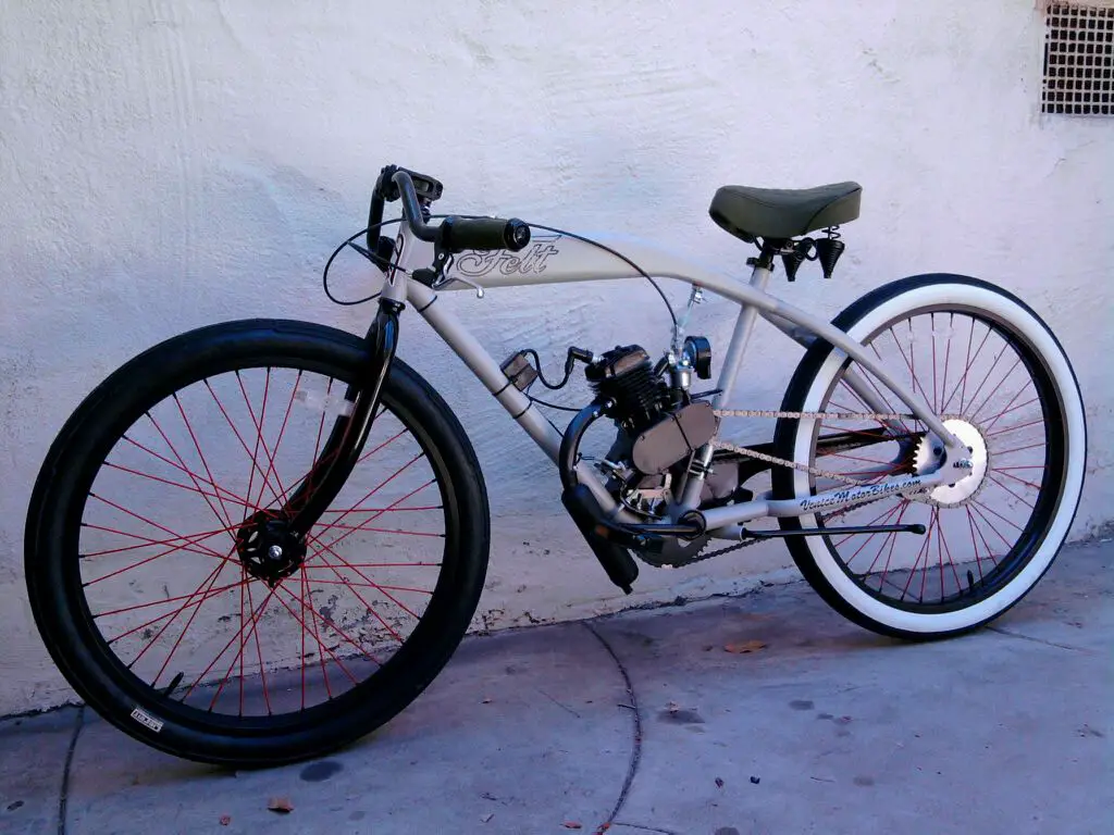

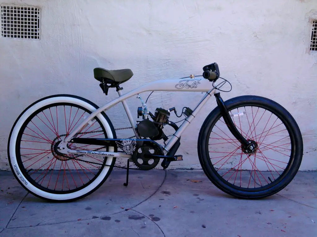

Here's my dream bike that I just finished building for a customer... A Felt Revolver. (Now I have to have one for myself!!)
This bike performed flawlessly on it's maiden voyage, a 20+ mile club ride.
I did a 'in frame' gas tank, custom 1/2" offset steel motor mounts, & I also hollowed out the muffler making it into a expansion chamber, (the engine loved it) It had tons of smooth power & it wasn't too loud.

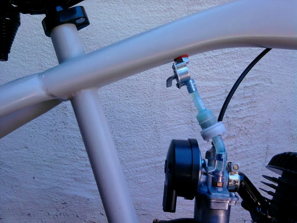

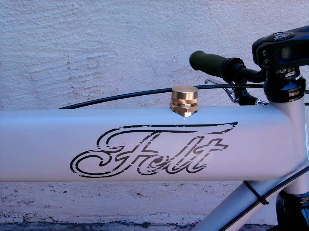

Nice job AGAIN ! This in frame tank looks different then others I've seen.Could you ...would you talk alittle about how you did this tank.All the others I have seen have been cut and rewelded.Your method seem to be different?

I have to say this bike looks amazing some really nice touches to the bike. I have just one question where is the world did you get the fuel filler neck I have been looking for a quality filler neck for a long time care to share ???

That is a very nice Felt. Nice job on the tank also. The only thing that doesn't work in my eye is the whitewall on the rear, is there a reason for this? A black on the back would make this thing teets, honestly!
Nice build, cheers!
I've tested several products to seal the rear of the tank & I finally found one that worked perfect!! (I'm keeping it a secret for a short time) The rest is carefully applied JB weld & tank Kreem.
Nice build, cheers!
I kinda agree about the single whitewall, but thats the way Felt makes 'em. (but the look grows on ya!) :)

Thanks Norm, was just really curious about that, thought maybe the guy likes em that way;)
I also had a sneeky suspicion that TB would be gettin that answer....can't say I blames ya fer not lettin the cat outta the bag.....but when ya do! I really need to turn my fat alloy top tubes into tanks...looks so much cleaner. Cheers!
