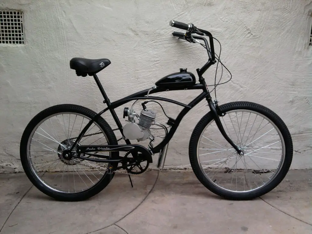

This is how I mounted mine and so far in 500 miles I've been very happy with it. Although I feel it reduces vibration, the main advantage is hockey pucks are easy to work with and make it easy to adjust the size of your mount to accommodate different size frames.

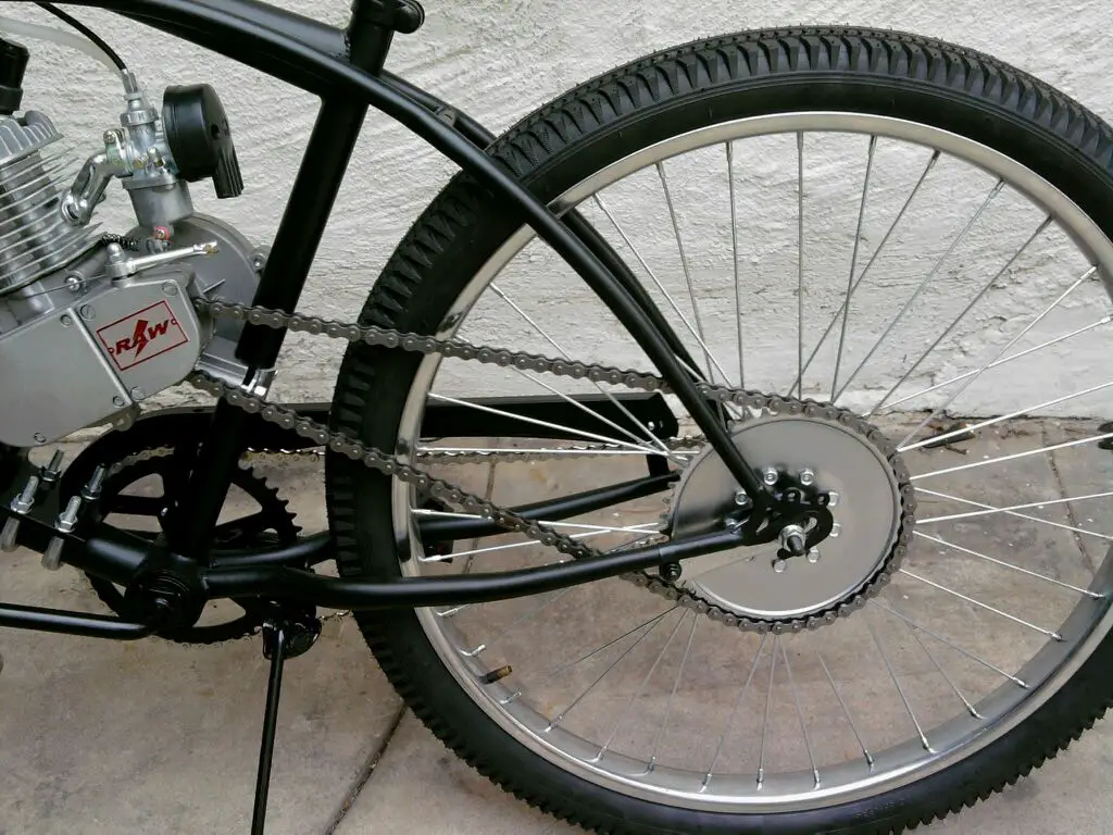

I notice on the worksman frame that the China 2 stroke doesnt clamp up as nicely as I would like.
Any suggestions? I read the thread. Saw the shims. Anymore info on these, or advice from someone that's clamped a stock China 2 stroke into a stock worksman INB frame?
