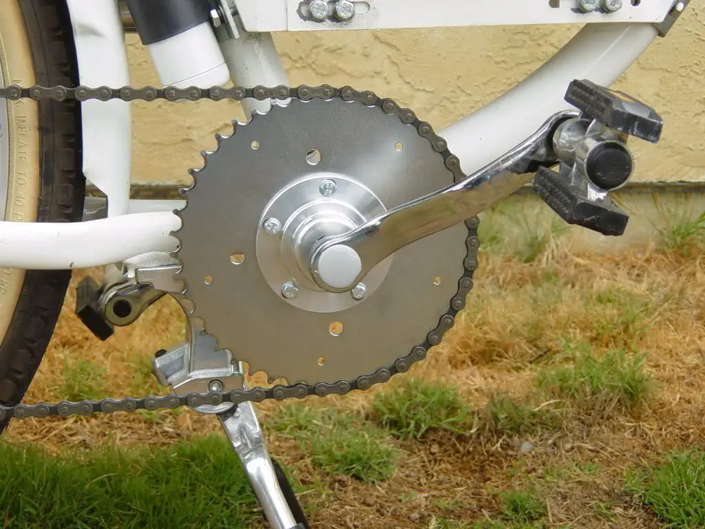

This is what I recommend and have used on my Point Beach:
Adapter: http://www.sickbikeparts.com/catalo...ucts_id=104&osCsid=omedq5no9ih2hggj675og02075
and
Bottom bracket: http://www.sickbikeparts.com/catalo...ucts_id=114&osCsid=omedq5no9ih2hggj675og02075
and
Chainring adapter:http://www.sickbikeparts.com/catalo...ucts_id=158&osCsid=omedq5no9ih2hggj675og02075
and any of their chain rings of your choice.
http://www.sickbikeparts.com/catalog/index.php?cPath=21&osCsid=omedq5no9ih2hggj675og02075
I used a 44 tooth chainring.
The above set up is a bit pricy, but near bulletproof and worth every penny.
You can either use their (SBP's) crank arms or I used the bent ones that I got from bicycle-engines.com: http://www.bicycle-engines.com/3pc-Wide-Crank-Pedal-Kit-4S-CDS-3pcCRANK.html
I cannot recommend using the whole kit from bicycle engines.com because, for me at least, the sprocket mount is cheesy and the bottom bracket spindle poorly finished, is extremely soft and bends way too easily.
GearNut
Aug 19, 2009
5,104
11
38
San Diego, Kaliforgnia
You could, but then you would be at a loss as how to attach a sprocket to the bottom bracket spindle.
The B-E.com sprocket uses a cotter key and nut to hold the sprocket onto the spindle.
**Lame.**
The SBP spindle has a keyway machined into it to accept a woodruff key and their sprocket adapter also has a matching keyway ( and the woodruff key comes with it).
This is a very strong and reliable method of attachment.
You could use the B-E.com cheesy sprocket on the SBP spindle if you filed down a flat spot on the spindle to accept the cotter key. I highly recommend against this though.
Cotter keys are very old technology that work well...once. Take them apart and most of the time you have problems re-assembling them later.
Take my old setup for example, the cotter key received a deep gouge in it and at the same time rounded the edge off of the matching flat spot on the cheesy soft B-E.com spindle.
