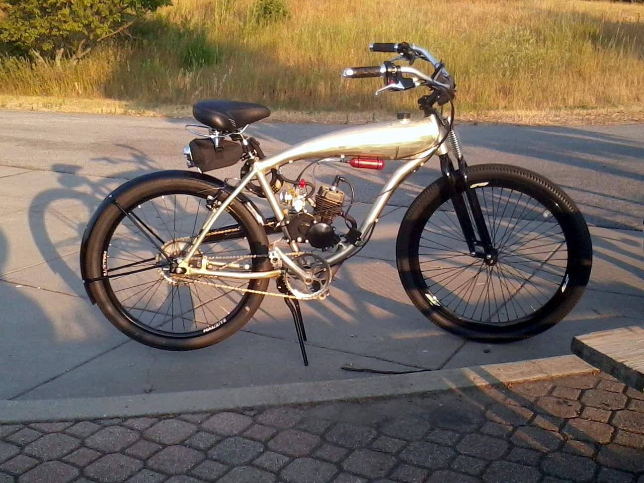

hey guys stumbled across this picture of my bike in progress ( i will go back and read thru the thread to see whats the chit chat is about ) wanted to share a updated picture
The paint... The bloody paint will not stay on the frame. I will wait for it to wear enough that's it worth it to buy a bunch more spray paint or maybe EVEN use an airbrush.
PLEASE FOLKS BUY PRIMER.
do you know you need to paint it with etching primer? because its aluminum or it will never stick no matter how many times you try
No :( pistonbikes said it has a combo primer/anti oxidizer and someone told me it's Alodine, another primer. Having nothing else to tinker with I went ahead and painted.
use a etching primer for best results its for aluminum and clean it down first with wax and grease remover it cleans everything that will screw your paint up from dirt to the grease from your fingers from toughing the frame
Rustoleum has an "Industrial" line. They sell primer specific to aluminium in white and grey. I used it with awesome results. My top coat was worse than the damn $6 can of primer.
