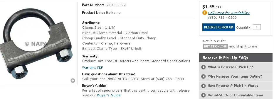

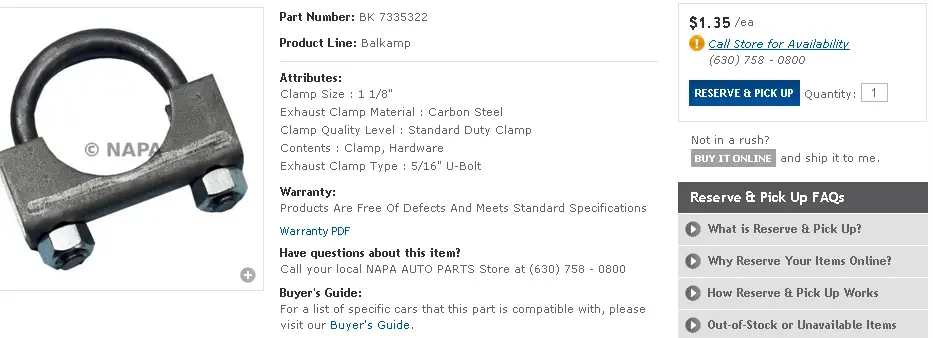

Ya Pablo or Jim ain't going to screw ya.They just help as best as they can from what the information they get. I use 1 1/8 on mine for a tighter fit so you should be good.
will purchase 1 1/8" clamp from napa online as they do not have any in stock at stores
i have checked couple of other places not one has 1 1/8" clamp
http://www.napaonline.com/Catalog/CatalogItemDetail.aspx/Exhaust-Clamp-1-1-8-/_/R-BK_7335322_0434861568

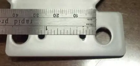

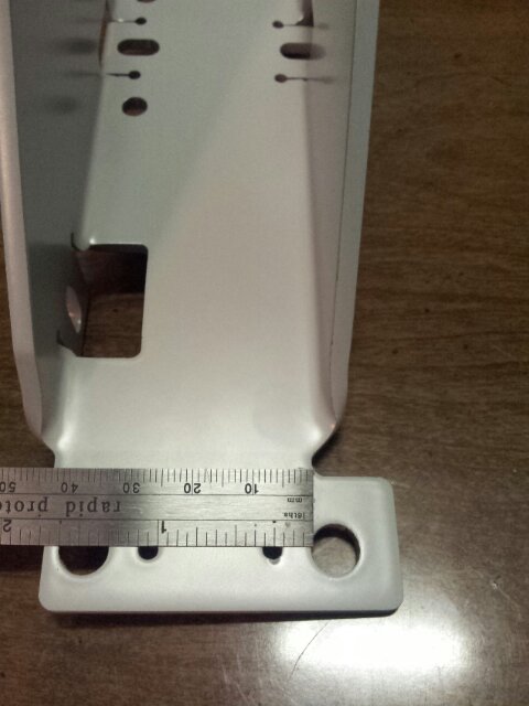

here is the picture of the 1.125 clamp and jack-shaft mount clamp holes
View attachment 67143 View attachment 67144

You clearly told me you have 1.125" seat tube. The clamp will fit if that is the case. The part you are missing with your measurement pictures that show over 1.125", is that the muff clamp is marked to fit 1.125" ID pipe so the measurement you show will be 1.125" plus wall thickness on each side, so close to 1.25" is about right.
