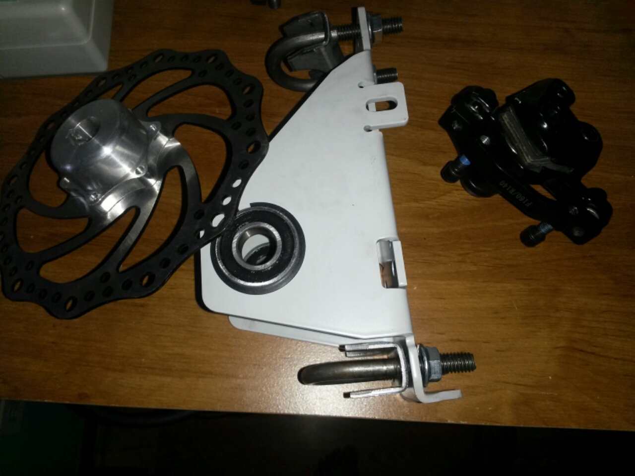

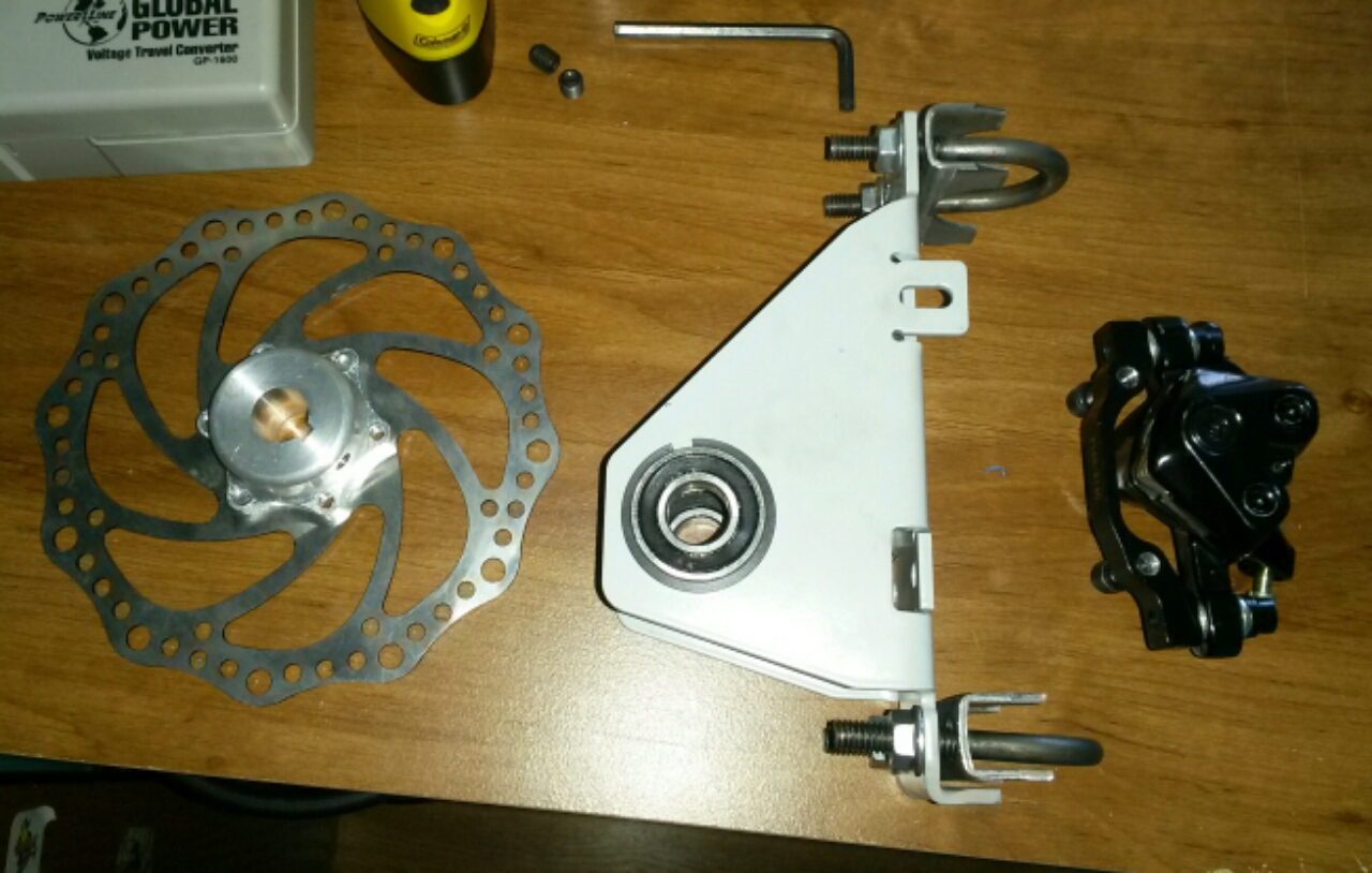

Does anyone know how to bolt disk brake on to sbp jack shaft mount, I just cant think of anything
Here is picture of disk, mount, brake

I checked so many pictures on this forum its not even funny, and nothing.

I have not heard of one person mounting the disc rotor to the sbp jackshaft. Several members have bolted the rotor to the AGK jackshaft on 4 stroke builds, but the AGK jackshaft is completely different. The jackshaft input sprocket on the AGK jackshaft is held in place with 3 bolts, the disc rotor bolts up to that. You have to get a bit creative with mounting the caliper. In your case, you're gonna have to get creative with the entire thing. You could order the jackshaft mini-hub from AGK, it will fit any 5/8 shaft, and use that is your input sprocket on the sbp j-shaft, that will allow you to mount the rotor, and then you will just need to get creative with mounting the caliper. Keep in mind, there is a serious gearing advantage with mounting the rotor on the jackshaft vs mounting it on a wheel, so the disc will grab much harder than normal. I briefly considered mounting a rotor to my agk j-shaft as an emergency brake, but then I decided to build my own wheels with front and rear drums.

Most likely you will need to make a bracket. Maybe out of angle iron then bolt it or weld it into position.
