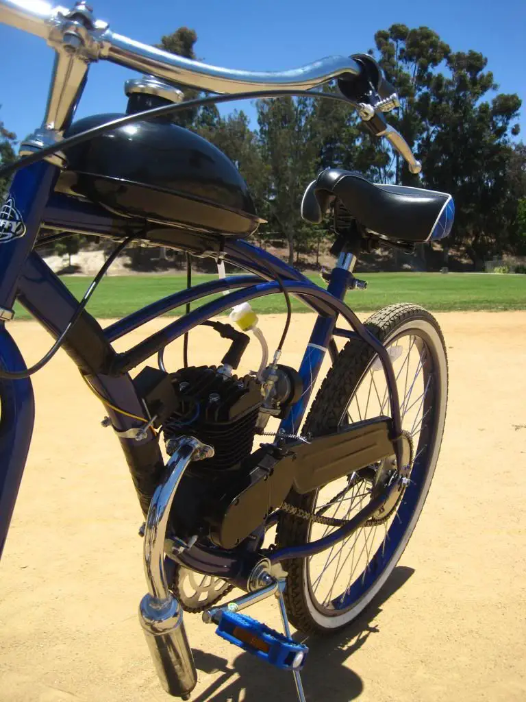

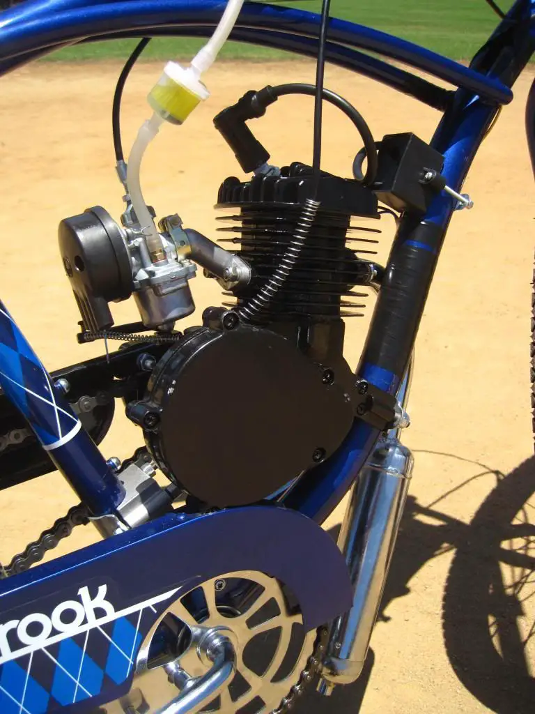

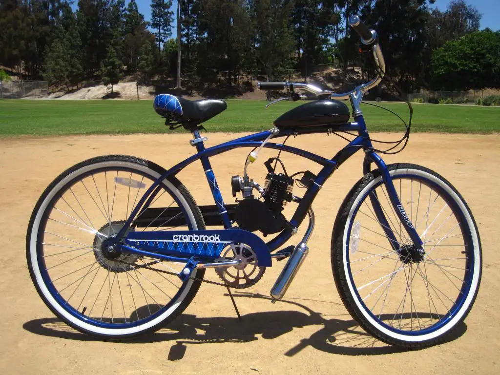

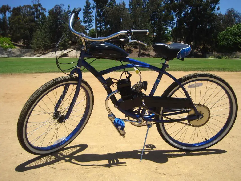

Bike: Its a huffy cranbrook.. I took apart all the bearings (and the coaster brake), cleaned them out, and repacked them with quality grease.
Engine: Black flaming horse kit from EngineOnlineShop. I am very pleased with the quality of the engine, but I can't say the same for the hardware as I replaced all of it as soon as I got the engine.
About the build: I did have some trouble with this build (more than I expected). The first problem is that the engine does not sit in the V of the frame. The frame is too wide, so I had to improvise without ordering any extra parts to keep the cost down. As you can see in the pictures, I extended the rear studs, and they have not shown any signs of bending. I made sure to buy quality hardware, and the lowest grade I used was 8.8, the highest being 10.9. The second problem I had was with the chain. I could not get the alignment right, but finally managed to without using the chain tensioner. The bike rides very well, but there is some 4 stroking. After I break it in some more, I will tune it unless someone buys it before then.

My last bike was a Cranbrook, and the only problem I had with it was the front tube being wider than the front engine mount, which I mounted the engine to a seatpost and the seatpost was clamped to the frame. Later on I got a different engine with a wider front mount and didn't need the seatpost anymore. I am not sure why you had an issue with the engine sitting in the frame properly. I did have some trouble with the chain rubbing the fat tires that came on the bike, solved it by switching to a skinnier tire. If I were selling a bike, I'd want to find a way to get the engine seated properly in the frame. Extending the rear studs may work ok for now, but its asking for trouble later. I would look at other for sale builds very closely to see what you could be doing better.

I could not let the engine sit in the frame because at the point it would have sat at, the bike's sprocket was in the way. On the next build I am having some blocks of aluminum machined that will fill the gap between the seat post and the engine. That should help make it stronger.

That sounds like a good idea. Maybe Huffy changed their frame design a bit. I seem to remember having to tilt the cylinder forward a tad to get mine to sit right. The carb doesn't have to be 100% level to work. But good luck with your business venture.

I think I'd replace the stock plug boot and wire, the fuel line, and probably the fuel filter, myself. By the way, from here it looks like the filter on that one is upside down. The boot and wire so I don't have the customer come back when it fails, and the line just for my own peace of mind.
