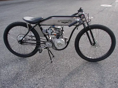

Great build, congratulations.
Actually, to me, it doesn't look entirely the same as the others, imo it has more of an antique look. I think it's cos of the motor setup & pedal sprocket setup.
What I love about it is how it is clearly such a ripper, but with smooth clean lines and this understated elegance. a little ol' fashioned, I guess you could say. pretty much rules the galaxy without even breaking a sweat.
Looking good. I love this bike. Just so professional looking and i just love the pedal setup, CVT's must make a nice ride but i love the look and simplicity (not that theres anything simple about it) and the cleaness of your bike...... and it must be so much fun to ride. Congratulations

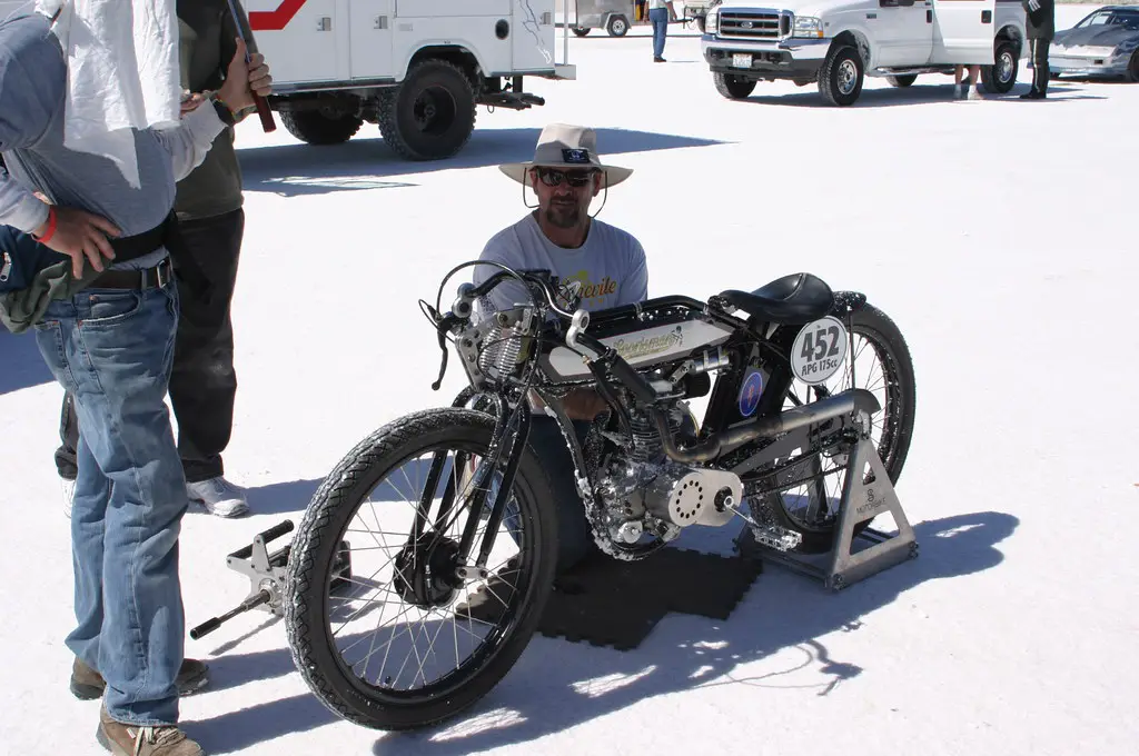

Wow, here is an old thread. Thanks for bringing it up. My brother worked through all the details for an electric starter on his bike and it works great. Required relocating the engine just a bit and was a tight squeeze, but it fit. Push button electric starter on a GX engine is such a nice feature. Here is a picture of his build with the starter system. You can see it stuffed between the engine and down tube.

Pretty cool.
Only a few have put electric starters on a motorized bike.
Joker Machine will have a 250 CC Briggs with electric start at the October 19th race.
78.769 mph on it's rookie run.
