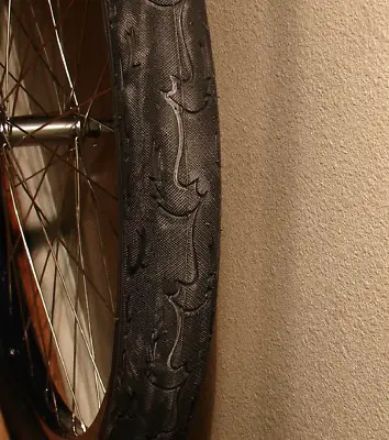

I also use the 3" & 2.4" Vee Rubber pedal cab tires 65 lbs. pressure and unreal wear and performance. Load carrying is double any other tire I've found they are tough. Street tire it's my favorite. New Orleans pedi-cabs use them to haul huge loads of tourists over some of the worst city streets in America.Hi Troy,
Bumping up an old thread here. Guess I have been building bike for quite awhile, now. I have used the Coker tiresbefore but not the one shown in your link. The one I did use was difficult to mount and didn't handle well at all. I have been using the pedalcab tires from Vee Rubber. About as tough as it gets.
As far as 3" tires, real 3" tires as some only claim 3" and are still 2.125, are a tight fit on the forks. Really too tight. I can measure a set later today.![]()

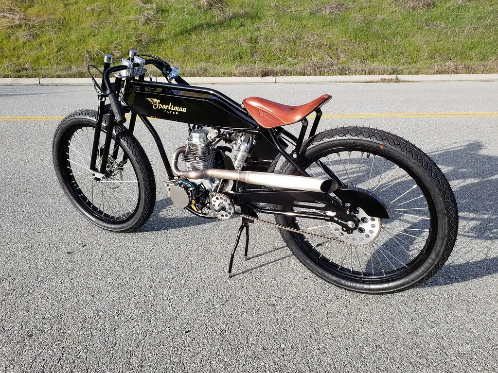

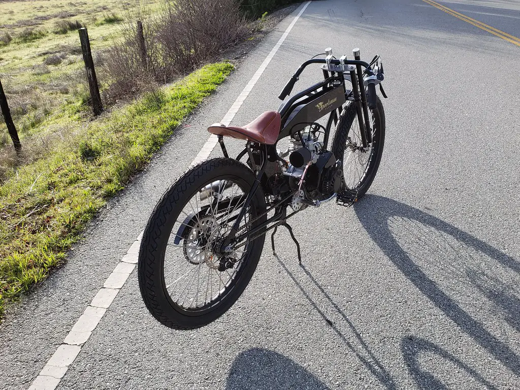

Sportsman 200 by Pat Dolan, on Flickr
Sportsman 200R by Pat Dolan, on Flickr
