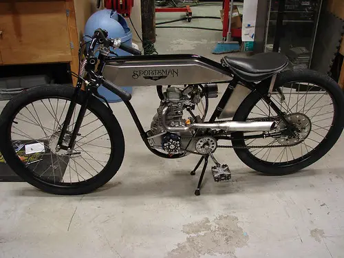

I got the frame back from powder coat. Did the standard gloss black. When designing the frame I tried to keep it as vintage looking as possible with the engine mounts. So here is the lugged style frame, looking like something from 1918.

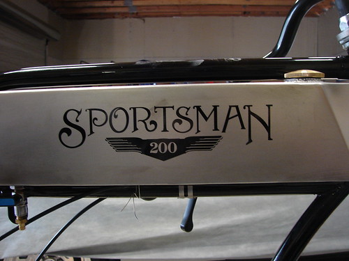

New gas tank logo. Hope the cops don't ask what the 200 stands for.

I need to get it outside for better pictures but here it is sitting in the shop. I did figure out the drop stand finally. It's just an off the shelf item then modified somewhat to make the legs longer.

Nice. Are all your bottom looped bars the same length? I can't tell but it looks like your lower braze point is farther under the crank housing than your other bikes. Is this the deepest loop you've done for such a tall engine, or is it standard loop you've used on others?
itchybird
Nov 4, 2009
316
6
18
SF Bay Area.
All of Pat's stretch models use the same drop loop with the exception of my blue bike which was the first stretch model we built. That bike used a shallower loop. All of the later bikes use a similar frame geometry with mounts specific to the motor, be it Morini, Whizzer, or 200. The Morini's sit a little higher in the frame which is probably why they look a little different.
