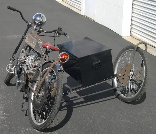

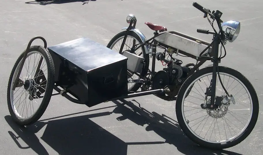

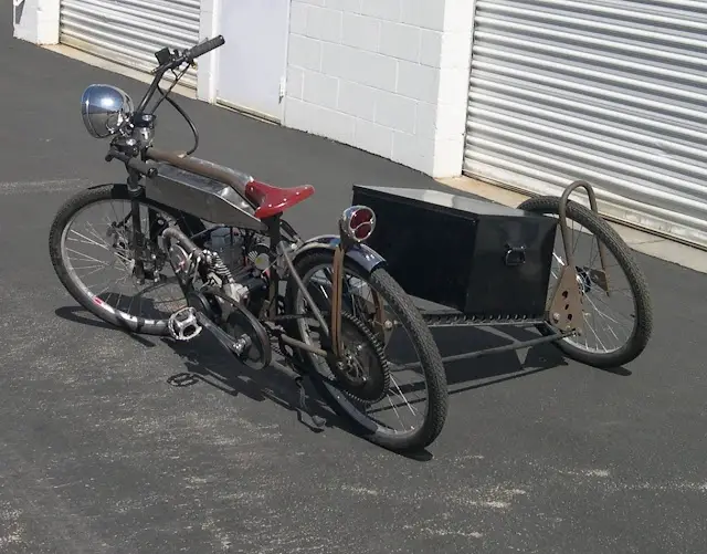

Finally remembered the camera while I was out with the sidehack yesterday
I decided to go with an old toolbox for a sidecar. Makes a hardware store run easier that way. Also provides secure helmet storage.
The repop tail light worked out well, and the brake light is bright enough in full sun:
Thanks!
There are still some little things to clean up, but I am happy with the electric start & 20 amp generator.
What a wonderful build. I like the idea of the generator and the electric star too. What is the generator from? A car it looks like?

The generator is also the starter motor. Old school starter/generator from a gas golf cart.

The design is mostly from memory. My dad had a flexi-car on his 1928 JD that I rode in as a kid.
