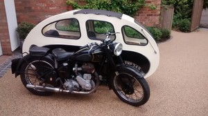

Not finished but operational and good enough for pictures.
Bike can lean seperate from sidecar for cornering.
Has a locking trunk , horn, spring seat and a brake.
It has a quick connect / disconnect setup.

Took it out for a 3 hr. ride yesterday. Really rode well. I did feel a bit uncomfortable being about 3 ft further into traffic. What a great reaction from the public. Thumbs up everywhere, even by people passing me.

Fantastic! How did it handle?

It handled very well. Of course I can only compare it to the first MB that I built. That was an electric with a rigid powered sidecar drive. That was a nightmare.
This one is stable and corners well. I have only carried an 80lb load in it but will up that too 100 lbs for the next extended run. Left turns are a breeze, right turns have to be taken wider but still good.
The sidecar has a brake but I don't think it is needed(unless a panic stop).
