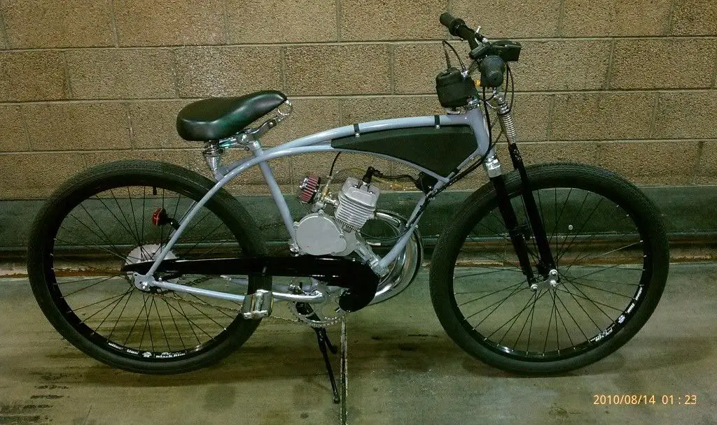

Okay so here is where i am at right now . I pressured checked the tank all welds were sound with no leaks . I painted the tank black i think it looks better, in the morning im going to paint the chain guard black .I hope to have this completed by Friday.

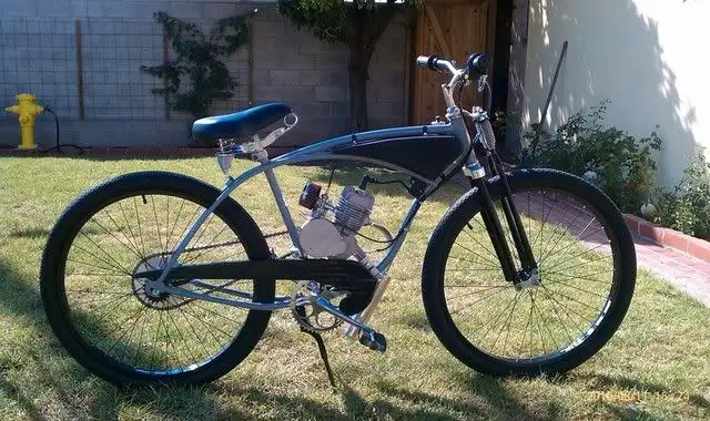

here is a update I got my fat cat exhaust and boy is it loud .Im going to make a muffler for it to quite it down a bit . Bike seems to be running good i have about 14 miles on it now slowly breaking it in when i have the time .
Looking good headtrama...
FYI, I have put a muffler on the end and it killed the performance of the pipe BIG TIME! I do not like them because they are loud but man do they make a difference. Every bike we have put that pipe always has a 3-5mph increase.

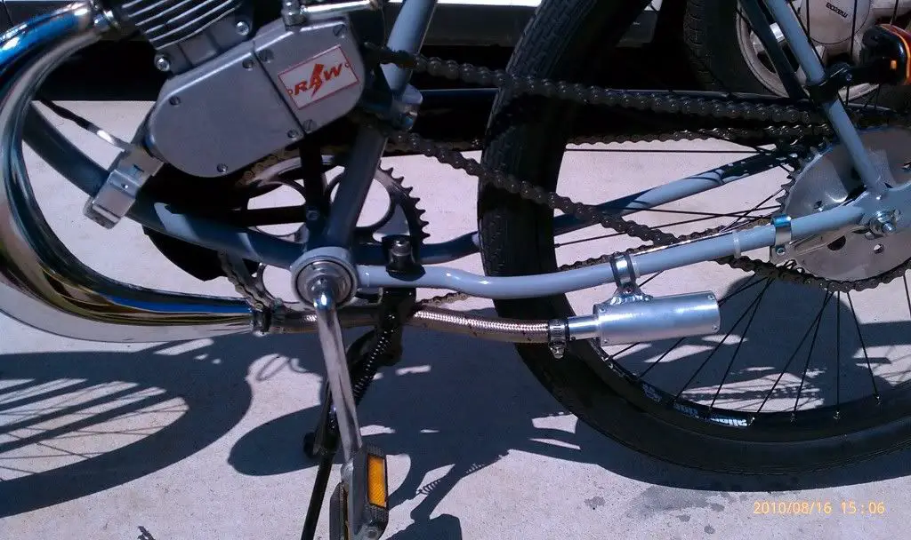

Ill vouch for the load part of that pipe lol . I made a silencer for the pipe but mounted it further back on the frame behind the crank. I can still feel a performance gain with it and it sounds a lot better. My friend has the same motor in his bike and he says mine feels like it has more power.Here is a picture of what i did it's mounted with just a hose right now but ill be bending a piece of pipe for it soon .
Yeah let me add that even with the muffler it is way better then the stock one. I was referring to getting everything out of the motor. We spent months trying different things for Death Race. Awesome for the street but not so good with muffler for DR.
