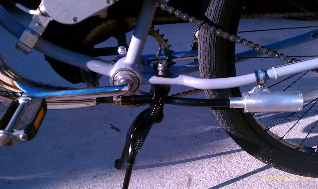

Just thought I would share a picture of mu finished pipe . I am happy with the way it turned out and how it sounds .
Just a little update I have just a little over 60 trouble free miles on my bike and must say it seems to run better and better . I am waiting on my new front hub so i can put a front brake on hopefully ill have it on by the middle of next week .
The muffler i made out of some scrap aluminum i had . I turned to end caps and slid a tube in between them and packed it with muffler packing. It definitely made it a lot quieter .
