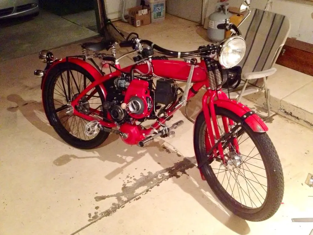

Thanks Scott. The adaptor plates that I made for both the exhaust and the intake were simple plates with holes drilled and then enlarged to match the port profile. The gaskets were cut to match the port as close as possible. I've tried to smooth them out as much as possible. The questionable choices would be the exhaust and the fairly sharp bend into the pipe, and the plenum intake I am using with the two stroker carb. The engine is running really rich right now and makes a lot of smoke as I let off the throttle and roll to a stop. I also put a little slack in the rear chain and that seemed to help a little. It pulls pretty nice up a modest hill (good thing, still no pedals) after today's tweaks.
Alternator doesn't seem to be charging the battery correctly so I need to sort that out. If its the schematic then I'll be sure to post a correction.

Current sprocket setup is (10/30)x(10/44)=1/13.2 and seems to pull nice. I'll still need to swap out the jet in the carb and I have a half link on order to get the chain slack taken up.

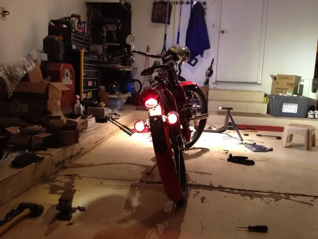

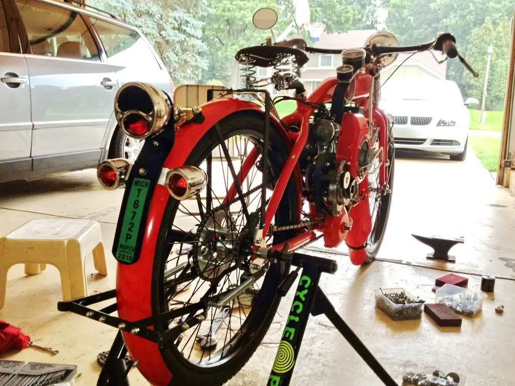

Found at least one issue with my wiring. I had the tail lights on the wrong side of the power switch so they were always on and draining the battery. I've put the rear running lights on and plan to have the tail light and running lights run through a current regulator. The brake light will bypass the regulator so that when it comes on it's nice and bright.

Wound up making an idler out of a couple 3/4" bushings and a 13t sprocket that was leftover from the jack shaft. It seems to be taking up the slack just fine. Also wired in the current regulator but only to the rear bullet lights. They are still pretty bright but I'm OK with that. The battery seems to charge just fine as long as I'm riding around 20mph+. If I have problems maintaining a charge I might need to get a larger drive pulley. I have also gotten a bit impatient with a solution for the cranks for my Dana and with the weather getting colder I want to ride! Temporary solution is BMX pegs as footpegs. Maybe I'll actually get to ride to work next week. So far it's just been longer and longer rides around home.

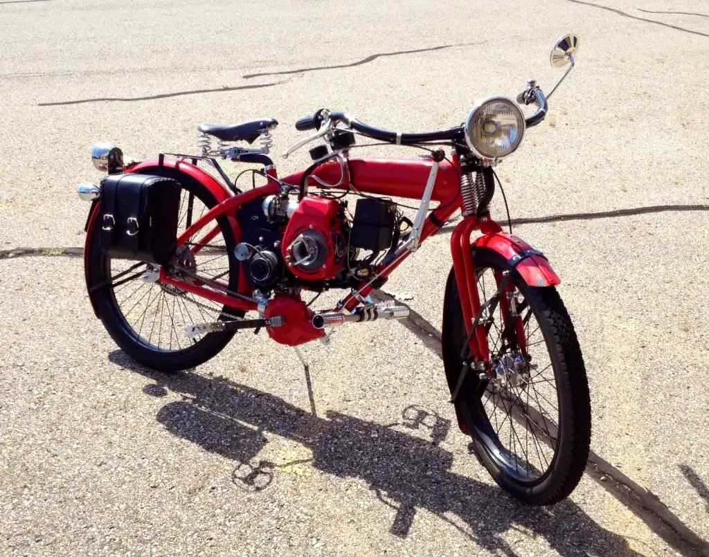

Finally, a picture in the office parking lot instead of my garage. Totally enjoyed my ride in today!

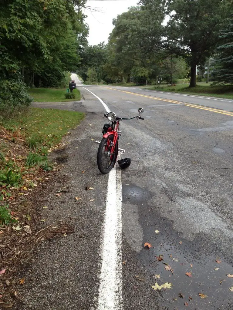

Thanks SB. Today's ride in to work was not so stellar. The cotter pin holding in the D-pin of the half link in my drive chain between the clutch and the 30t sprocket dropped out or sheared off. D-pin fell out and is gone too. Fortunately my associate drives a big pickup and we could just hoist it into the bed. At least I now have a nice picture of my bike along the road....

Congrats on your approving audience!
Ahhhh.... Working out the bugs. Little annoyances to expect along the ride.
Nice photo! You have wonderful roads to ride over there.
Perhaps have the D pin of the new 1/2 link tack welded in place?
