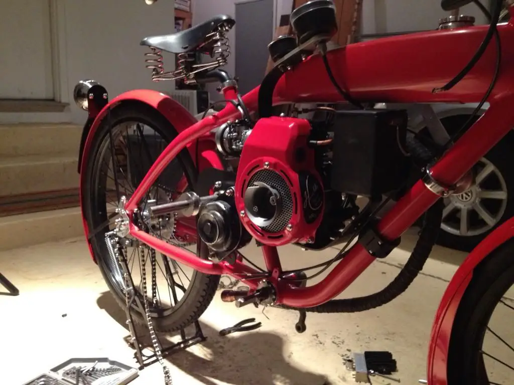

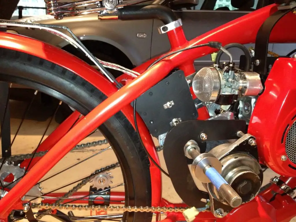

Made a bracket for the alternator and have the pulleys pretty well aligned. I'll need to order a really short belt and then cut the jack shaft to length. Maybe a belt guard, maybe not.

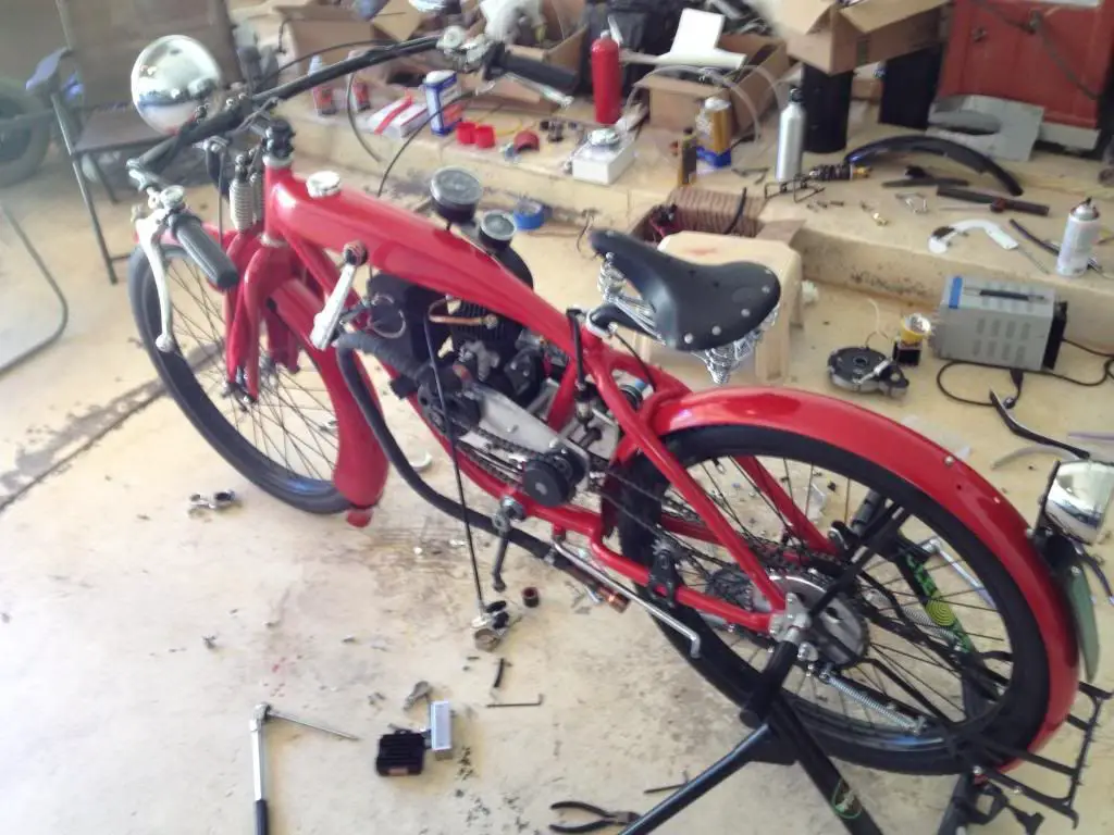

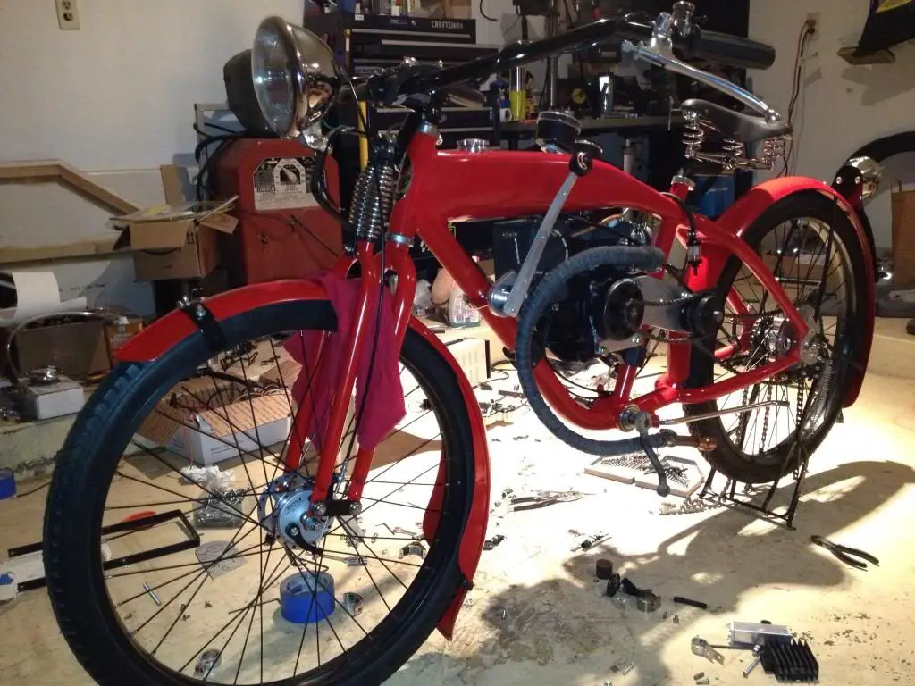

Thanks again sb. Still haven't done anything about that travesty of a garage. At least my wife's side is clean and she can park inside! Aligned the rear wheel and put the chains on. Should have the transmission on and the front fender secured in a day or so. Perhaps I'll get a chance to fire the engine this weekend (and then clean garage).

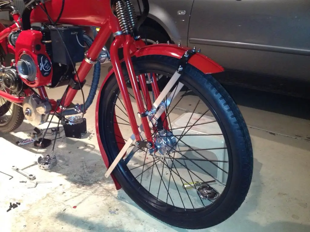

More modest progress. Getting the fender braces and brackets installed.

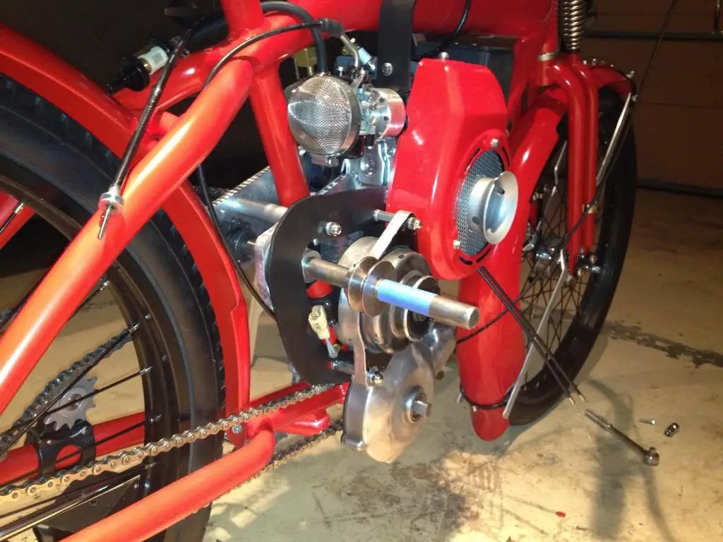

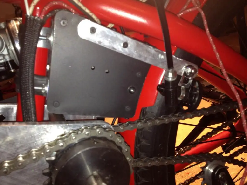

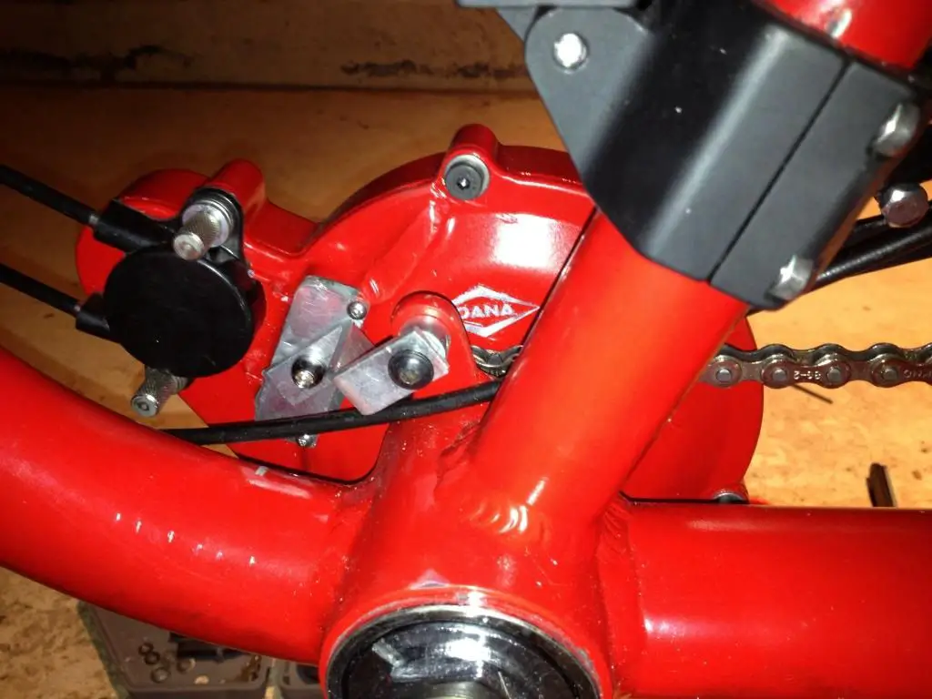

Also have the Dana modified and brackets made. Nothing super beefy just enough to keep it from rotating. Next is to paint it and bend the other crank.

Thanks truckd. Another day of tinkering (along with getting a few things done around the house). The Dana is painted and installed. The shifter needs a little work though.

Well SB, I feel like I should send you a hat so that you can keep it on your head. Either that or I need to work harder because I feel like I've let you down! A few posts back I mentioned that I would be putting the Dana on the pedal drive but it's kind of buried with some other comments. My concern at the time was running out of gas or any other failure that would require me to pedal a fair distance. I think Scotto had posted something about that happening to him. Considering the bike will be over 100lbs I think gears are in order.
I had reconsidered over the winter and did a few calculations for gearing. To use the Dana I would need to connect the output of the engine to what is normally the output spline of the Dana. The Dana bottom bracket spindle would need to drive the back wheel sprocket. All of this would be do-able if I could weld #41 chain sprockets onto the Dana spindles but that is not in my skill set. I had purchased a couple of junker mountain bikes to salvage the bottom brackets as well as buying some sprockets but quickly reached my limit.
I bought the Dana used on eBay for $100. They still pop up now and then or you can post a wanted ad on RatRodBikes forum. People over here have them or are aware of them.

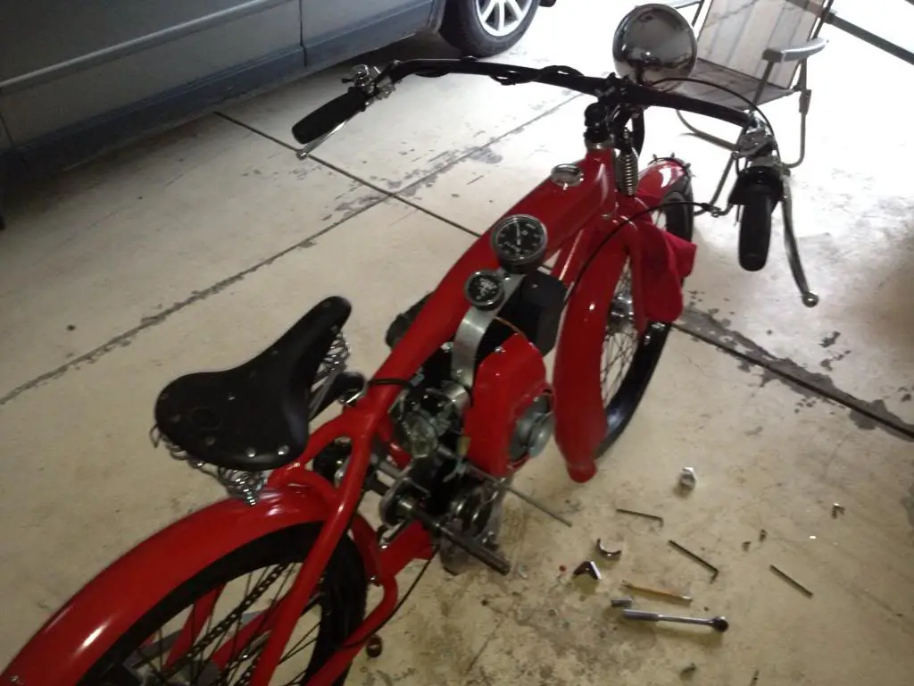

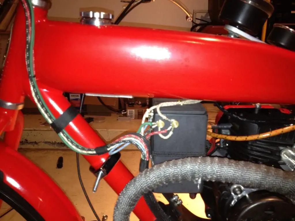

I am always amazed when I see posts where someone has scored a sweet bike and a few days later they have a really nice build completed. The last two days I've been in the garage for most of the day and into the evening and progress is difficult to see. I have been jumping around doing whatever interests me the most at the moment. I'm thinking "why not" since it all needs to get done. Finally started on the wiring though. Re-made my electrics box to fit above the jack shaft. I really appreciate the ones I see for sale at Phantom and Sportsman's. They are a bargain considering the time my cobble job took!

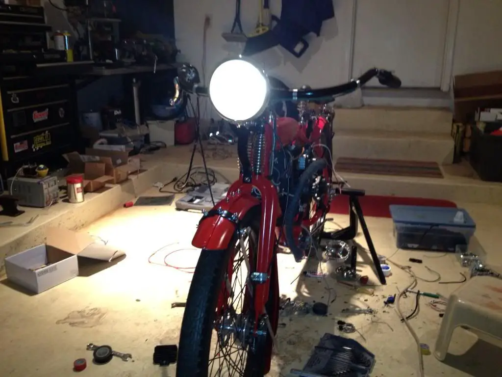

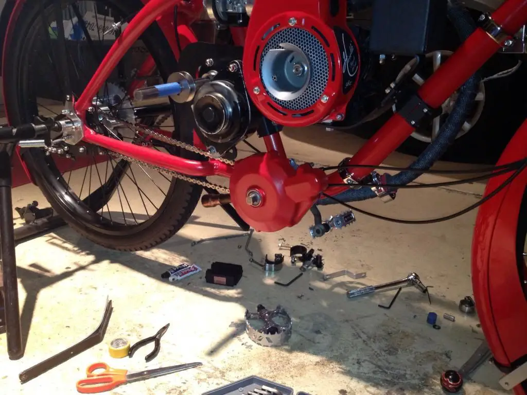

Getting there. Battery, on / off switch, buck / boost, hi / lo beam switch, and headlight are wired up and working right.
Removed the shifter to work on it but it was nice to have it out of the way while routing the harness.
Also mounted a bracket for the speedo drive on the back tire sidewall. Not crazy about the clearance to the chain so I might need to move it a bit.
