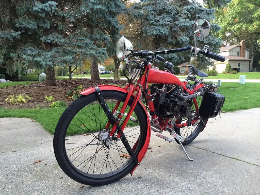

Looks like I'll have plenty of time to think about what's next. One last ride for the year when the temps were to be in the low 50's all day. The bike ran fine going in to work other than tossing another master link. Waves and smiles. A nice start to the day. The ride home, not so much. Checked the gas and oil before heading out then maybe two miles down the road the engine seized. She be dead. I'm much too busy to be messing with it for a while so it's going to just sit. The Zen rebuild continues just not right away.

Ouch man! That really sucks!
I wonder what went wrong with the Doodlebug. I am sorry to hear that it quit on you.
Is it a side valve or OHV?
Are you going to try and rebuild it or use a HF one?

It's a flathead. I'm not sure what I want to do next. I have been happy riding yet I have been conceptualizing a new bike. In other words the Felt may get a new engine or it might be a donor-cycle. Either way I am buried with work and need to stay on top of that before commiting hours to my hobby. Although at some point I will need garage time just to decompress. All work and no play (in this case) makes Harold a cranky old man.

If it had to happen then this is the best possible time for it, at the beginning of winter. I wonder what happened? I'd be tempted to buy another running Doodlebug and just plug it in, then do a rebuild of the dead one when you have the time, set it on the shelf when finished and have a back up engine. It is so easy to get bogged down in a bike make over as one thing leads to another. Might be better to simply start fresh on a second build and have a go at something different. This way you'd always have a back up bike and something for a friend to ride.
Just was realizing that when you do a build with an engine no longer being made and a little harder to find it is good to have a running spare. I have two Jacobsons for my "kindalikeawhizzer" build. Wish I had a spare for my Indian Hiawatha tri-car (antique 98cc Fichel & Sachs) as it takes forever for a part to get shipped from Germany if the part can even be found. The engine was made in 1934. My old Elgin is almost as bad with a Villiars midget engine. I've watched for one on ebay and they are not to be found. And again, shipping from England is not cheap even when you can find a part.
If you use an antique motor it is better to have it be American to make it easier to keep it running or find a spare.
It is a disappointment, I know, but you'll make things right.

As always, thanks Gents. I had envisioned keeping this bike as a spare and taking my time on a new build so perhaps keeping an eye out for another DB engine will be my path. It will be an opportunity to make a couple of improvements without it becoming a major rebuild. It is a little disheartening but in the scheme of things no big deal. Certainly a DB is relatively easy to find! I'll wait until I find another one for cheap though (only paid $35 or so for this one).
I have started the next bike if only in my head and on my computer. I'm in no rush.

I have been super buried at work in the past year. No complaints just saying I'm not spending as much time in the garage as I'd like. Too bad because tinkering is great stress buster for me. Anyway, finally had a few minutes to kill today and disassembled the dead Doodlebug. It's been a while since I've torn down one of these little engines and I've forgotten how much oil can hide in every nook and cranny. Just when I thought it was empty, nope. Cause of death seems to have been a spun rod bushing (or bushing surface since there's nothing there but some messy aluminum).
Oil was pretty black despite not having many miles on it. Could have been over heated, not sure. This gives me something to think about over the winter while I plan either a rebuild or new build with scavenged parts from this bike.
