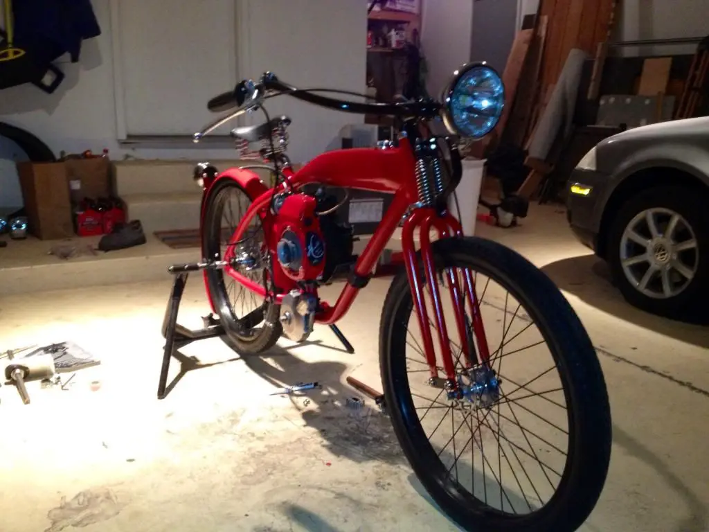

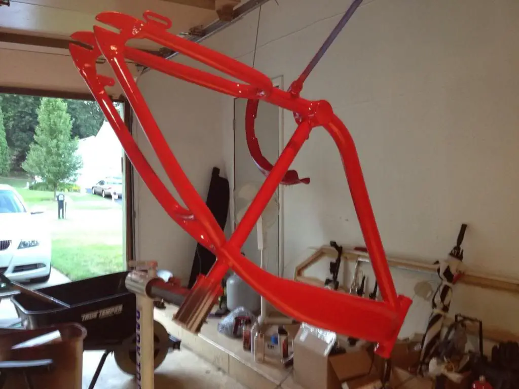

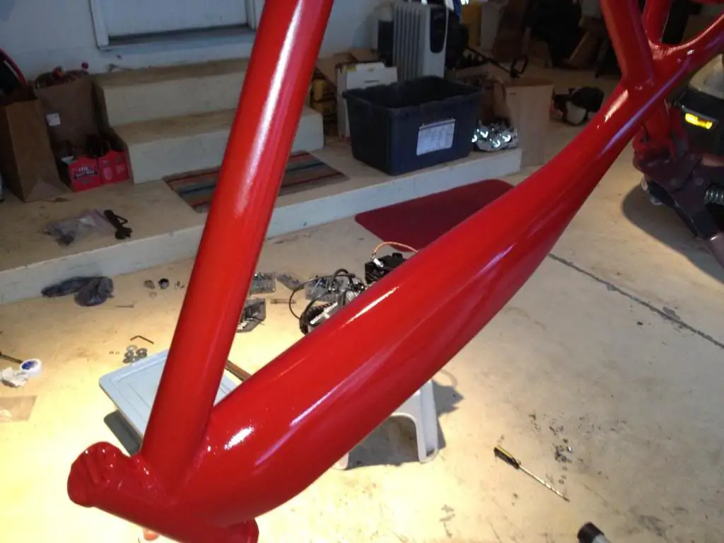

Coats two and three went on the frame.
I've read on the forum where quite a few people dislike the Rustoleum paints because they tend to crinkle on finish coats. So far so good on this frame. One thing I've found to help a bit is to give the paint a light dusting with a 0000 steel wool pad. It removes the sticky surface layer and any rough texture and the next coats seem to go on pretty smooth. Not perfect but not horrible. Not done either.

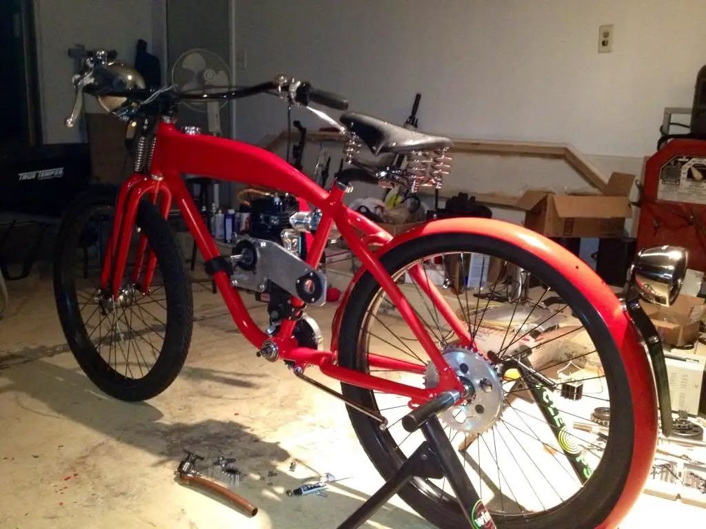

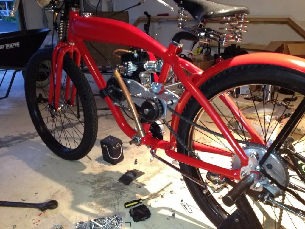

A rub down with 0000 steel wool and then a buff with a soft pad the frame looks dandy to me. It will harden over the next week or so which will give me plenty of opportunity to scratch the heck out of it! Started to bolt stuff up tonight.
