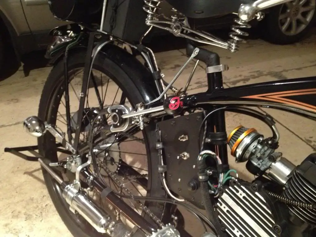

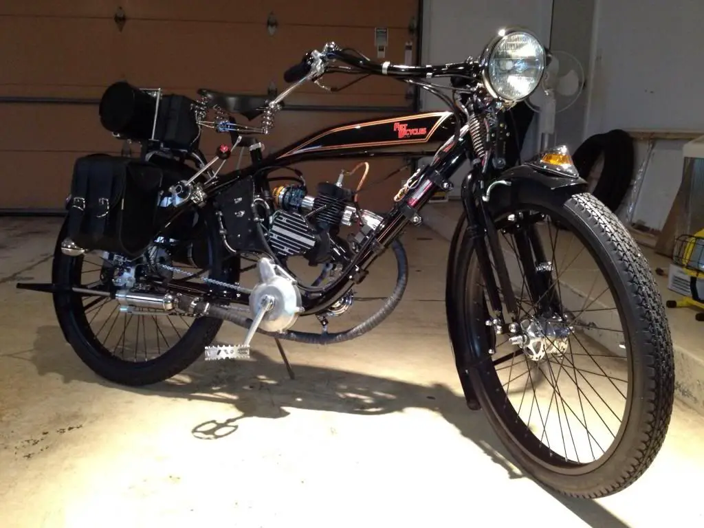

If I am seeing it correctly, you moved it to right where the rear fender meets up with the seat stay. That looks like a good alternative place to put the shifter. Can you still get full range of motion on it comfortably though?
Harold_B
May 23, 2012
997
246
43
Grand Rapids, MI
Seems to be better than the long shifter I had on there. The total travel is about 70 degrees and the photos show it in the forward position. It's close to parallel to the seatpost in the furthest back position. No need for a gate either as this doesn't flop around like the long one did. It's in about the same position as taking out my wallet so it won't be too awkward.

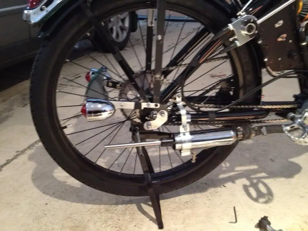

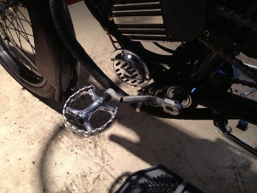

I made a lot of progress on the cranks as long as sitting and thinking about it can be considered work. While I was thinking about that I made some brackets for the Whizzer rear stand I bought. It is supposed to fit most cruisers but perhaps that meant cruisers with 24" wheels because the stand didn't clear the tire at the bottom of the sweep. I also didn't want it mounted to the axle so that should I get a flat I can change it while on the stand.

Crank is bent. I just need to weld, file and paint now.

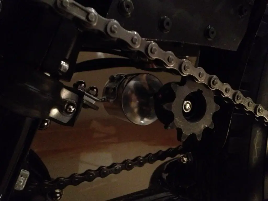

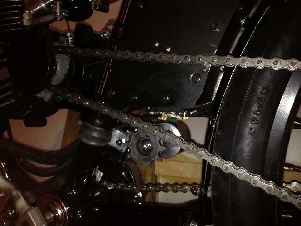

Put the generator in the engine chain loop. The Dana allowed me to have the right tension on the pedal and engine drive chains without tensioners on either chain so putting the generator in wasn't too bad. Plenty of room. Next to wire it up and test.

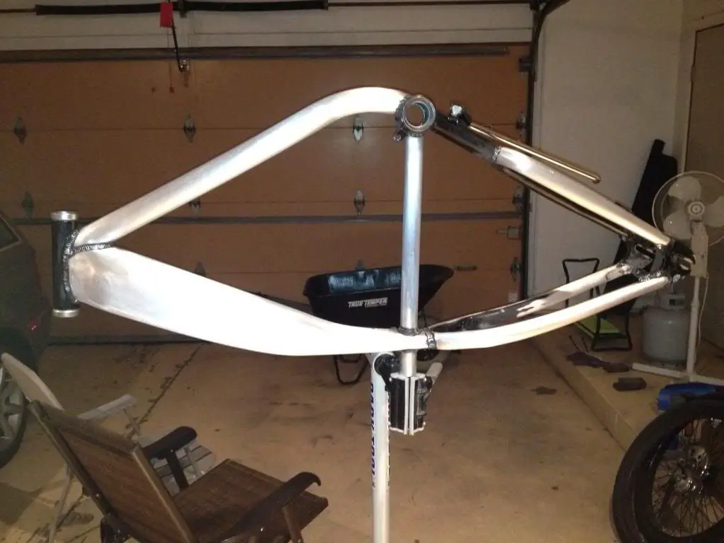

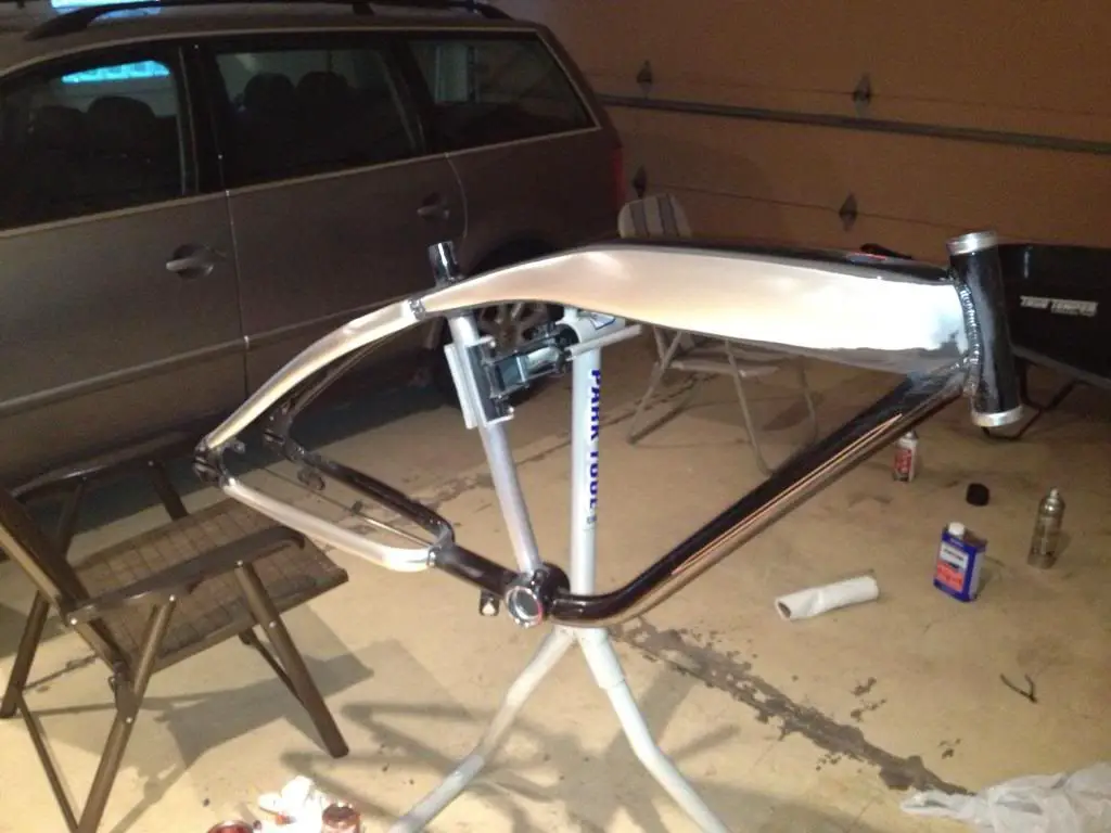

Ran out of propane halfway through the teardown. My hands still ache a bit. I think I'll get a refill before I spend more time in the garage! Took it down to the frame to seal the top tube for a tank (inspired by biknut's build thread).

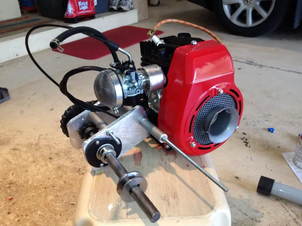

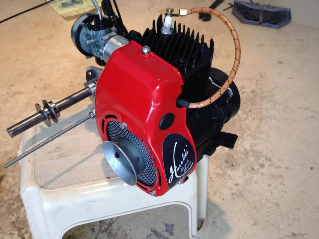

I've let this thread go cold but that doesn't mean I haven't been somewhat busy. After running into a few hard stops with the electrical system and the changes in the MI laws allowing up to 100cc's, plus all of the great projects I've read about here this became a total "do over".
First up, the 98cc Doodlebug engine I purchased on eBay. A few changes inspired by the "Vintigizing an Engine" thread by Velo. I'm taking a shot at making my own jack shaft assembly with accommodation for driving a Kaboda alternator. Also going to try using a two stroker carb ala Norm.
"Inspired by" also means I want it a little different than so I went more for the vintage KLM or a Briggs look with the pull starter cup.

Thanks SB. Also getting started on the frame and sealing the top tube for a tank. I used Dragon's Blood and what a mess! It looked like a murder scene in my garage. Pretty sure I have it sealed though.

Thanks truckd. Agreed, lots of depth here on the forum. I hope to tap into it some more when it comes time to wire up the Yamaha voltage regulator and battery. I made my own steel engine mount plate and have the regulator mounted on the bottom. A majority of the time so far has gone into making adapter or mounting plates or brackets of one kind or another. Now the tedious part of prepping everything and getting it all repainted.

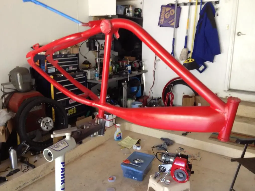

I'm about 1/3 through sanding the frame. There are a few fairly deep scratches in the black paint between the brackets from the previous build(s) and stone chips from my work commute so I'm taking down to the bare aluminum. I'll have Popeye's forearms bythe time I'm done.

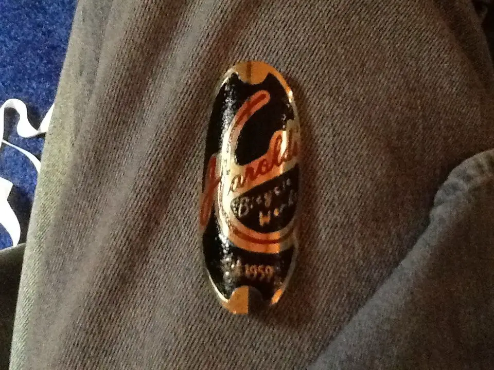

My plan is to keep the graphics simple. Pretty much just a lot of red, a little black, and whatever shiny metal looks appropriate. I did splurge on my ego and had a head tube badge made.

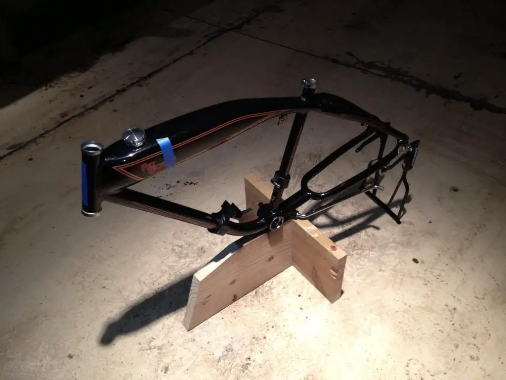

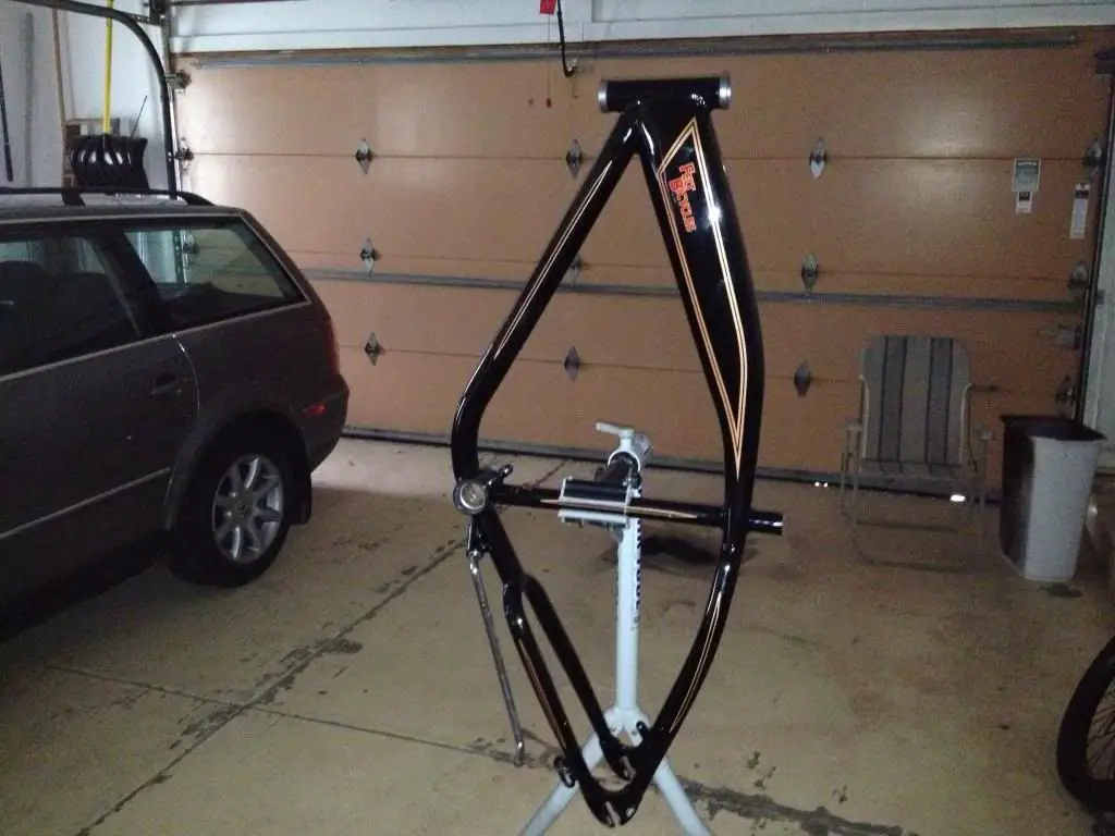

About a week of sanding. What I didn't inhale or wear into the house has been swept up. It did not come off easily.
Shot two coats of primer, sanded and then the first top coat. It will get two more coats and a sanding then a finish coat.

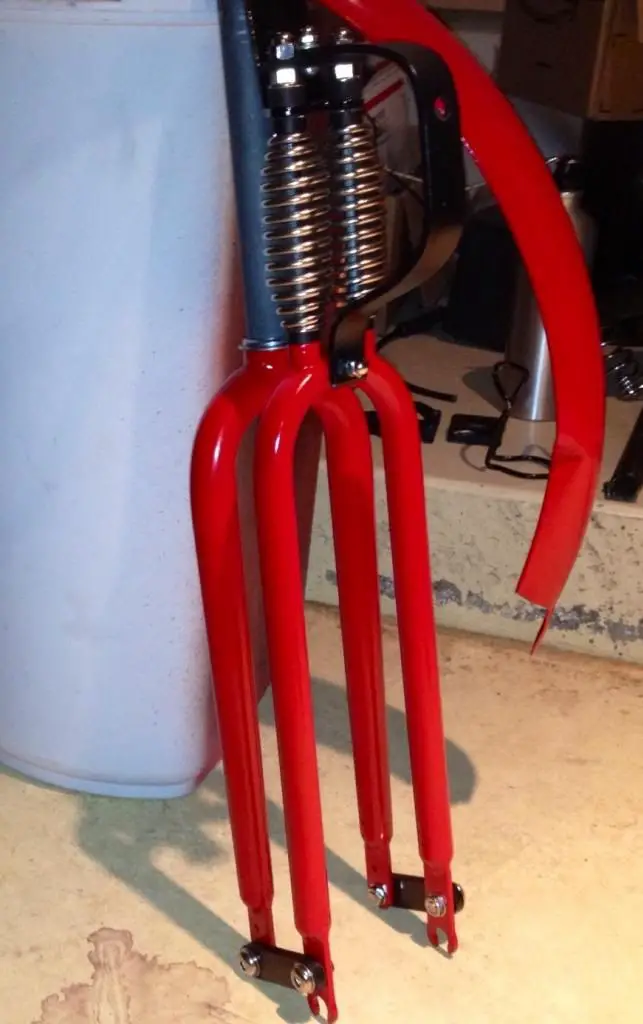

I disassembled the fork so I could paint the bits and pieces too for that factory look. I plan to make a shield for the clutch and paint it to match and I'll be painting the Dana 3-speed red too. Hopefully I have enough black and metal parts to balance it out.
After trying a bunch of different brands and having some difficulty matching color for the fenders and engine, then having compatibility issues (cracking), I've settled on Rustoleum automotive Red for the frame and fenders and Rustoleum Hightemp Red for the engine. I've been using Rustoleum automotive primer or self etching primer. It seems pretty robust after about a week.
