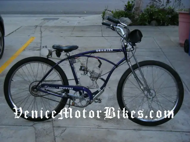

    My GF has a small rear cylinder tank on her bike... She just carries a extra quart of premixed gas in a leather handlebar tool bag.
    It's real easy to do & it looks good too. ;)
