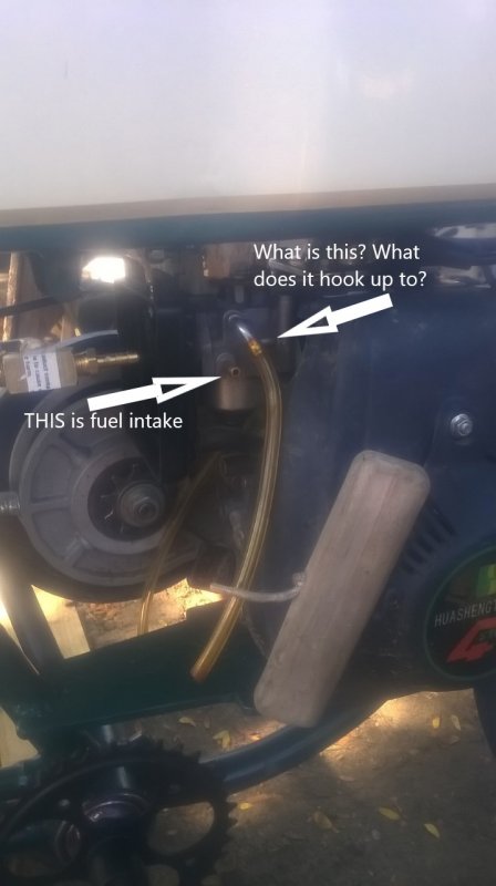

That looks like the bowl vent, since it is near the top above the needle and seat. If it is just let it hang down, on some carbs if you plug it the bowl won’t fill.

I am asking because my boy ran this motor when it was on another frame and it developed a vacuum leak or a clogged fuel situation afterwards that I cannot figure out- and I forgot how the tubes ran before.
