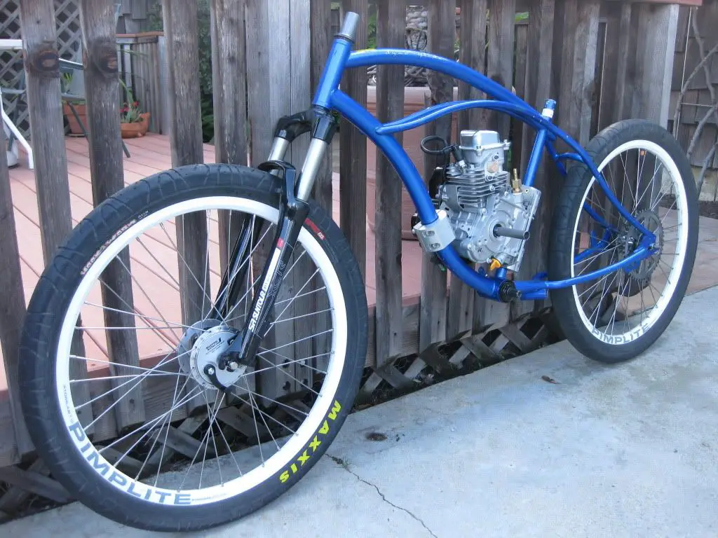

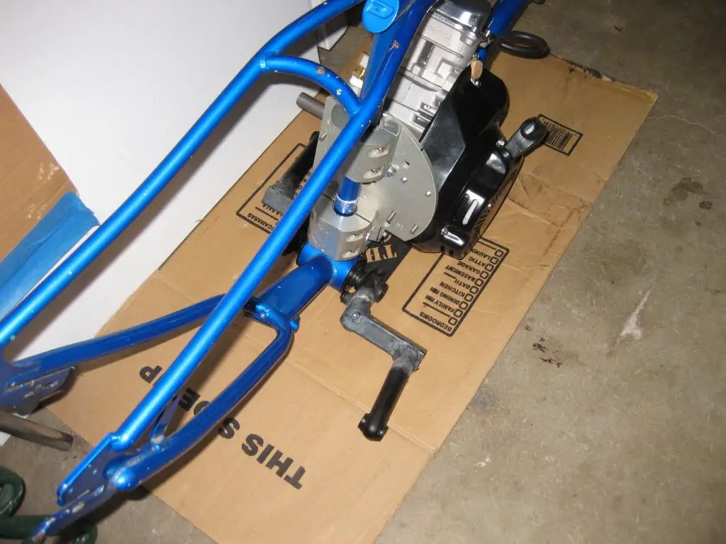

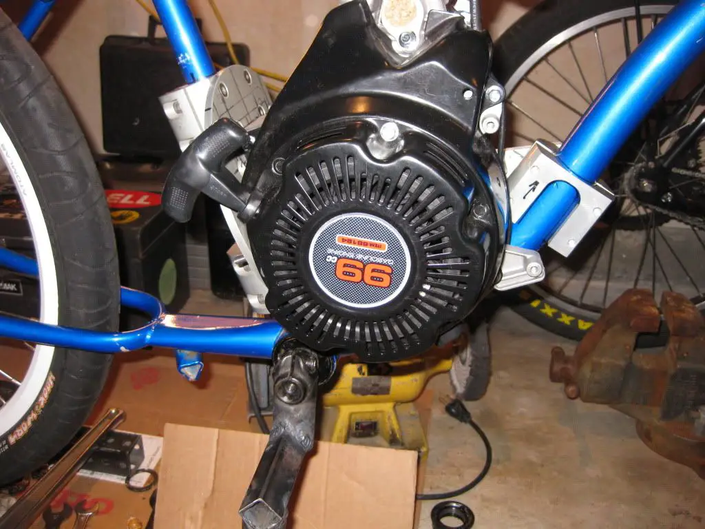

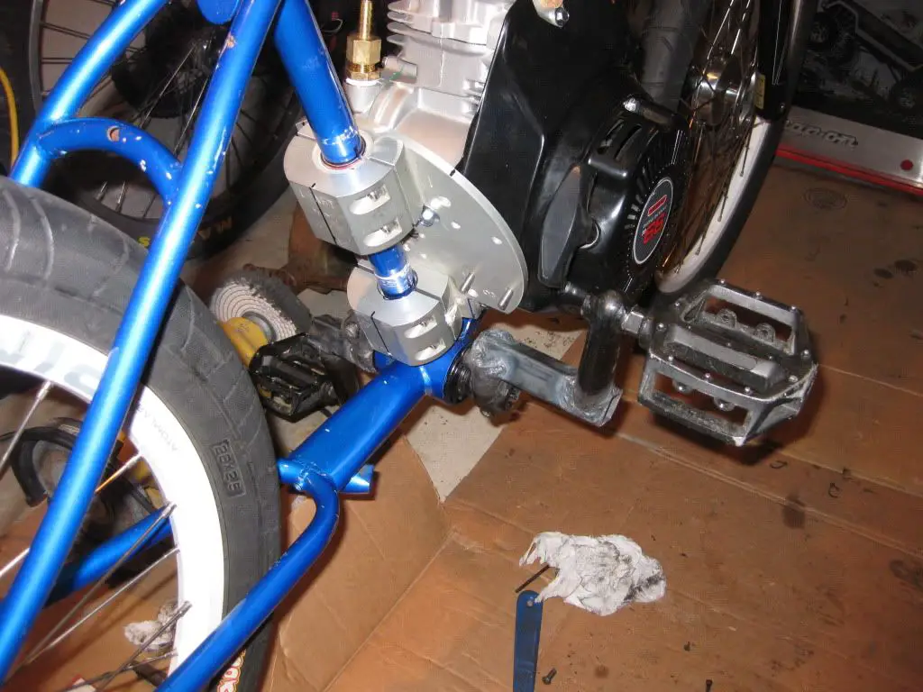

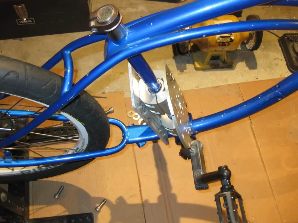

Here are a few pics from a few days ago......finished modifying the drive side pedal crank. They ain't pretty but they'll look ok when completely finished. They are very robust however.......

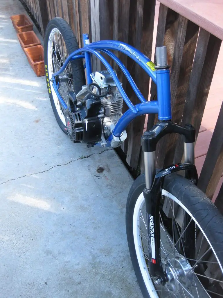

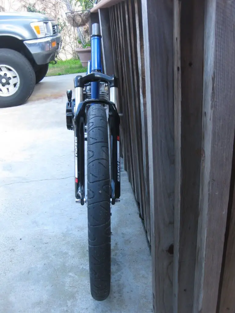

Oh......ok, it must be a Dyno-Glide then. I'll just say then that my Dyno doesn't accept a standard 1" or a standard 1-1/8" headset. So it's kind of hard for me to tell you what fork actually fits on this frame. I'm to believe it is an older cruiser type headset and fork that falls in the size right between 1" and 1-1/8" and that's all I got for you on that matter. I personally am installing an 1-1/8" threadless headset and a 1-1/8" Mtn.Bike suspension fork.

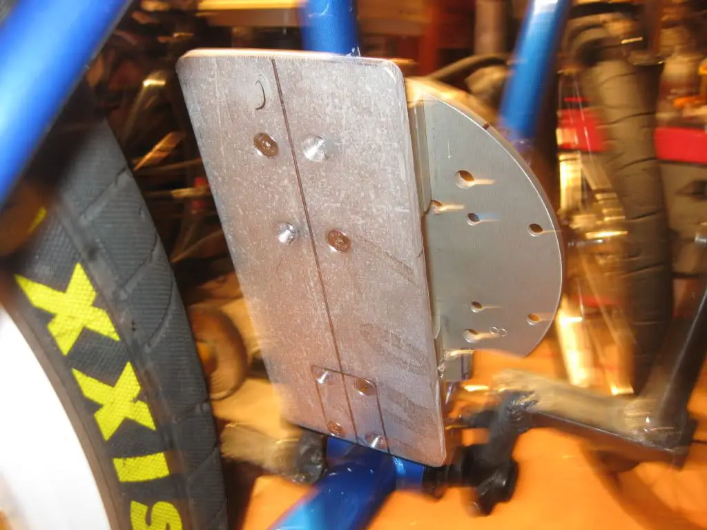

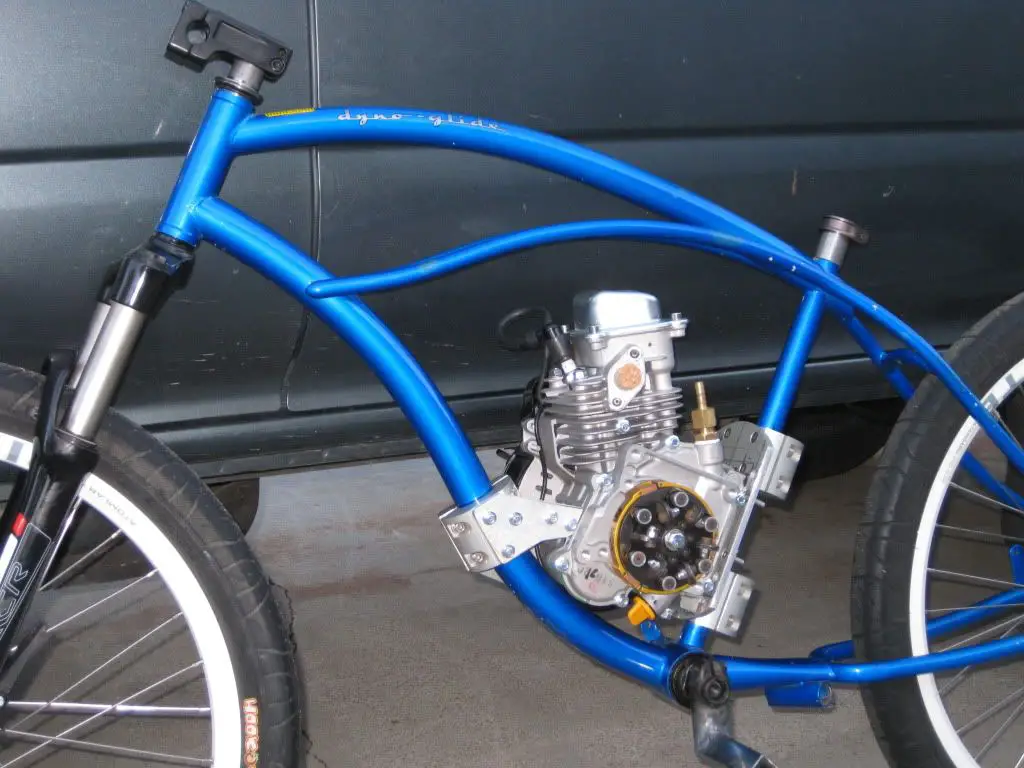

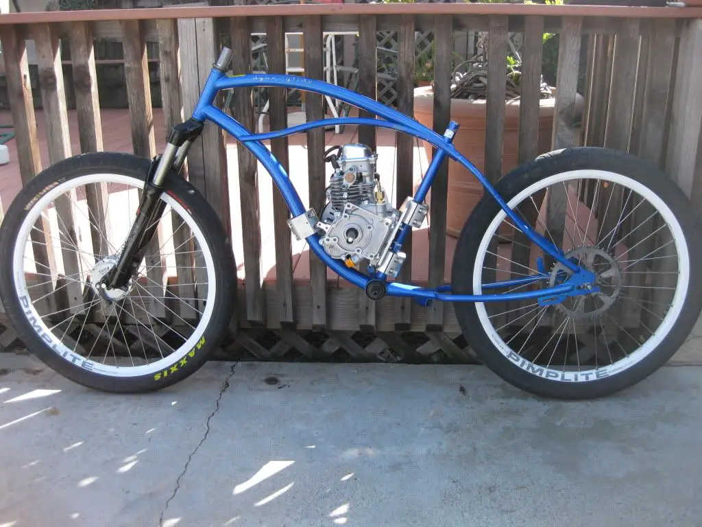

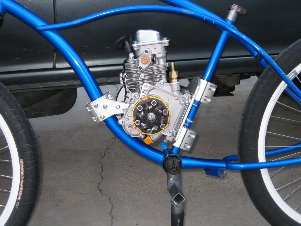

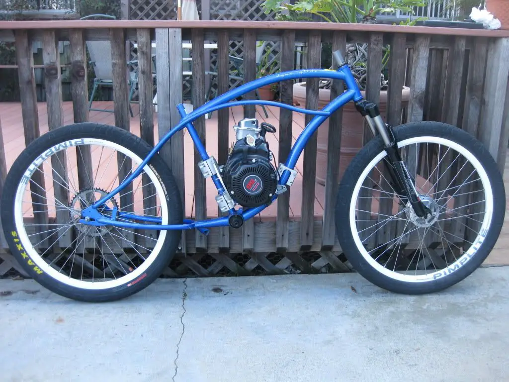

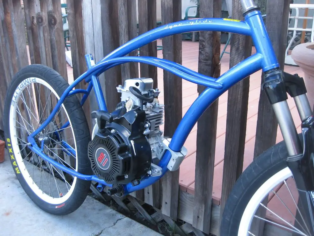

Back on track now.......and it didn't rain today (as was predicted) so I was able to get some work done on the build once again. Got some small things out of the way today as well as figuring out the chain lines for jack shaft placement with a semi mock-up. The bike is nearly a roller now but not quite yet......
for starters......

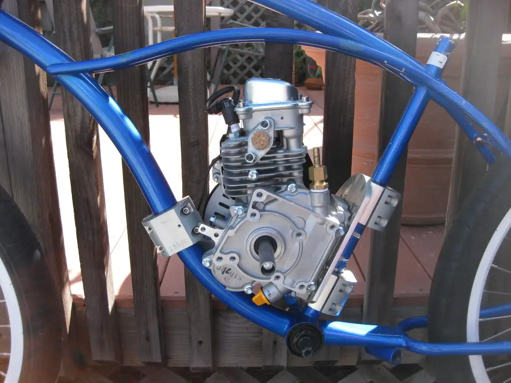

A few things I was tinkering on this evening.......

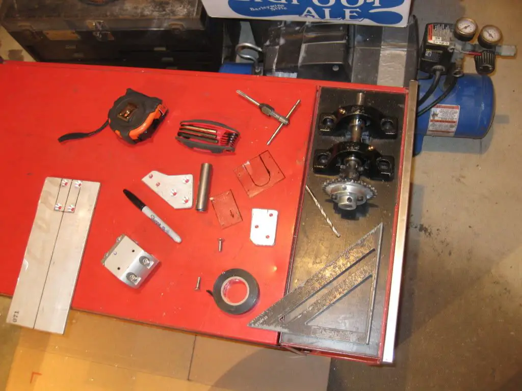

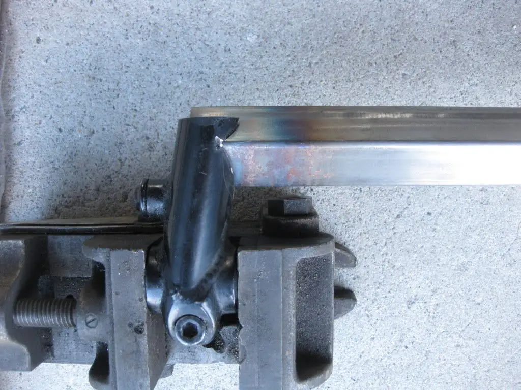

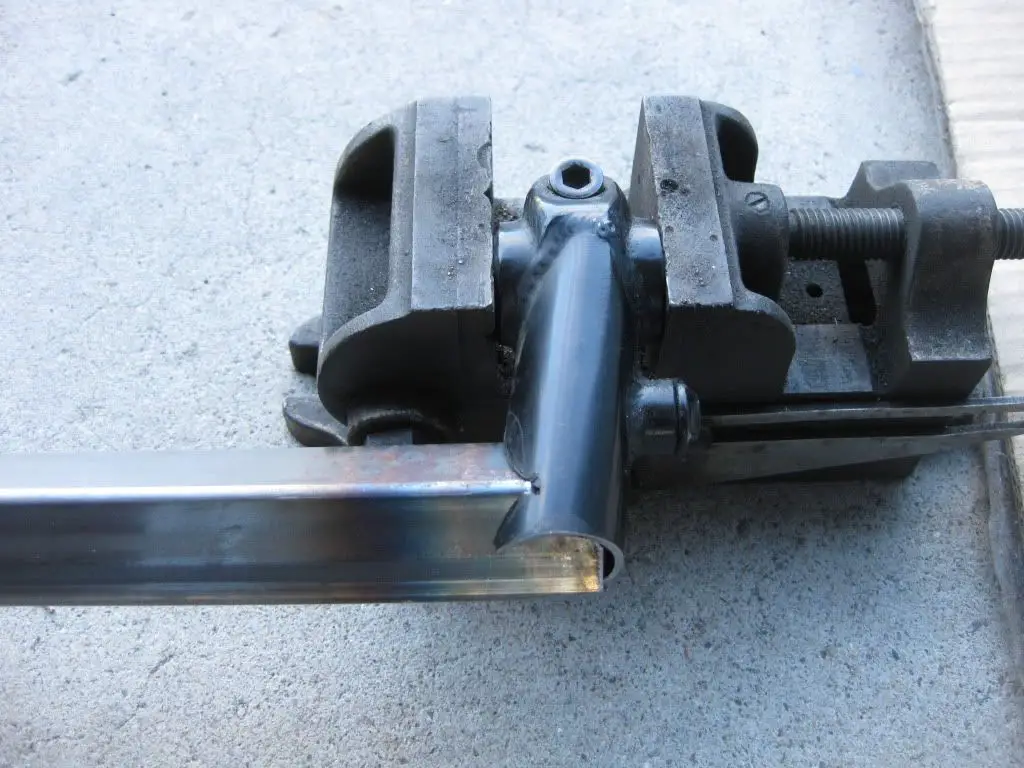

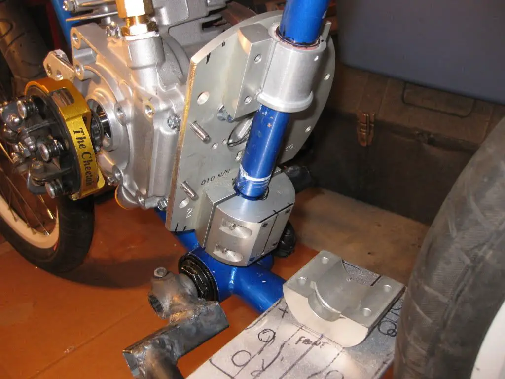

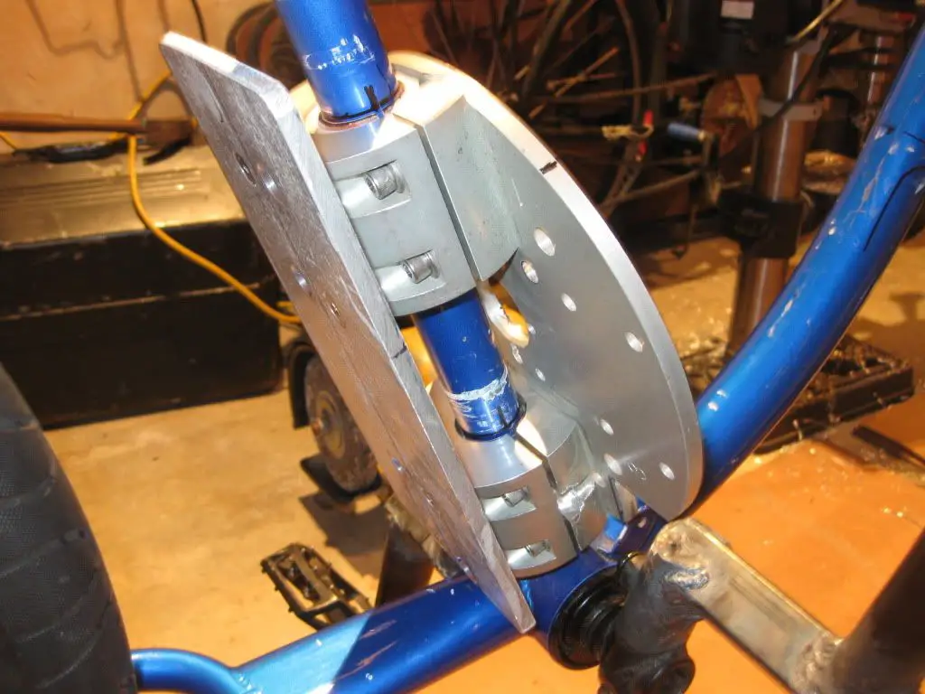

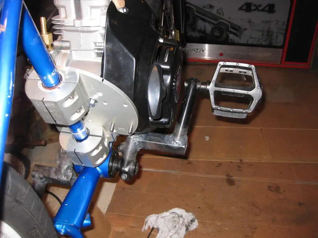

Did a bit of the fun stuff today........working on the jack shaft and the right front engine mount. Drilling and tapping, counter-sinking and grinding......why do I enjoy doing this so much?

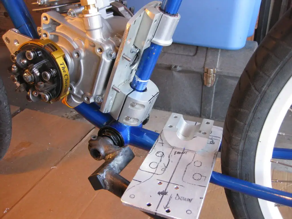

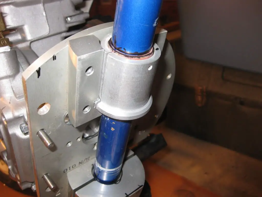

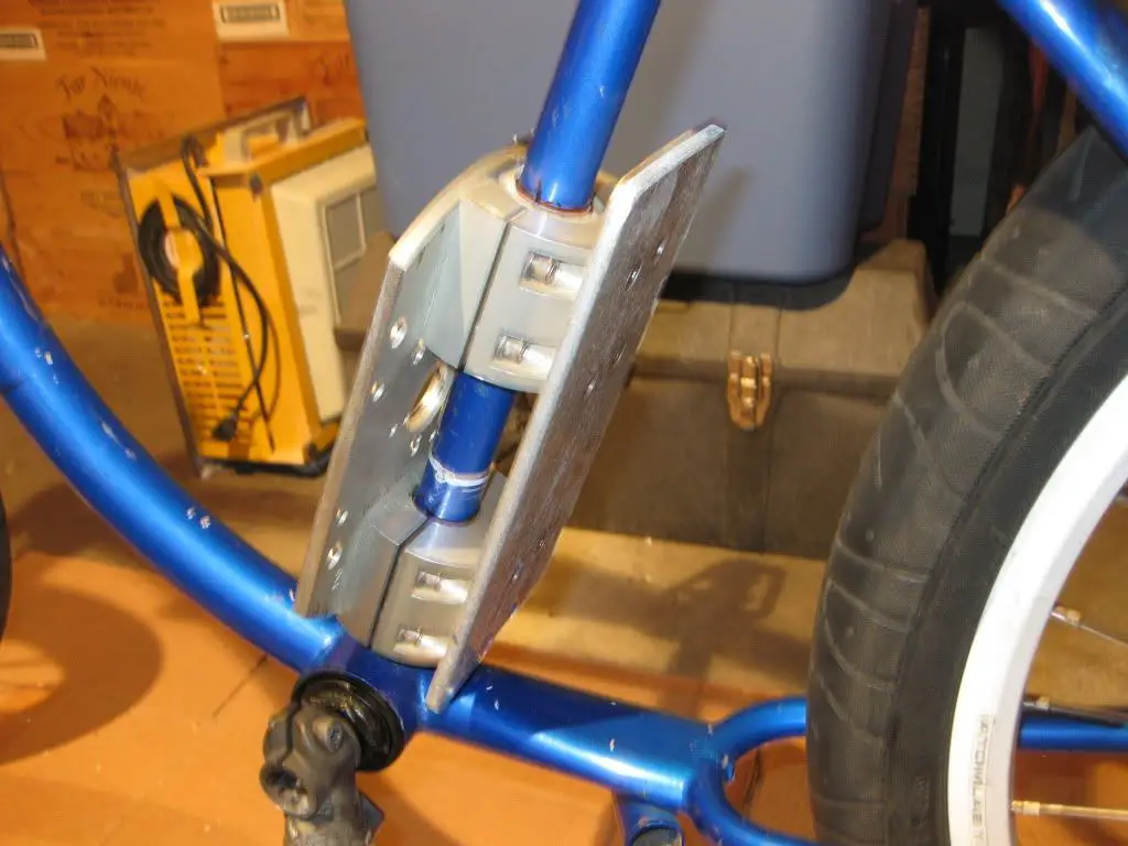

Here are a couple close-ups of the inside of the aerospace clamps...
There's the aluminum locking ring I was talking about...

thats ok bro, its got a motor. and i'm sure good brakes. wait a second whats that 3/4'' clutch doing on that motor? what's with you and jeff? brothers from a different mother? dennis
Ya got all that right Dennis......and I'm quite sure we're from different mothers lol.
In the meantime, here's the pic or two of the day.....

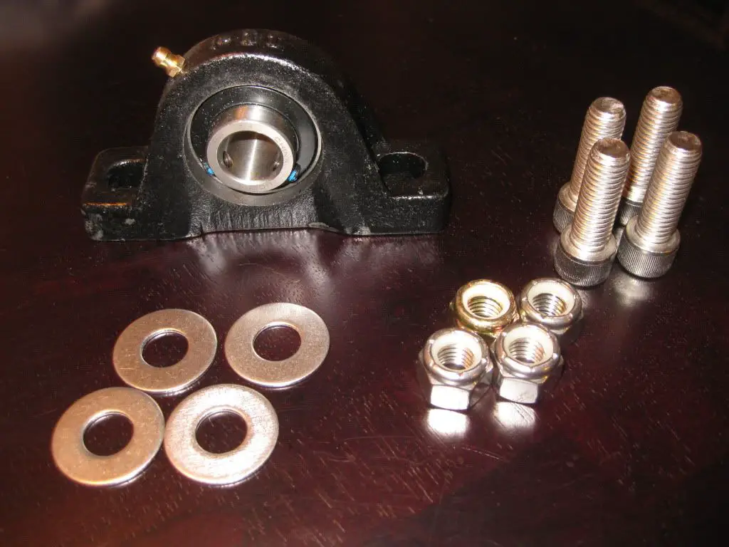

Looks like your making your own jackshaft using pillow blocks?
I'm stumped on we're you got that clutch, can't find it anywhere?
EDIT: after looking at photos and CulverCityClassics buile thread I figured what it was called. Ordered one and also a shaft adapter.
