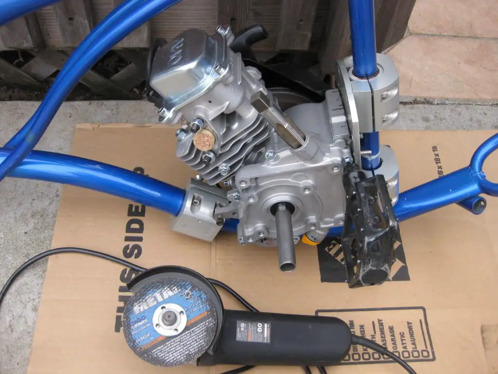

Hmmmm........ what's this, an oil cooler for the 99cc pred? Do I have a pump for that? So many questions, but how many answers? Don't ask me laff

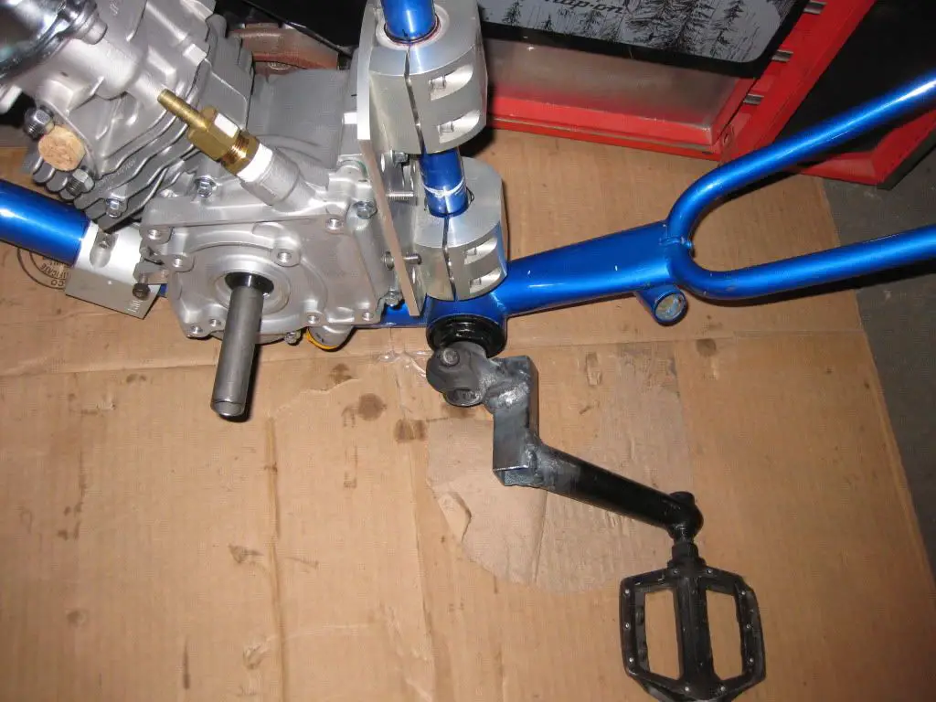

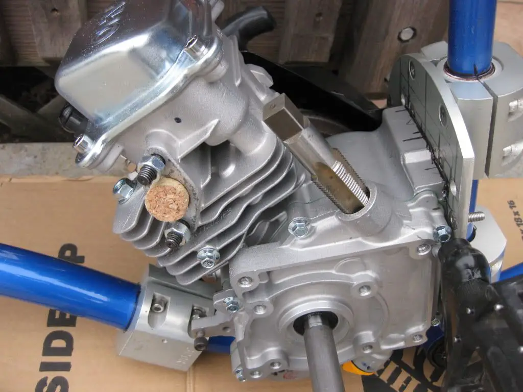

Got a bit done on the build today, finished modifying the left crank arm and got the oil filler hole drilled, tapped and plugged.

Are you gonna hafta mess with that whole vent looking arrangement every time you check or change the oil? Looks like a pita compared to what used to be there.
Interesting way to get the crank arm offset. You could get a couple of the plastic furniture caps to cover the end holes and store emergency hardware inside it.

what size tap is that?
Thanks all.......that is a 1/2" pipe thread tap.
Interesting solution for the peddle crank arms. How well do you think it will work doing it this way? Could you have also done it by cutting part way through then bend and weld the crank?
I know it will work very well, that's why I did it this way. You could use 1-1/8" x 3/16" flat stock for the same effect but the square tubing is stiffer and stronger.
And I wouldn't cut part way through and bend hollow chromoly cranks as you would never get the width you'ld need, it would shorten them alot and all the angles would be wrong.
This will make oil changes possible, it will actually be a breeze. I won't be checking the oil anyways, just changing it frequently.
And i'm debating on plugging the square tubing with caps or running them open.....we'll see ;)

Do you think this type of peddle crank mod could be done with standard one piece cranks or would just heating and bending be the better route?
Heating and bending the solid one piece cranks is just fine and that's what a lot of guys do. It does shorten them considerably though which can help with the width clearances also.
