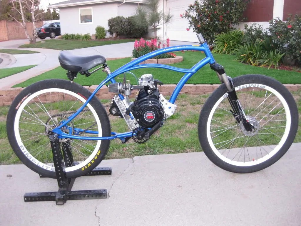

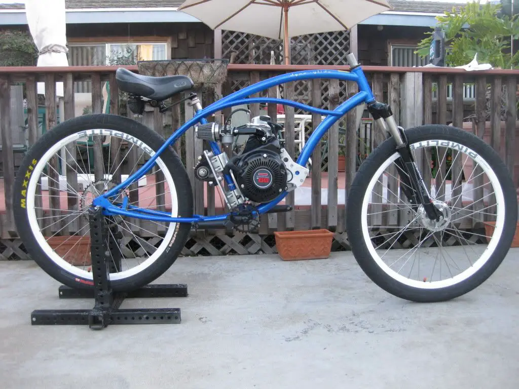

Predyno 99cc......the ultimate daily cruiser!

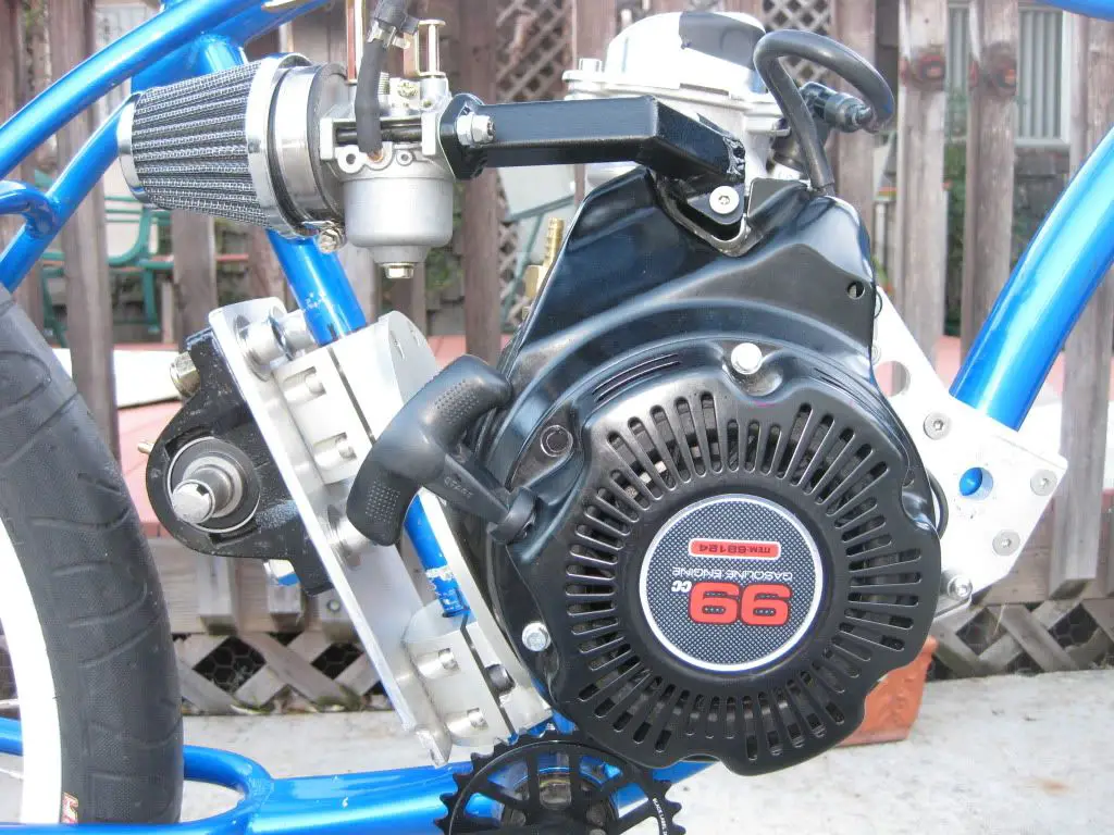

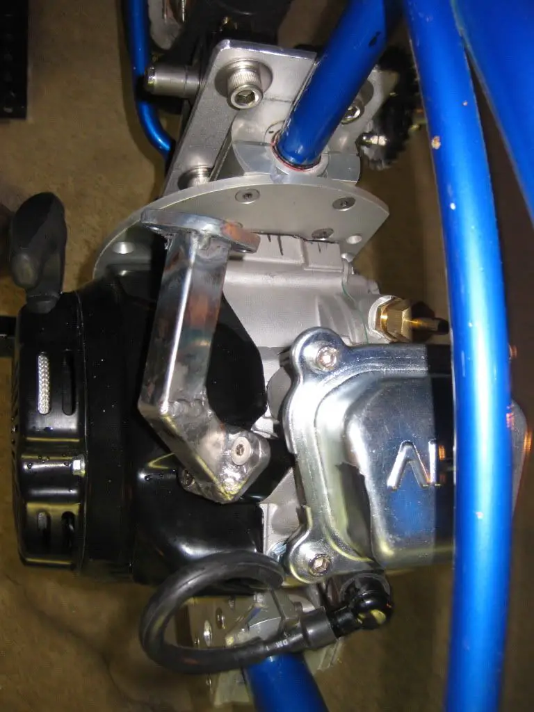

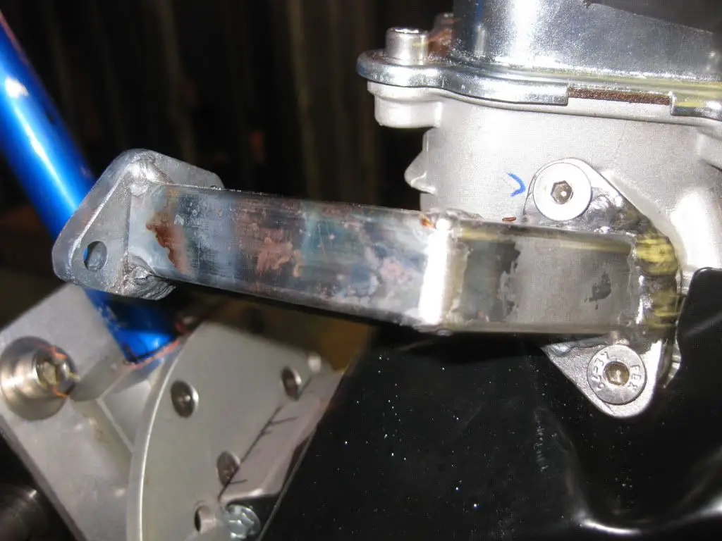

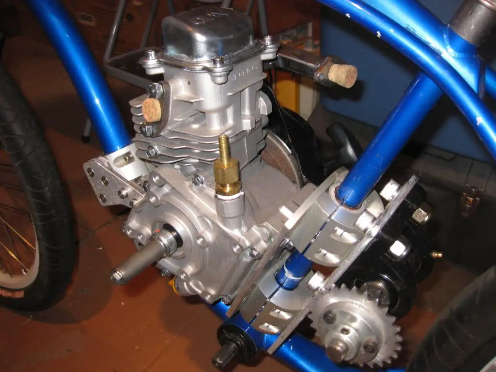

Nice motor mounts! Seem to making good progress.
I'm barely starting on the mounts tomm.

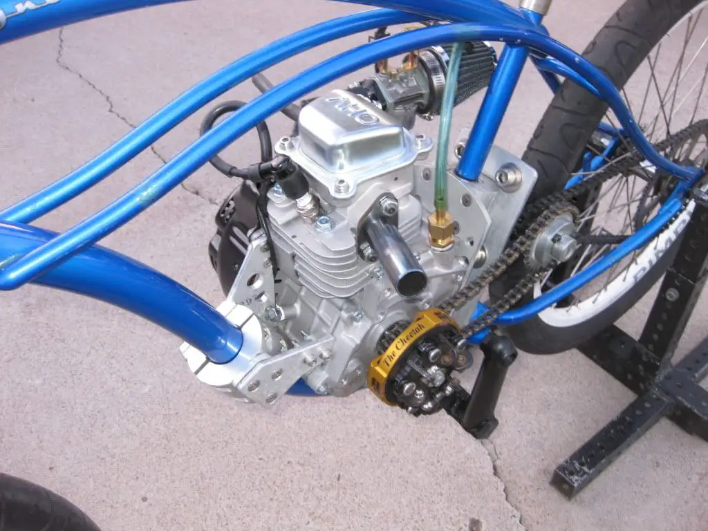

How did you adapt the cheetah clutch to the engine... Didn't like the bushing I bought
I sleeved the PTO shaft.

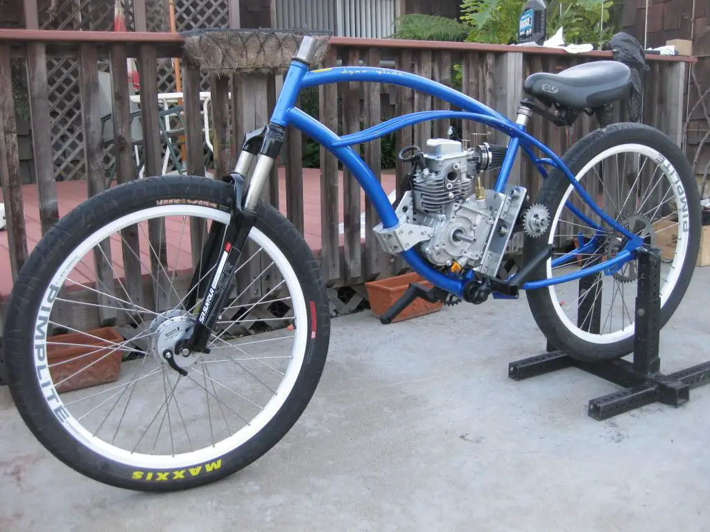

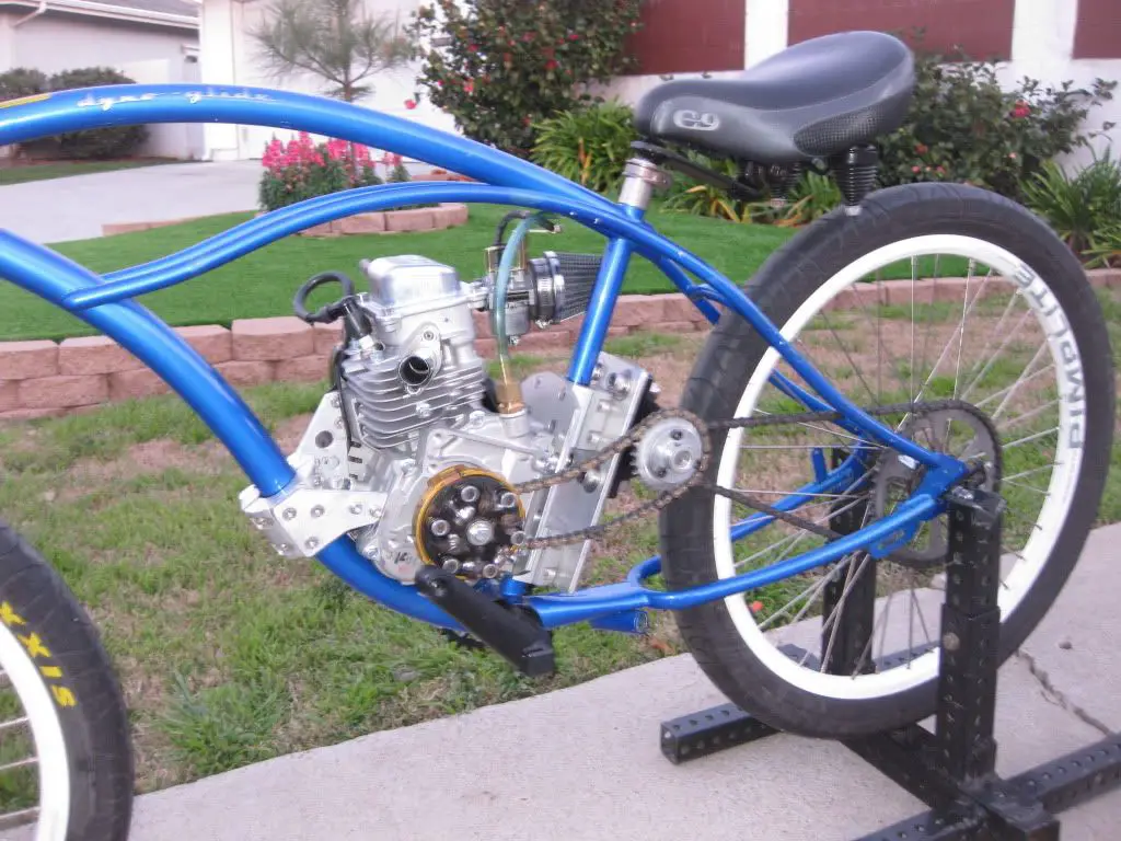

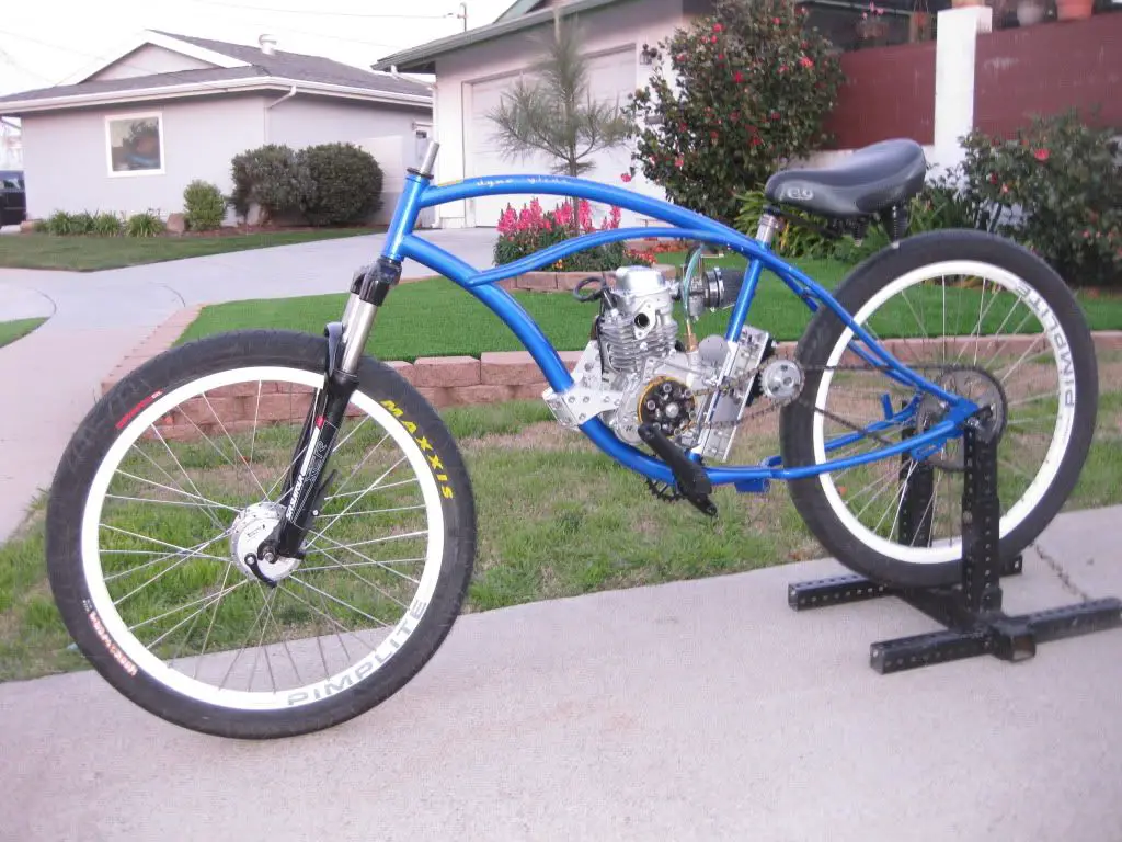

Had a good day today on the build and accomplished a fair bit completing the seat post, intake manifold and mounting the pedal chain ring.
This bike is my inspiration. I saw this thread and joined this forum and started my own build because of this bike. I am looking forward to the build being completed. Keep it up.
Wow gkcooper, welcome to the forum, inspiration is what makes these builds come to life......it's good to have you on board!
Here's today's pics.......
Cool... What did you use for the seat post (flat part)? I like the square tubing on the exhaust, or intake thingy.
The seat post is 3/16" steel plate and the square tubing is the intake manifold.

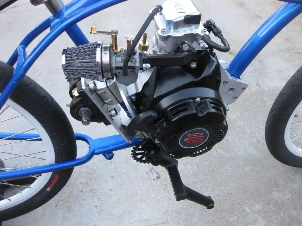

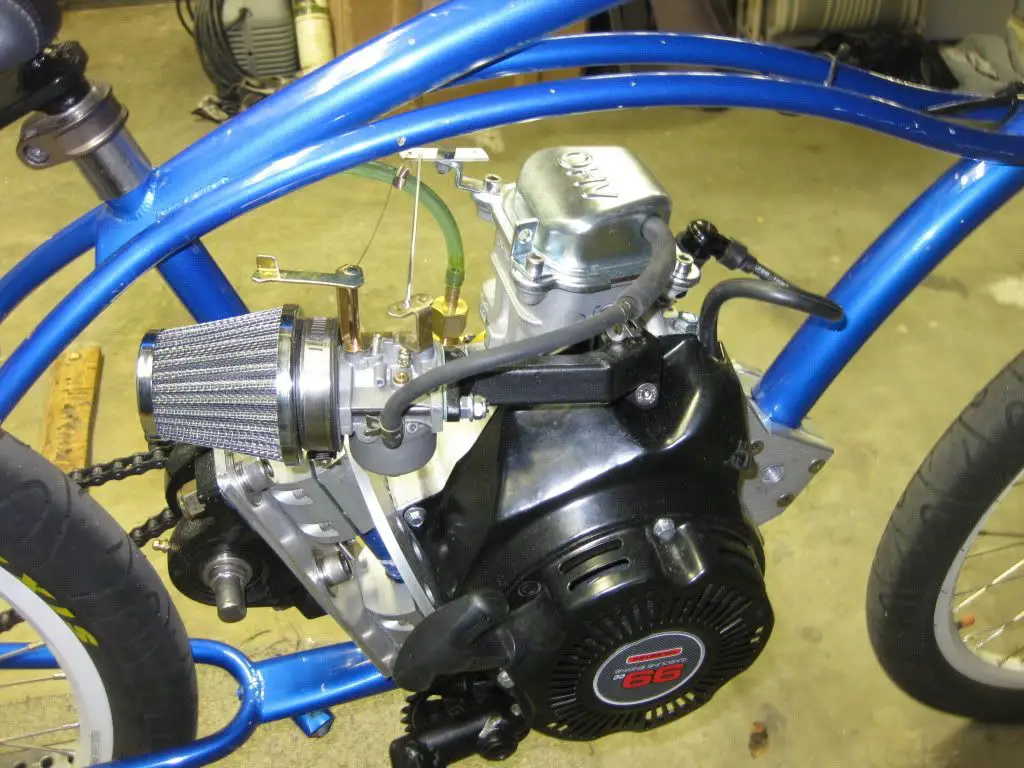

Bolted on a carb, cleaned out the crank case and filled with fresh oil and started the engine for the first time mounted on the bike. It fired right up.
Here's more pics and a short clip of the engine running.....

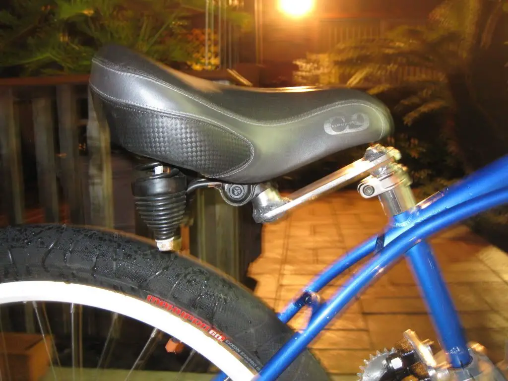

Got to love those Cloud 9 Seats
Ya just won't find a more comfy saddle than that particular Cloud 9 saddle......ya just won't.

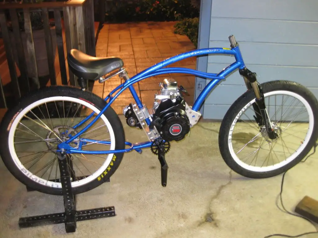

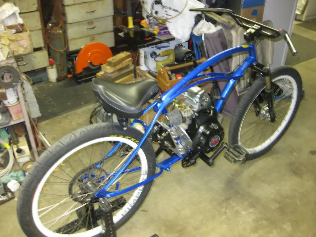

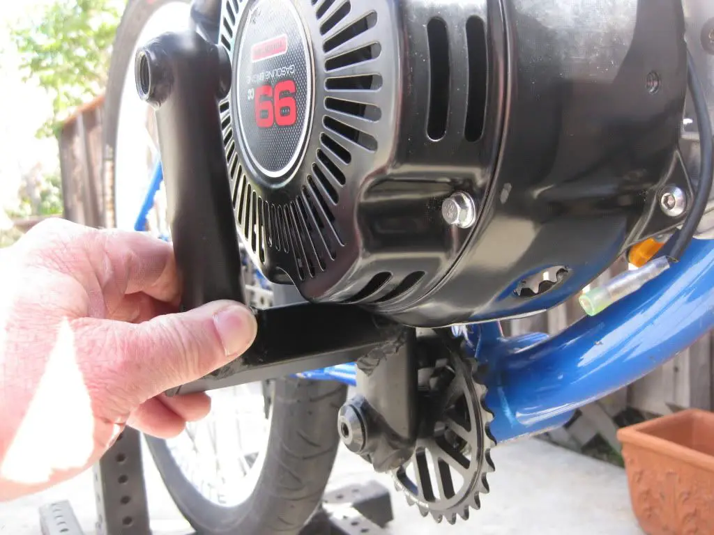

Got a lot done on the bike today, I even got to pedal it around and it pedals nicely. It is gettin heavier everyday.......gonna have to put it on a titanium diet or something lol.
Today's pics....
And as I keep saying.......there is still plenty left to do on this build.
