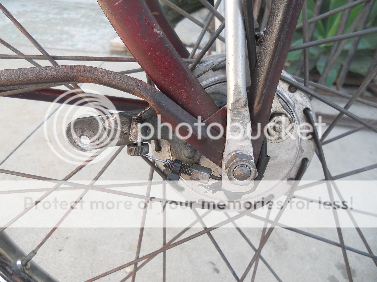

as far as the bike and what happened to it, i'm definitely gonna go over everything and make sure it doesn't happen again, which might mean welding a tab to the fork.
what keeps plaguing me in the back of my mind, is, i had a flat last week on the front. i keep thinking i might have forgotten something as simple as tightening the bolt that holds the arm to the frame, and it took a few days before it fell out.
if that's the case, one small lapse in concentration caused all this damage.

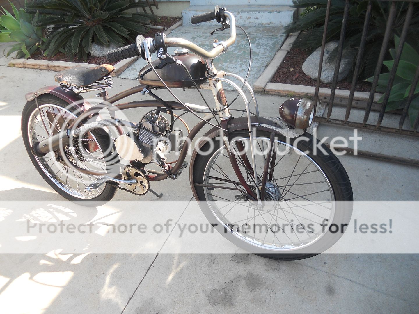

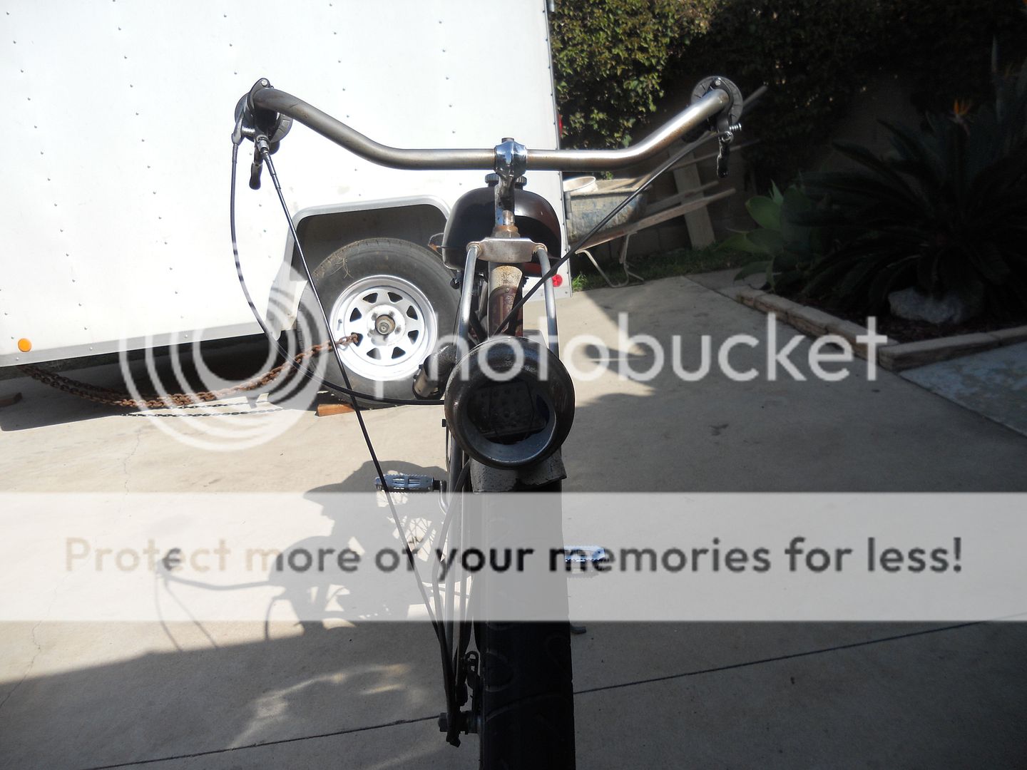

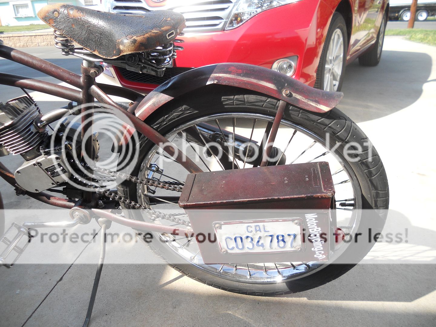

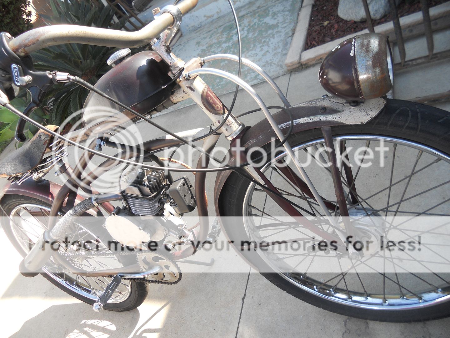

Okay Baird, checked out the bike and I gotta say your crash wasn't due to workmanship issues. It's put together very solid. I found your bracket for the brake backing plate arm dangling in the twisted mess at the axle. It is thick metal like you said and did not break. Looks like the bolt came out allowing it to spin when the brakes were applied wrapping the cable around the axle and locking it all up. Notice how tight the cable is in the photos. You could play a tune on it. The right side of the handlebars are bent down some from the tension. Also broken are the bracket holding the cable conduit, the long threaded adjusting screw the cable goes through and the adjusting screw at the hand lever. When it spun, it hit the fender braces and pulled both ends of the fender down onto the front tire. The rear fender took a hit while tumbling and the headlight looks a little crooked. I loosened the front axle to take the cable loose so I could roll the bike into my garage and I'm sure you will find other areas that need attention when you get around to repairing the damage. It all looks like a quick fix if you can use both hands. Call me when you get ready and I'll bring it to you. Oh, and as far as owing me for getting you to the emergency room, forget it, that's what most all of us would do. We got to stick together and watch out for each other. Although, I may help myself to the Gummy Bears I found in your tool box.

yeah, look at that rear fender. i wonder how much air the bike caught to land on it like that...
