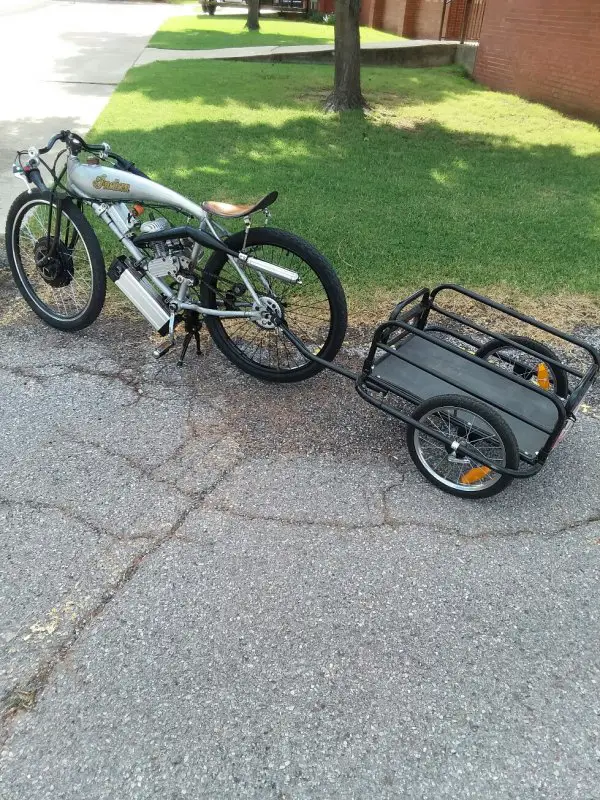

My little trailer setup for this bike just loves the slow smooth pace of the hybrid setup.

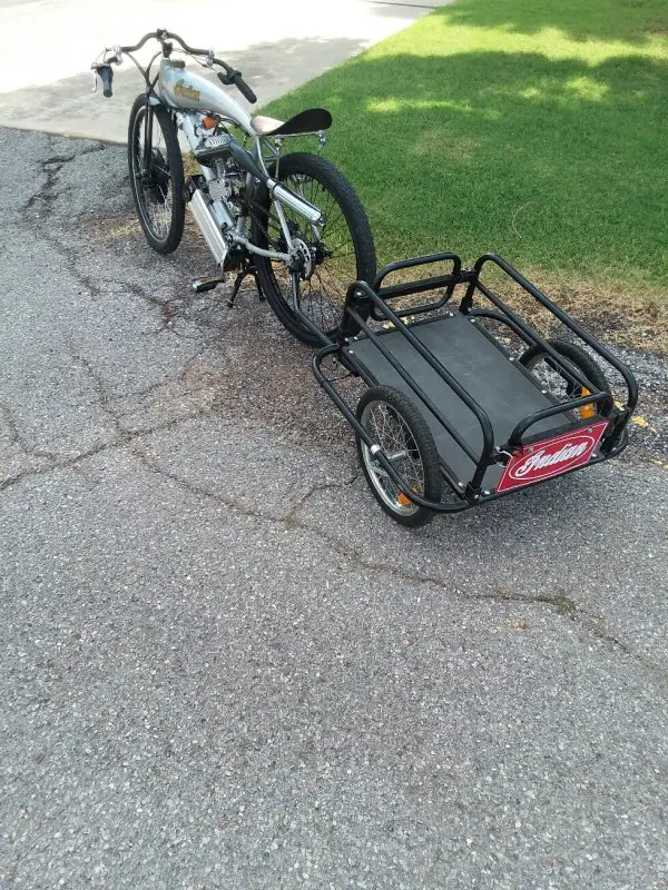

36 tooth switch works much better than anticipated. A 30 mph cruise hardly uses any throttle to maintain speed the engine feels less busy along the way because it isn't. New clutch lockout lever works a charm and securely holds the clutch during e-hub cruises and I'm enjoying not having to fight the 2 stroke at minimum balance speeds. My biggest surprise was acceleration from 7mph or so isn't that bad with the gas engine only, but acceleration from zero to 15 mph is much improved using only the e-hub.
Trailer for big job!

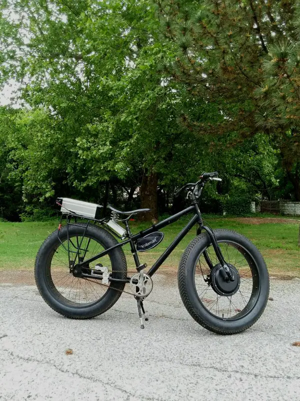

Ok so here's the deal now that the hybrid is reality my next electric modification will be to upgrade the fat tire bike to twin 48 volt 1,000 watt e-hubs on both front and rear, with twin controllers and two 48v. 15 amp lithium battery packs. Wired to run single or dual throttle, controlling one or both hubs together or individually and selectively utilize either battery pack shared or independently. 20 amp packs @ 52 volt, will eventually find a home in my all steel, cheap (Walmart type) Mongoose brand "Pug Ugly" fat tire ride: one of two I salvaged from curb side discards. No usable tires or wheels and one looked like it had been backed over by a car or truck and couldn't be saved, so I cut it up to see what it was made of and was a little impressed, but I may end up adding some grommets for additional strength on real (bad) country roads!
I'm not wanting more speed, far from it. I want more Jeep like qualities, utility, redundancy and range...all wheel drive, all terrain and every season utility vehicle with pedals and when it's completed I'll add a real all purpose utility trailer (for gear and more batteries) as well.
This is what I'm starting with:
My location in the arid southwest portion of Indian Territory lends itself to such a purpose built bike.
Rick C.
Thanks Curtis I ordered the motor and controller, but held off on the additional battery. I'd like to feel how this rides and pedals before chunking down the $$ for yet another battery pack which will make four lithium packs I've bought in the last 3 months...the pack is worth it but only if this bike feels right with the extra motor on board.
I failed to mention that the rear hub will mount a rotor....so goodbye to the coaster brake as well. Though this is a single speed frame I may use the 5 speed cog on the hub and just manually change the ratio depending on usage. I've already a spring type tensioner in use on chain. Or just go "fixie" and have a perfectly straight chain line....

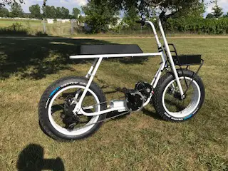

Geez Rick are you a triplet? Are there 3 of you? You never stop working which is awesome! How many bikes are you holding in your herd? Good looking fatty. I love the wide rims .That beast there needs some dirt as Curt said.I don’t have a ebike....anymore. Because 3000 watt 72v 20” tires and 7 speeds was over kill.

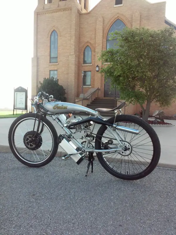

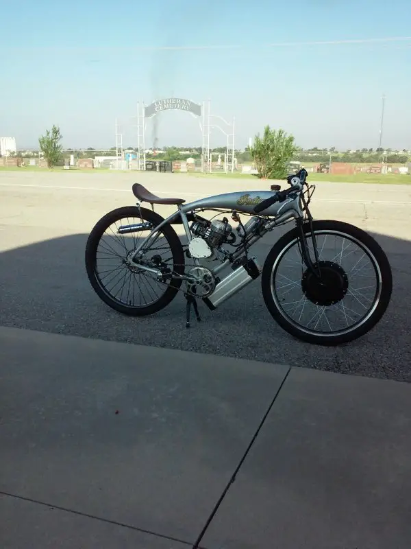

I rode my hybrid over the five cemetery trail, 44 miles, round trip yesterday morning on the hybrid with one short stop to stretch and take photos. One hour 45 minutes with 6 miles of deep gravel that will have me cleaning the bike today. At 72 years young the board track stance isn't ideal for rides of this length, but I wanted to test the bike in both the electric and gas driven modes over varied terrain & this ride is mostly hilly with truly flat section rare and short. No pedaling required at any point along the way. I used the electric going through a small town( pop. 500) & several areas that were of scenic interest & I needed a snails pace to view them from.
The hybrid takes much of the concern out of longer rides that involve battery power alone. Though the mountain bike with ehub assist used on only the climbs would no doubt have made this cruise on one battery pack (36 v. 15 amp) as well and (being full suspension) my comfort level would be greatly improved.
Great morning & nothing fell off or loosened up on the hybrid, though my fatty or mountain bike are much better in the deep gravel... and that's a fact.
The Church shown is located at the highest elevation in the county & the lights of 5 towns can be seen at night from this height.
