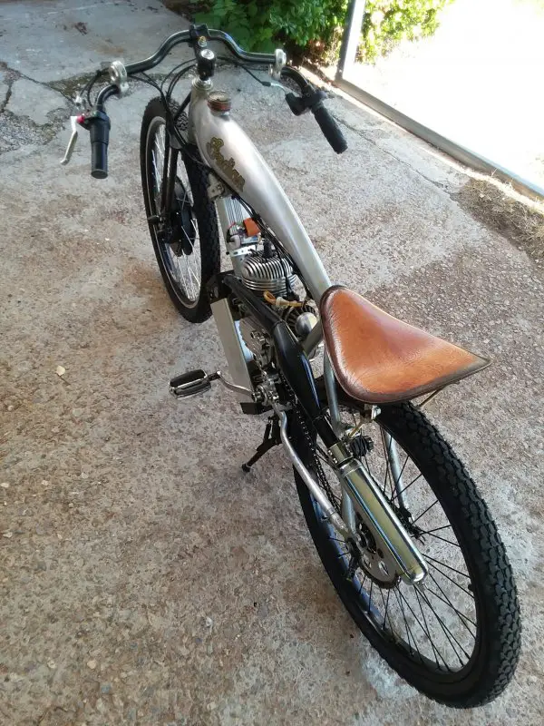

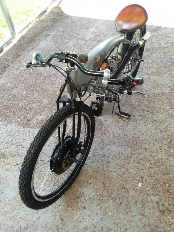

Tom the switch is a mechanical rotary type. the problem wasn't electrical but a mechanical locking rod which was combined with the switch got jammed & I ended up eliminating that locking rod and it's associated parts. The battery is mounted on a slide rail for easy removal & it works fine on my other bikes but not this one. The steel rod (bolt) is elevated by a small cam in the switch mechanism and goes through a hole in the slide to prevent easy theft, the way I have the battery mounted on this bike it would be far easier to steal the entire bike than remove the battery pack and that bolting rod had to be eliminated to use the mount I made. Mounting space was at a premium for this large battery pack.
All the above is probably about as clear as mud the way I described it.

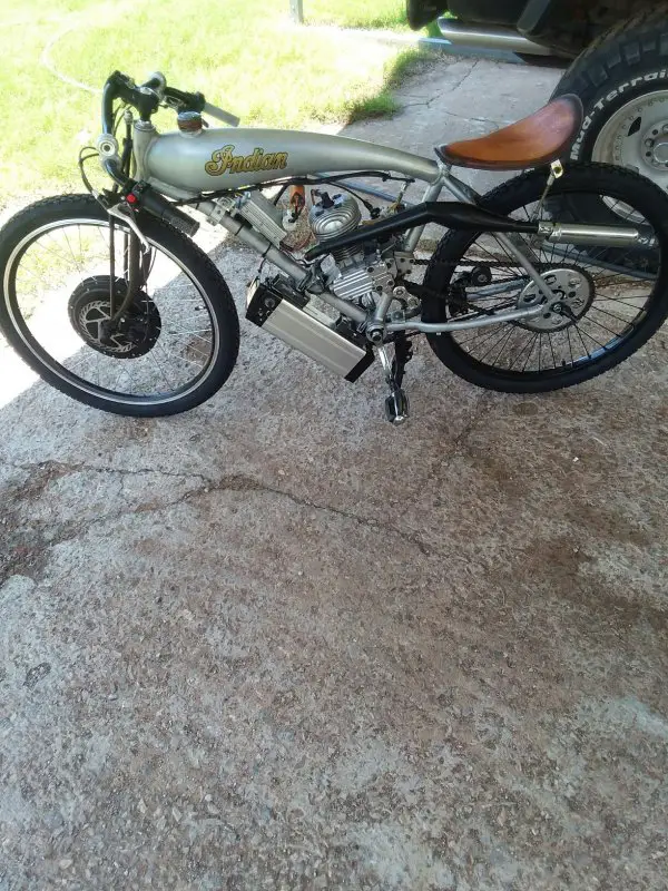

Thanks Mags and that "fine muffler" is a 7/8" od & a stock kit China girl part just re-purposed. & clamped over the stub of the expansion pipe stinger (which I shortened by several inches) and fastened with a 3 piece Harley tube clamp and also serves as the rear exhaust support. The pipe performed well with no muffler but was extremely loud. The bike runs nice low thru mid range with muffler attached, but I'm sure something was lost with the attachment besides the noise! The battery location dictated the high pipe configuration & it keeps the engine heat away from the battery plus the battery is first to get cool air as is the controller without blocking air flow to the motor.
I'd noticed on my two other front electric hub bikes that have rear rack mounted battery packs that weight balance front to rear with my weight mounted is light in front. Front wheel spin can easily occur in gravel or slick spots, not a desirable trait for steering control. The high mount also elevates the bikes center of gravity which really isn't as big a deal but it's still there. With the battery low & up front balance seems even better than before the hub was installed.
This motor has reed, piston window and third port modifications and runs well, but with 48 t town and hill gearing top speed obviously isn't my objective, but it scoots pretty good for an old guy.

Yeah the test rides are confirming the bikes balance is greatly improved with the extra weight forward provided by battery and front hub motor, night and day improvement. It helps offset the extreme rear saddle position which has the riders weight almost centered over the rear axle. This accounts for the smoother feel of the ride as the front tire and fork are now carrying more of the load and displacing energy. My butt was feeling what my brain should have known long ago. Much smoother ride and the bike really carves the turns now. The extra weight of hub and battery is kept low and that is a positive also. Extra weight? Well I've been thinking 10 pounds off my belly would be a nice trade off and also lower the center of gravity on all my bikes, lol.
Twenty five miles with the bars set as low as they are would have been extremely tiring before the conversion even with a stop or three to stretch on the one hour ride but I completed it without getting off the non suspension bike and that's not too bad for a man my age...72 Sunday.
