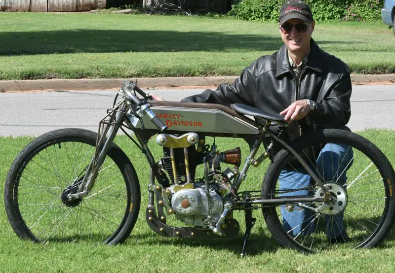

I just took the time to really look at both the Simplex and HD photos & spotted several details that I've neglected to correct or enhance on both bikes especially the Harley to achieve the period patina and look...the grips need leather wraps and the shiny aluminum toned down to match the engine case. Shifter lever lengthened & shaped, seat shock & spring might be eliminated etc. details...

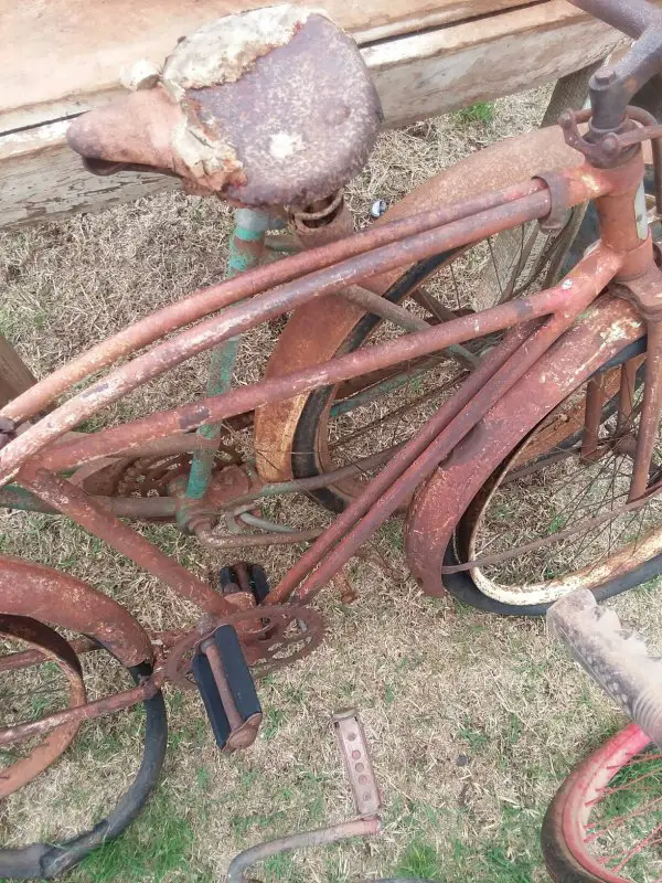

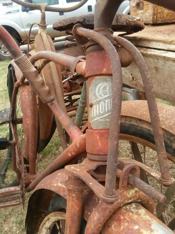

One of you guys shed some light on this old cruiser I found? Monark Silver King (part of the old battery co. in Chicago) the duplex tubes on the straddle and down tube are 'kinda unique I'm thinking. I've looked for a couple of hours but didn't see one on the internet that used duplex tubes on the down tube section of the frame. Definitely not a Schwinn Monarch and not a Danish Monark either. Kinda' cool...maybe from the 30's?
