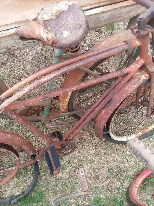

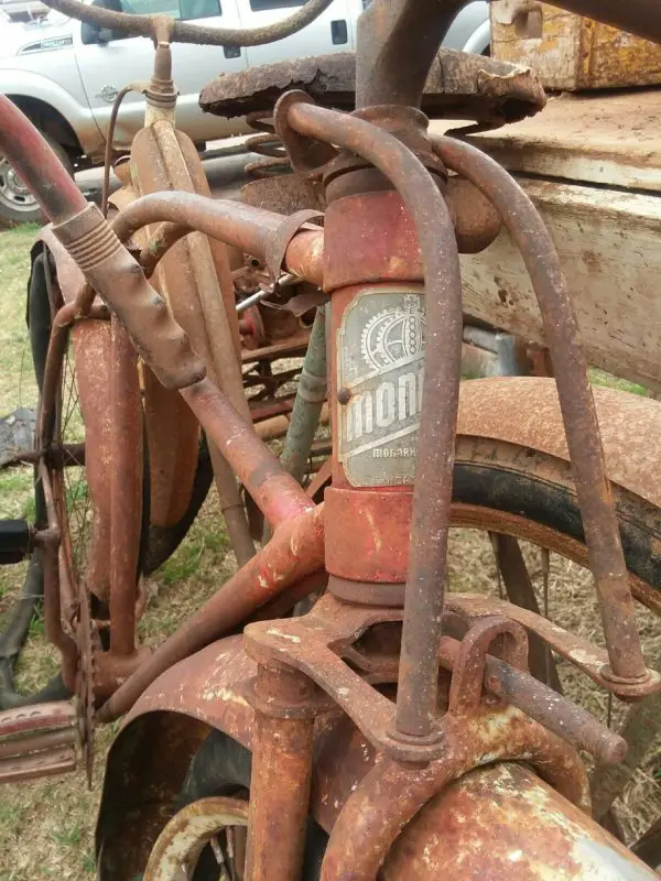

Hi Tom I did have a couple of photos that might help. I also was totally unaware of the five bar designation. though Schwinn carried the Super frame moniker over time, "five bar" description & construction was uniquely Monark. The frame in my photos doesn't have the rear twin suspension tubes, that being the regular seat stays plus an active pair of additional suspension tubes running parallel the length of the seat stays, though they may have been on the bike originally. More research to be done I suppose. My original guess of man. date was late '30's and it appears that the 5 bar Monark had a run of production from 1938 to 1941. Monark was a pioneer in building frames using aluminum but the 5 bars seem to have been all steel...really more research needed Tom. That twin rear suspension may have been an option but if you check it out was really unusual.
The dual leg frame suspension is of the single coil, horizontal "pencil spring" design, very simple plate rockers with axle mounted in the forward rocker position.
The saddle has "bell" type springs and Torrington #5 pedals.
I don't have a feel for the value of these bikes but if scarcity of information is any indicator these things could be treasures.
Rick C.
Something to add is that Monark re-badged the Hawthorne for Ward's and the roll fast badge as well....so the 1938 thru 1941 5 bar could have these badges as well. Also I forgot to add that the active rear suspension tubes were rolled in a continuous loop around the rear tire and doubled as a rear fender support location.
That horizontal bolt was the "pencil spring" support. The active rear suspension I mentioned was definitely an "option" for the Super frame 5 bars.
Best search results "Monark super frame 5 bar bicycle" Dave's vintage bikes is always a great resource and he features a 1940 Monark super frame 5 bar article with nice photos.

Tom the model I had did not have the rear suspension option, but Dave's vintage bike's has some nicely restored versions of the 5 bar bikes as do others. The two tubes running parallel to the seat stays is the dead give away to the active rear suspension. Sorry I didn't get better shots before he picked the bikes up.

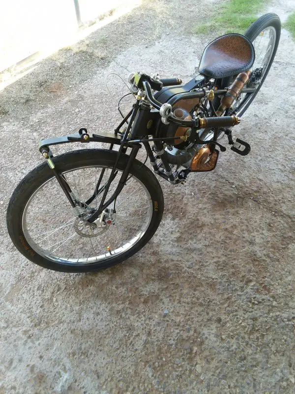

Simplex, Harley and Grubee board tracker work day, which will extend into next week it appears. Patina enhancement on all three, forks primarily right now, no paint just chemicals, patience and time.

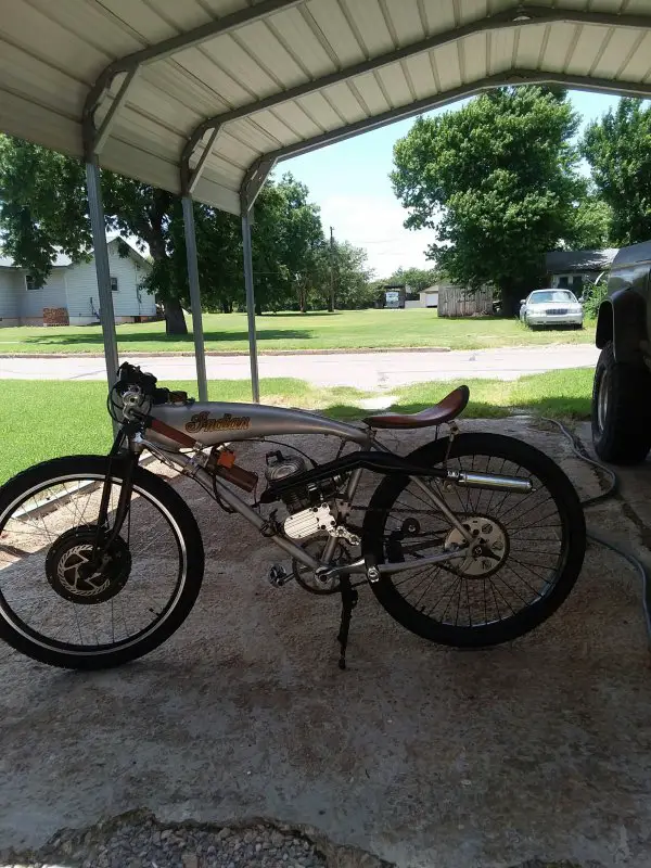

The Grubee's getting an electric front hub to use as a starter and as a clutch saver for the 2 stroke from dead stops. It will also serve as a more pedestrian friendly mode of transport at fairs, festivals and car shows. Still pedals, but when complete it's a three way power all wheel powered bike.

Thanks Curtis this is the 500 watt hub, 36 volt lithium not here quite yet, but the Grubee's got room on the front downtube to mount the battery pack between bar and tire, high exhaust keeps heat away from the pack in this location , good air flow there. Controller should fit above battery but inside the frame triangle,,,have to juggled stuff a bit...

All the room I require so far on the electric hub conversion to the Grubee board track bike, CDI and coil moved motor controller installed inside the bikes V frame & most of the electrical cables shortened & soldered, in preparation for mounting the 36 v. battery pack Took a short ride yesterday under, first, pedal power and later adding fuel and it was fine (almost) the front brake needs some attention, but I couldn't tell that the ride or handling was changed at all, though pedaling was a little more difficult. The front hub motors when they are powered up and in use do feel different than rear wheel power but I've gotten use to that on the other two electrics I'm riding.
