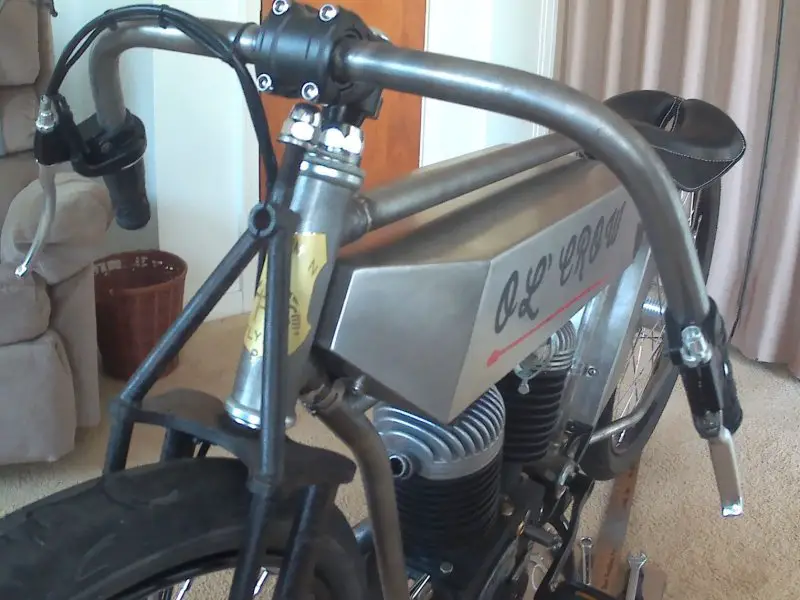

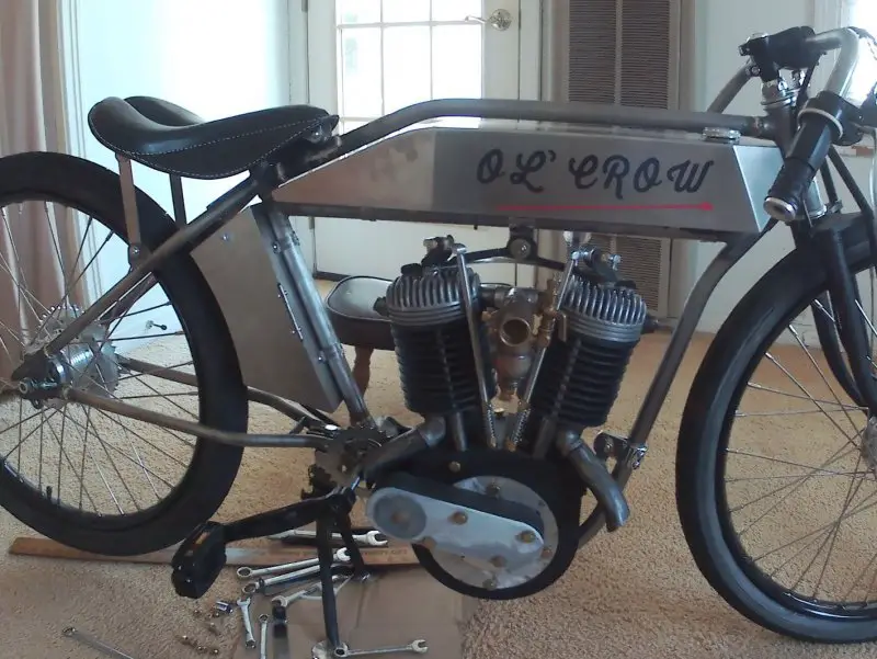

Yes it does like it.........CurtStill looks so darned real I expect it to start and run.
Steve.
With that 110 F temp, maybe lining the inside of the cylinders with solid state thermo-cooling with Peltier flexible pads. Thus the cooling from the attached points at the crankcase faux, has cooling effect on the electric motor inside. The hub in back I suspect is just a drum brake. This morning it was down to 67 degrees inside. It is supposed to get hot here, but I see the Moon at night with a red tinge to it all week. The fires going on if with light colored particulates reflect the heat of the Sun. Dark particulates absorb and radiate down to Earth in the night time. I hope there are still some OHV riding areas left to ride, one was a Bureau of Land Management area I was looking to go to and now two highways are closed on the way to it. I even think the area is part of the Lightning Fires. Have a thought of canceling my OHV insurance again. Prior spot I went was burned a few years ago so I found the new spot, but never got to see and try it yet.110 degrees yesterday, so I brought the e-V twin back inside to work under air conditioning. Pulled the chains & adjusted the bottom bracket axle slightly to the left, the motor case as well...then, well it's a process right? Rear brake cables need to be trimmed also and so it goes.
I'm sticking with the 48v. 2k motor and smaller controller at this time. As it's setup the continuous output is 2880 watts or 3.8hp, and 6.38hp at peak which I've held for about 30 seconds without burning anything out. In daily riding I'd say a bump to peak for 15 or 20 seconds or so durations would be a reasonable expectation if the motor has a period of cool off while only drawing average amperage after these power bursts.
The motor and controller both warm to the touch after extended peak power use, but going W.O.T. for 5 to 10 seconds isn't hardly noticeable to the touch.
Why not the 72v. motor setup? Several reasons a big one is getting enough amp hours inside the battery tank to power the big bike very far, say 30 miles. Another consideration is that bicycle rollingstock isn't adequate for the bikes weight during extended periods of high speed cruising. The 72v. setup is capable of peak output of 10 to 13hp. I already have two gas bikes that produce power in this range and I don't use a quarter of that on any ride. It's there if I need it...but I've never needed it.
I don't see me using the 72v. setup on this build, but it was fun testing the bike with this setup. I'll save the motor and controller for an actual D.O.T rated build, which may or may not ever take place. The 72v. battery was returned to the builder in exchange for two 48v. 20 amp hour battery packs, which was pre arranged prior to receiving the 72v. There was no way to fit the big battery in the fake tank so I rigged a bag to strap it over the tank. ugly and off balance too but it allowed testing. I'd say a tank 2 inches wider would be required for this packs use. Pat built a bike which used a 72v. battery and it fit in this tank...so it can be done with 18650 cells...high amp batteries to extend the range.
I find the 48v. in 20 amp hour or more configurations are a practical lithium pack for my requirements of daily riding. For bragging rights the 72v.
I've also a lot of case changes to make as well, all cosmetic, in addition to adding fuel and oil lines, magneto case, spark leads etc. for now I'm shooting for flawless performance.
Notice the head badge proudly displayed is Sportsman Flyer!
Rick C.
