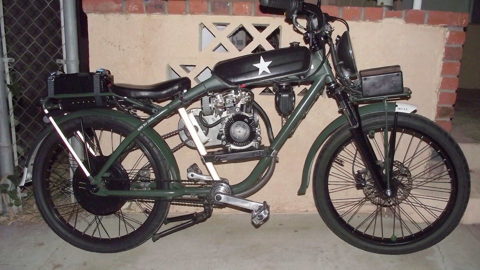

It's been a long road mate and it's about to get a little longer when my electric hub arrives. I have no idea how the 49cc petrol engine is going to perform with the drag placed on it from that e-hub but I do know I will be the first vehicle across any intersection when that e-hub is engaged. LOL

No wonder I've never seen a Crystalyte e-hub mounted on the rear wheel of any beach cruiser made. My Felt MP is more than a inch too narrow between drop-outs and it fits 3 inch wide tires. I had to notch the Crystalyte axle with a Dremel Tool in order to get it to fit, but the only thing that really matters I guess is that now IT DOES FIT and IT'S INSTALLED! dance1
There is some drag on the e-hub but the 49cc gas engine should be fine spinning that rear hub once I install a big bore carb on it. The resistance is not as bad as I thought it would be.

Added:
Suspension forks
Crystalyte H3540
24" x 2.1" front tire
Thumb Throttle for e-hub
Removed:
Triple tree forks
24" x 3" front tire
Shimano XT caliper

With a 24T chainring and 170mm crank arms you can't even feel the e-hub is there while pedaling. If you try to lift the rear end of the bike, you definitely know it's there.

I use to only go out at night and only on side streets and now I'm all over the map, even when the suns up. The battery pack, controller and rear sprocket are on the way. Once both motors are connected by a chain with the ability to use both motors or just one of them at a time things are gonna get interesting. No more pedaling on boardwalks or "No Motor Vehicle" paths for me. I'll just go into stealth mode with the e-hub.

Added:
Battery pack and Crystalyte Controller to rear cargo carrier.
Tektro e-brake hydraulic disc caliper.
Cycle Analyst Computer
Not sure what all the fuss is about the drag from direct-drive e-hubs. There is no noticeable drag at all. There's more drag from the gas motors drive chain than from the Crystalyte e-hub. I have no problem pedaling both with both of them being shut off, and I hate pedaling. dance1
Still have a two loose electrical connections to make. Waiting for special "Anderson" connectors to arrive.

Added:
20 Watt CREE LED headlight that looks like a aircraft landing light at night. It has no affect on the front 12v LiFePo4 battery.
Tested the gas motor running with the e-motor shut off and it doesnt even feel what little resistance the e-motor gives while being off.

I'm now shot out of a cannon at stop lights up to about 30 mph. That's all I can I say. LOL The 2 motors do not combine speed but do combine torque to haul my butt up any hills. Cars behind me really have to gun it to pass me up to about 30 mph. Application of one or both motors at the same time is totally seamless. The electric motor feels a lot like a supercharger with a very slight lag when used simultaneously with the gas motor from a dead stop. Top speed is now approaching 40 mph with a 48T sprocket.

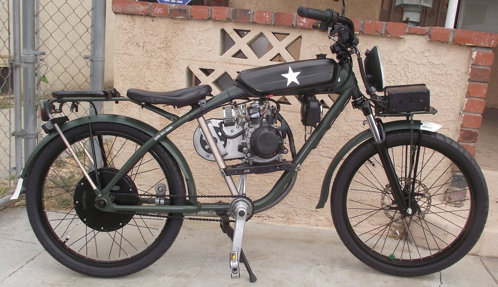

Electric is crazy expensive as far as batteries are concerned but it provides that off-the-line torque and hill climb assist that is missing from a 49cc engine and it's dead quiet allowing you to go places that are off limits to motorized vehicles. With both engines engaged I can climb any hill at speed without pedaling once. I'm still road testing. Getting ready to install the GoPro.

If you also like to pedal your bike (with the engine off) and you enjoy silence while you do, the best thing you can ever do is to toss out the roller chain link tensioner on the drive side and go with half links in both left and right chains and use axle tensioners instead. A lot less drag while pedaling and your bike will sound like a normal bike and not like some rickety tank treads going down the road terrifying people walking in front of you on a bike path or road. LMAO
