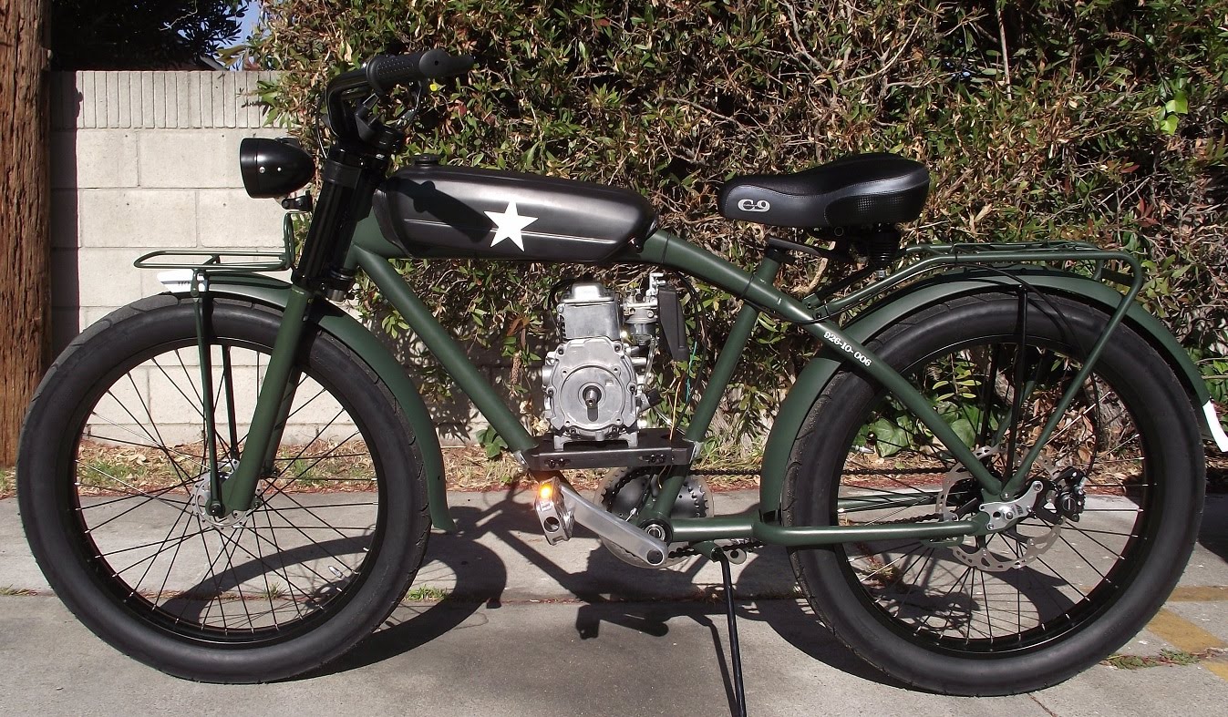

Agonizing between a jackshaft setup or a separate rear sprocket, I pretty much cornered myself into a jackshaft setup by installing the rear 203mm hydraulic disc. There is just no more clearance in the back even with a top hat adapter. I tried to cram a 11 HP hopped up GX200 racing clone in but it just wouldn't fit so I had to settle for the Hua Sheng 49cc of slowness instead. I'll have to buy every aftermarket thing I can get for this engine Still waiting on the jackshaft parts and Grubee 4G T-Belt Drive. .spr.

Love the Headlight
Too much time and too much money pretty much sums it up, but once I started I was committed to finishing it and finishing it right. 5 to 6 months work and 1000+ miles later and there it is. It's only as good as the roads it rides on though and L.A. roads suck to high heaven. Uuuugh. LOL

The headlight is made up of 2 lights: A Hella 500 on the outside and a 20 Watt CREE LED light on the inside. The CREE LED light is as bright as a HID light without the blue hue. It will burn out your retina if you stare at it too long. It goes great with the 139 Db air horn mounted just forward of the engine. LMAO

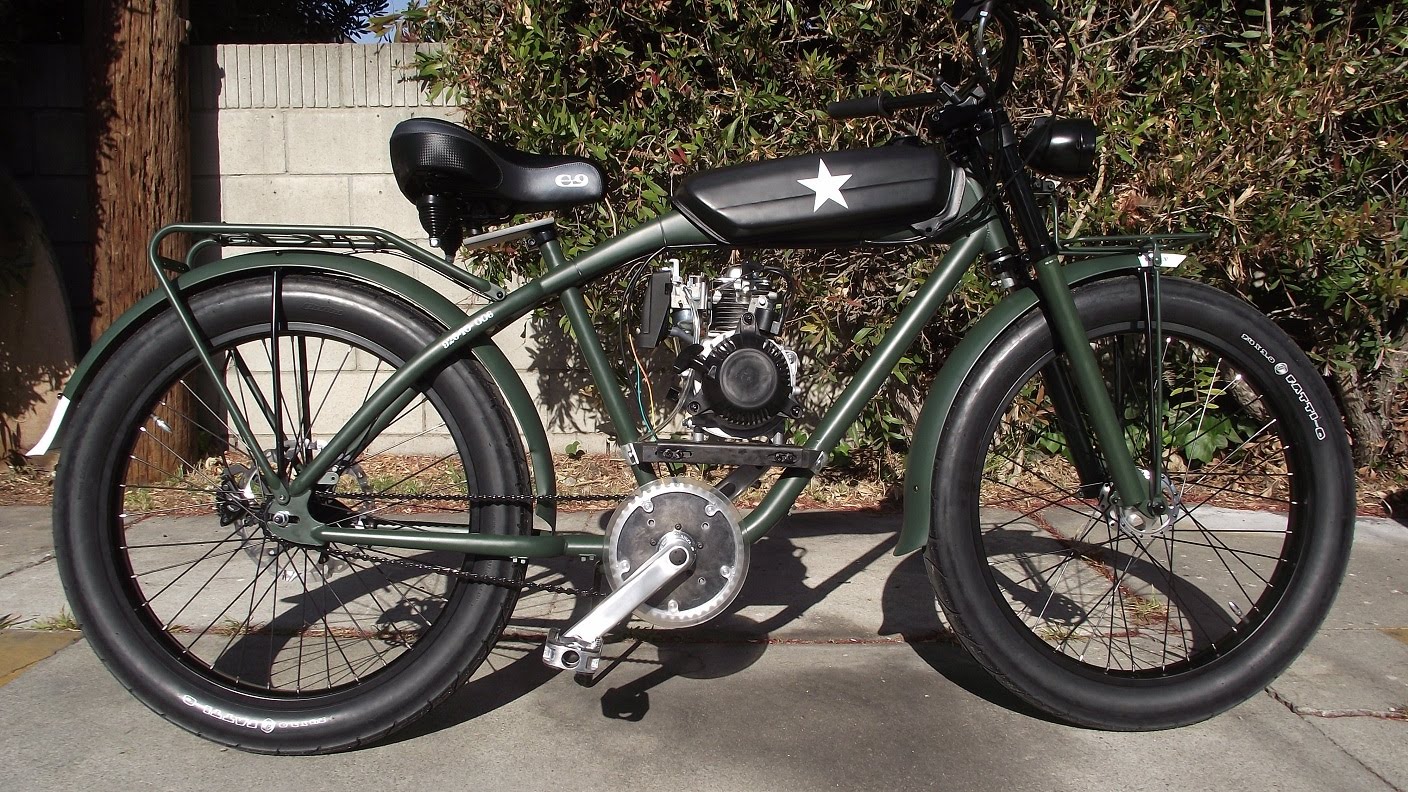

Added:
Rear turn signals.
Shimano 105 three speed front derailleur.
SRAM Twist Shifter.
Electric Regenerative Braking: 1 finger braking from 40 mph (feels like ABS Braking or a drogue chute deploying from your back every time you tap the brake). It recharges your battery and the byproduct of that is that it slows your e-hub down in a hurry without locking the wheel up.
I can't say enough about Regen Braking. It's an option on some controllers and completely left off on others. It should be standard on every e-controller as it will most likely save your life one day. In most cases I only need to use 1 finger to stop now, no matter what my speed is.

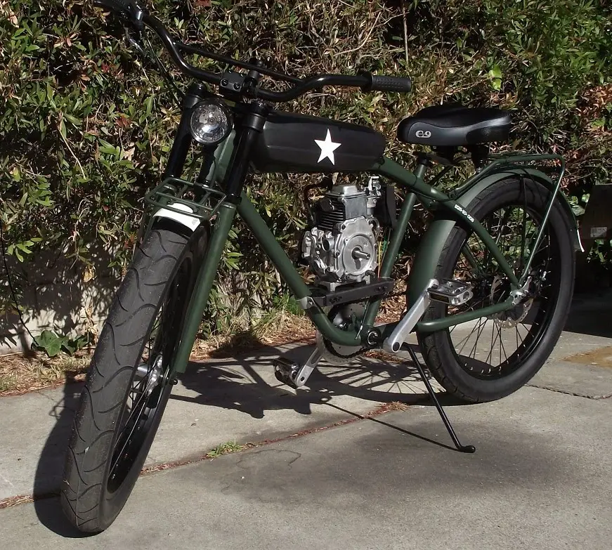

Lesson # 4623:
Must do pre-flight check before rolling down the taxiway.
I simultaneously lost 5 of the 6 allen head bolts that hold my gas drive sprocket on to my electric hub. I heard a grinding noise after leaving a 7/11 for a pitstop. The grinding noise was the 6th and remaining screw had come almost completely loose but had snagged the power cable that connects the e-hub and the electric controller. It chewed through 1 of the 3 power wires to the 2000 watt e-hub. All bolts were installed with Loctite Blue. Now sealed with Loctite Red because the Blue failed me for the first and last time. LOL :-||
Do not take your nuts and bolts for granted on your bike or you will eventually get burned like I did. Luckily I stopped at 7/11 or who knows what would have happened.
