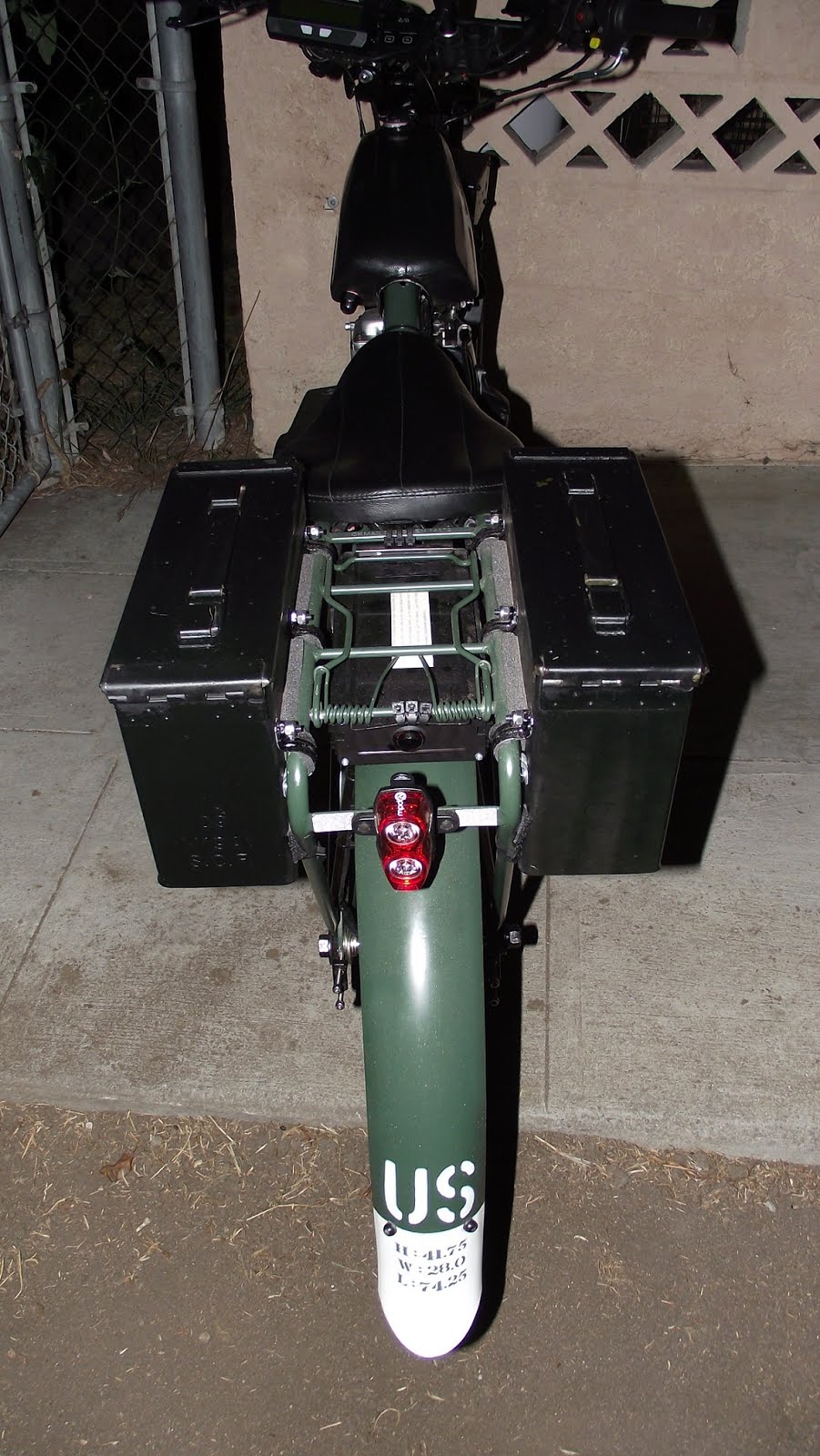

Adjusted valves and added a AGK .457 big bore carb. Added .30 cal ammo cans and dropped battery pack for rear hub in one of them. Engine is much quieter since valves were adjusted but still moped loud.

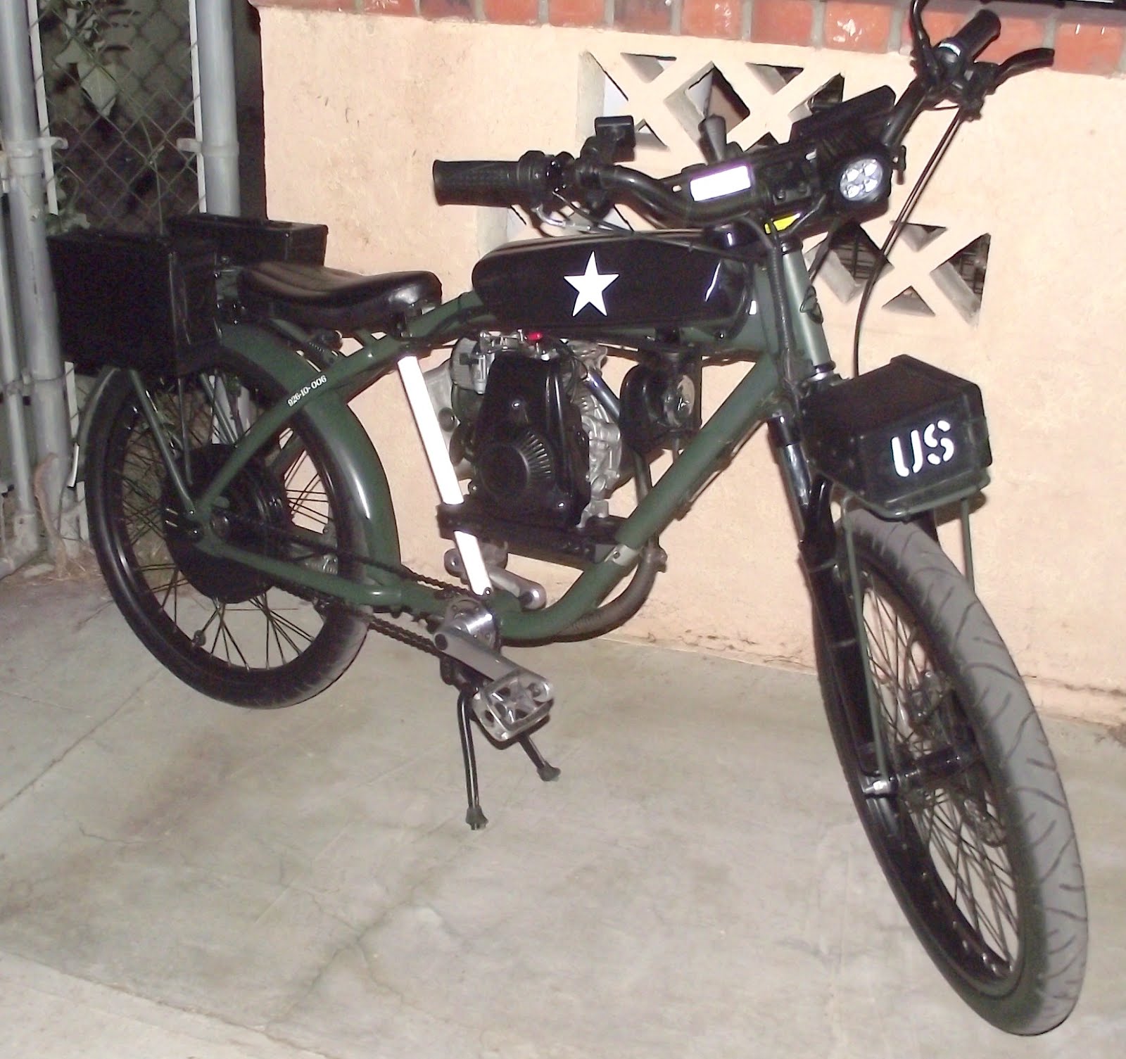

What motor. Looks beautiful.
thats the motor setup I want mmm

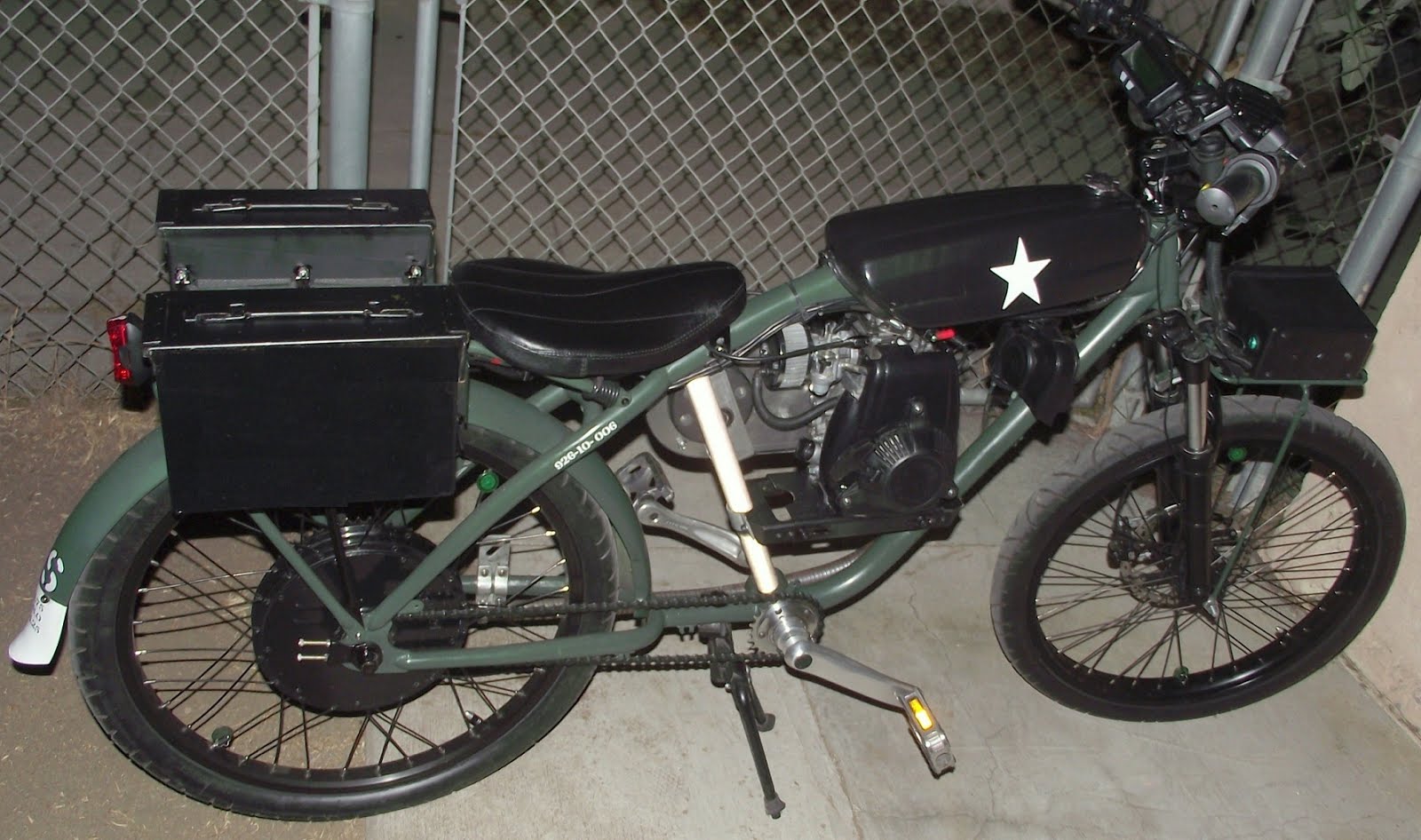

Thanks man. Huasheng 49cc gas motor and a Cystalyte HS3540 in the rear wheel. They can work together or separately depending on what you wanna do or how steep a hill you're climbing.

LOL Don't you and I wish that was the case?? Unfortunately it don't work like that. I wish it did but it don't. Any "regen" ability is miniscule and you still need to recharge the batteries by plugging it in. I do use both engines to climb steep hills and for bursts of speed from a dead stop, then I continue on my way on just the gas engine cause it's range is 5x greater than the batteries range.

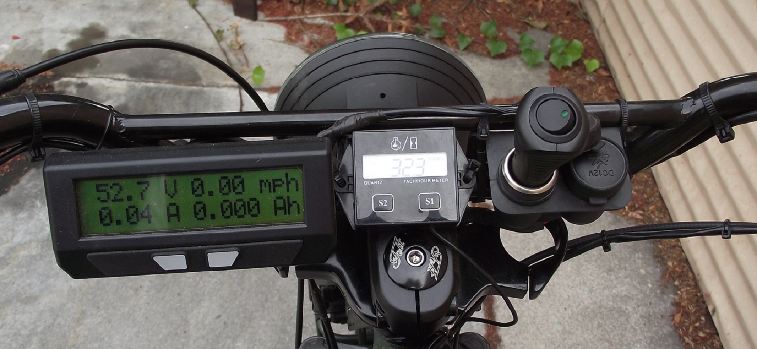

In the front black box on my bike is a 12v LiFePo4 motorcycle battery. It's unphased by any kind of load on it. I only have to recharge it about once a week and I ride at night a lot and it powers a 20 watt front LED headlight.
These are the last pics of this bike for posterity. I done did all I could do and I'm done. I learned alot and it was a labor of love and hate but mostly love. Top speed is a molar rattling 40 MPH and it can climb anything when the gas engine is combined with the 1900 watt electric hub. The gas and electric can be operated together or independent of one another. It doesn't matter. Total mileage on this thing is around 900. Who says nothing is Made in America (with Chinese parts) anymore? .flg.
Awesome Job Mike!
Thanks Dan. My work is complete on this bike, other than a license plate frame I'm waiting for. It's been a long road but everything is now working and all nuts and bolts are loctited down and the headlight has been reattached for good this time. Stick a fork in it cause it's done. .shft.
