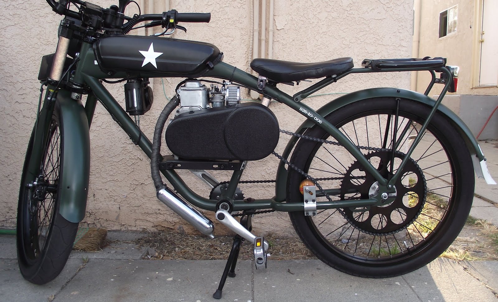

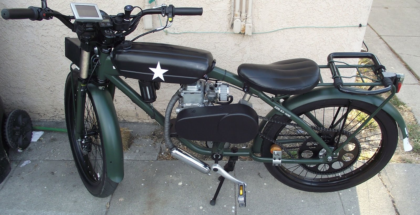

I replaced 24x3 rear tire with a 24x2.125 and my chain rubbing issues are solved. Also switched my 56 tooth rear sprocket for a 68 tooth so I can climb hills. I snapped 2 bolts in half on my motor mount and the new mount comes tomorrow. Tomorrow I will be finished with the gas portion of my bike. I have run out of issues to deal with after 2 months. I never thought this day would come, but it finally has. LOL dance1

Lookin good..lookin real good! (^)
I got's no torque on hills and I'm givin' it all it's got captain! LOL I'll be adding a electric direct drive rear hub designed expressly for that purpose. My 68 tooth will then go back down to a 56 toother for level terrain.
