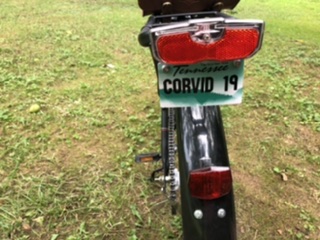

And I'm only riding during the day until I can get some lights! Was looking at something like this for a taillight/signal light.
That’s a cool light, I’ve actually been thinking about turn signals myself, I’ve considered two 10mm orange leds for each side and two astable multivibrator circuits (blinky lights basically) set to a repurposed motorcycle switch.
The taillight I am using Is a simple battery powered one with a large red led that is always on when powered (via usb battery box with two 18650 cells) and two super bright COB leds taken from a dollar tree tap light that light up when you pull the brake handles.
