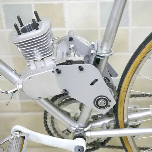

I just got it. Ty
Unfortunately I can't pay $200
Would this work?
Sure that will work, But... there's a reason the Sick Bike Parts kit cost a little more.
It's Made in USA and it uses a White Industries Free Wheel. It's worth the extra $$
It can take a licking and keep on clicking
