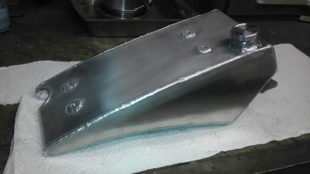

Nice TIG job, what Machine are you using?
Where did you get the Aluminum filler neck and bungs?
The Tig job was a favor from a co worker and it was done with a older miller machine . The bungs I made myself nothing really special elementary machine work on my part lol .

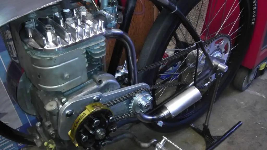

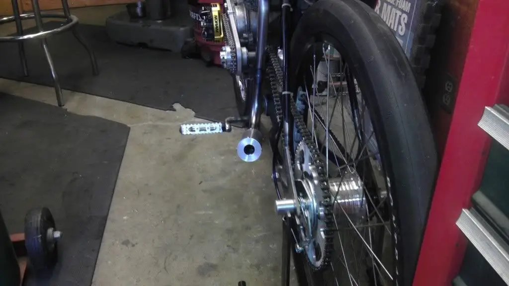

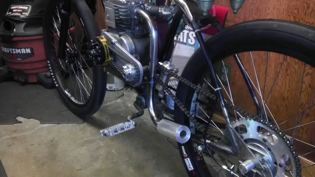

Well I got around to building my exhaust today . I think it came out close to what I wanted . A up swept exhaust with a little kick out its about 18 inches long and that is a good performance length .

Headtrama some how the pictures are way large on my screen, but I can view them by moving around.
Is the tail pipe stainless steel, cause it looks real nice and shines? I expect some blue color to coat it near the exhaust port eventually.
You use a tube bender and the way it connects threads or such, how is it connected?
Measure Twice
PS I was able to click and zoom on the attachment point to the flange at the exhaust port, nice weld there! The muffler not anything I've seen before?

We only deal with Honda's and Honda clones. It's cool seeing our jackshaft used on a Briggs.
That's a nice little muffler you have on the end of your custom header. Did you make the muffler too?
This bike is looking great! Looking forward to more progress.
Measure Twice
Thats funny the pictures are fine on my screen ,The exhaust pipe is mild steel . I bought the pre bent tubing from AGK . The exhaust is mounted with a flange but there are threads in the port to screw on a muffler as well .
Thanks , That jackshat kit is a great little piece you sell . Yeah I made the muffler as well it came out pretty good . Thanks for the compliments I am getting closer to breaking the bike down and sending it to get powder coated I am looking forward to riding this .

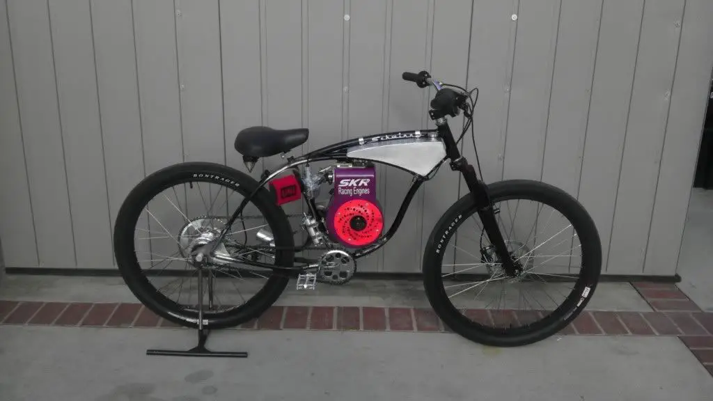

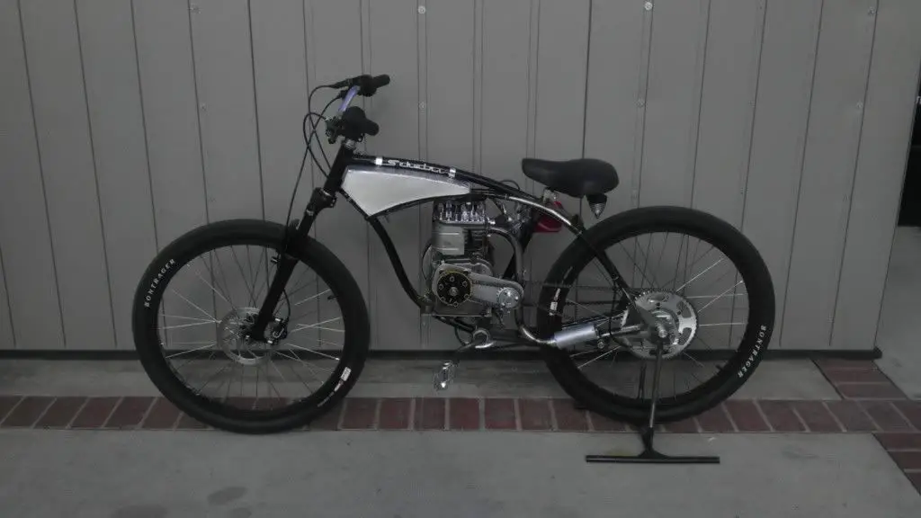

Well I tacked on my last bracket today , This bike is fully mocked up now and ready to be taken apart to finish weld everything. I am happy with how it came out , I am looking forward into starting the motor build of this project . here are some pictures of the mocked up bike what do you guys think .
