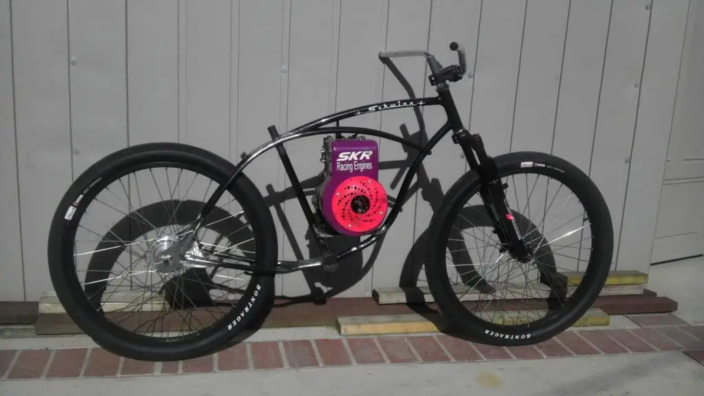

okay here is a crappy picture of what I have done so far. I got a seat mounted finished welding the motor mount in . I made the two piece intake manifold and mounted the carb on the motor . Tonight i bent the crank arms to clear the motor and ordered a few parts. I can't wait to get into this motor and start the rebuild of it hopefully soon ,

You also might restrick air flow to the two stroke riders, or offset the needle valve to get the same effect. The two stroke wait every other stroke to get enogh air to fire. Four Stroking! ;)

is their a place to buy them? or do ya just gota find em? i've been look'in not so much luck. and how's the two plate clutch work? thanks dennis

Sportsman flyer sells everything for the rear hub . It is a wide hub with a thick Axel . Some frame modificatin required. The two disk clutch is a centrifucal clutch that I'm going to use on my fourstroke.
