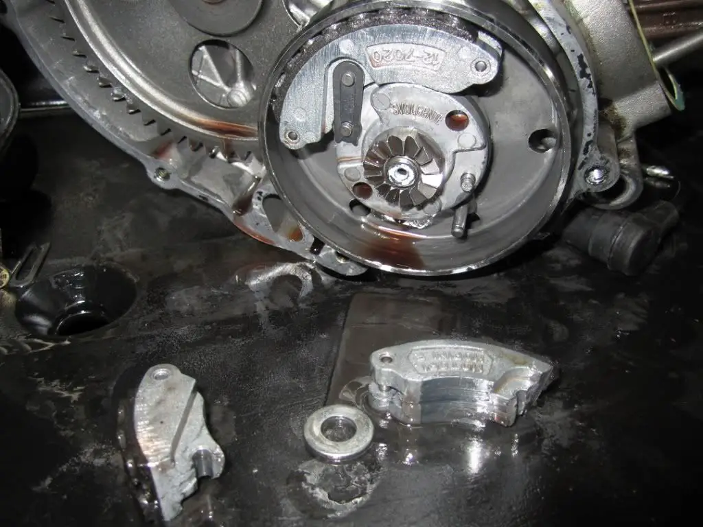

Sooo I was cruising towards downtown the other day and I noticed my idle was bogging down.. as I tried to rev it up it became harder and harder. Then It chugged to a stop. I tried to kick it back and and the kick start was completely seized! Unfortunately I wasn't carrying any tools on me so I started to peddle home, 10 miles back mostly uphill with the heaviest bike ever. (lol i was i was exaggerating) since I'd never thought my clutch would have ever been an issue because it's stock, I did remember mixing my fuel 50:1 which led me to think I may have burnt my motor up. I pulled it apart...
wow is that a clutch pad?
damn
well there it is.
Stupid me thought for sure it was the motor so I pulled my head and pulled the piston out no scoring on the cylinder walls, piston is clean, no visible damage. Attempting to put it back without a ring compressor scored the rings a bit. Now I need a piston ring compressor, piston rings, and all the related gaskets doh! ~ ~
I feel your pain, after mine broke I found out this is very common with these clutches. They always break in the same spot.

I think the Grippa 3 shoe model is more heavy duty. I have yet to break a Grippa clutch or a two shoe. I did not use my 2 shoe very long on my first 5.8.
I did break a clutch, ''the Grippa model'' once it was my fault tho. I had a screw driver going through the webbing to hold the bell still. When I got the crank shaft nut loose the hole assembly rattle from the snap. Screw driver was in the wrong place. This in turn chipped the shoe backing apart on one of the shoes. It was an over sight on my part but I thought to share so no one else does it.
Lock tight, is ''very important'' on all of these clutches. I am considering a slightly more serviceable grade red lock tight. I have used a blue lock tight from a local hobby shop that has been perfect so far tho.

I ordered 9.4 with 3 shoe clutch is that what I am looking at in your picture?
2 shoe clutch..

Clutch wasn't very old 100 miles or less.
S6-T engine has two shoe clutch.
I believe the S6-S comes with a 3 shoe racing clutch.

My clutch just blew for the second time - i got 2 years out of the old one- the 3 shoe was 200 from Herdan and the 2 shoe 100 so i ordered an original 2 shoe again, as im short on cash right now.
robin, your not afraid the 2 shoe will break again, i purchased my engine used off someone here on the forum, and he said he had replaced the clutch already, and it just blew again (after 200 miles) it seems those clutches are garbage, im very frustrated right now as im sure many have been with theyre clutches failing, did u say you had the 3 shoe on there before?
Three shoe clutches are cherry...The two shoe clutches are junk. I have yet to break a three shoe. On my Morini S6S/Boxer I tried to wear it out ''3shoe'' all summer! The clutch is still perfect and in a wet oil bath seriously it is barely worn.
The three little bolts that hold the washer stacks/shoes on the hub ''do not tighten them more than 8 foot pounds guys''. That is what the lock tight is for. A bolt that size in any application is not worthy of uber strength torquing.
damn
well there it is.
You wouldn't happen to know were to get one of those clutch nut gears from in your pic any help would be much appreciated. Ps what motor is that on
