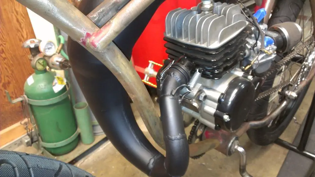

Its been pretty fun so far building this . As far as the pipe goes all am doing is cutting and rotating some of the joints . It shouldn't affect it at all . I am going to run the pipe dirt bike style hpefully it comes out cool . I should have the pipe done in a couple of days .Cool! You may just be the inspiration I need to build my own Looking forward to see how you fit the pipe. My concern about cutting up the pipe for this is that you'll lose the full potential of the expansion chamber
Lol it is a big a@! Pipe . It should rev to 13,000 rpm now lol . I started to gas weld it but that's when it caught fire . So I had to pull out my mig , it came out okay a coat of black paint will make it look good again. I should have it done tomorrow .that big ass pipe will rev to the moon. with that oil/carbon contamination did you gas weld it? close up's bro!
Here you go Dennis , I worked on this pipe all day to finish it up . I just have to weld on two tabs to hold the muffler on . Here is a close up of the welded head pipe and a side view with the muffler on it that I made .that big ass pipe will rev to the moon. with that oil/carbon contamination did you gas weld it? close up's bro!
