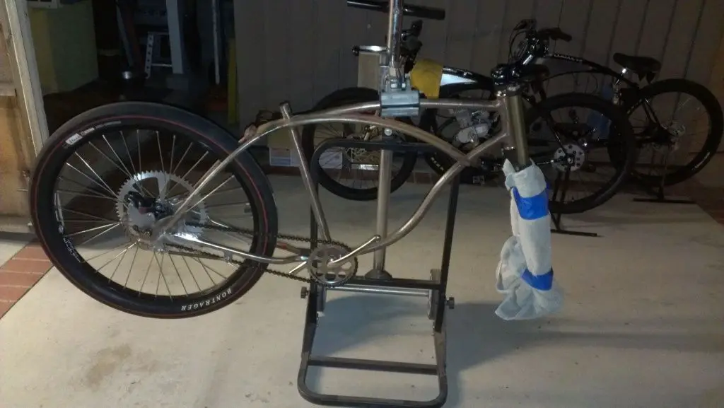

Thought I would post a pic of my morini clone build. Another early 80's schwinn build. This is where I am at so far I am in no hurry to finish it. I'll Update
as I go along.

Looks like it is gonna be a nice looking bike so far. Has fun curves to the frame on it. I see you got a Sweet set of Down Hill Heavy Duty forks stashed away from our view in that towel ? !!:)

lol not hiding the forks , i had them on my fourstroke build but replaced them with another set . just trying to keep them from getting beat up . when i get the front rim ill uncover them .

Okay I got some more parts for this build and thought I would add another picture .I am still waiting on my new tires to come and the motor should be here soon I am hoping by tomorrow . I almost have everything for it I still need to make a gas tank for it .

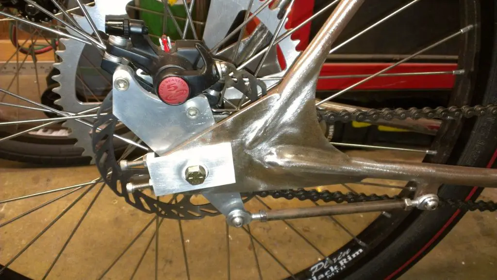

andy some more pics and info on that rear brake and hub. always taking a different path i see. cool! dennis

Here are a couple of more pictures Dennis , The hub is a Dam good engineering hub . It is the same hub they were using on the boxer bikes. I am running a mechanical rear disc brake and ill have a hydraulic front disc .

WOW! very nice, go fast... better to stop faster. big sprocket to get on the pipe. nice grinding too. dennis

Yeah its a 62 tooth sprocket, i am thinking of going to a smaller one. When your not a great welder you need to be a awsome grinder....

Bike looks awesome! I'm like you. I grind down all my welds but you've done one heck of a job blending it in.
I think a 62 tooth is too big. That's what I use when I go riding on the trails or up in the woods with Dean. Your top speed will only be 30mph. I think the best rear sprocket I used for street riding is a 47 tooth. Plenty of power off the line with decent top speed (low-mid 40's) Im not sure if you got a pipe yet but the FMF Fatty pipe is probably the best pipe I've tested so far. Outragous mid range pull.
