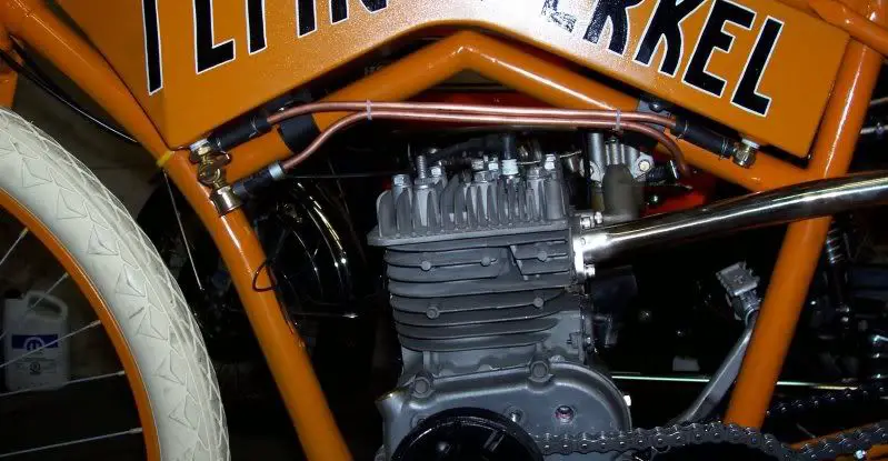

More stuff done! Herm came out tonight for a break from the usual stuff. We finalized the gas tank mounts and modified the fuel tank petcock etc and fabricated some fuel lines...I love copper!
After that we fired the engine up (he hadn't heard it run before) and gave everything a good spin-up to see what would fall off (luckily nothing). If it hadn't been pouring rain I'm sure it would have had it's maiden voyage, but that will have to wait until another day...all that's left to do now is build a period correct kill switch and a little cap for the steering stem.
I see you have some rubber hose at the ends of the fuel lines. Is that to prevent the copper fracturing from vibration?
Brett,
Yes exactly...I'm not really worried about the copper fracturing, but it does make things much less prone to vibration and leakage (I have had problems before with brass fittings) and it makes it a lot easier to attach and disconnect as well.
Good idea. As you probably already know, on the old Harleys with copper oil lines they put a loop in them to prevent fracture from vibration.

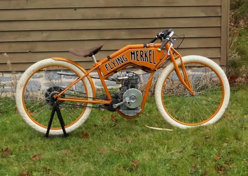

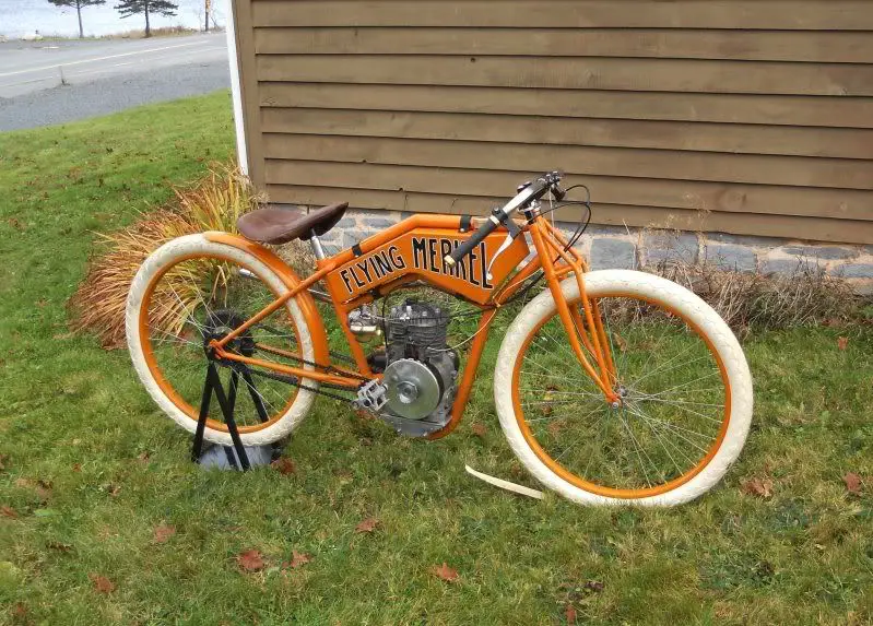

Herm came out this morning (20 Nov.) and we had the Flying Merkel on the road for the first time! After some slight teething problems (seat too low and our bellies too big to get our feet up on the pedals and right leg choking the engine to death when applying the brakes) everything else seemed to work perfectly, including the pedal start system and the compression release...in fact you can simply walk alongside the machine with the compression release engaged, let it go and the engine will fire right up. I had it puttering along very happily at about 50kph with a whole lot to spare. The machine handles perfectly and sounds very sweet without being too loud. As I said, the seat was raised about two inches which made it a lot easier for us to get our legs up on the pedals and we modified the intake stack to make it impossible to choke the engine when running with the right leg. After that took some outdoor pics of the bike and the two idiots who built it. Herm seemed pleased as punch when we put it in his truck to take home...I had a great time helping build it and I know he will have a ton of fun riding it around his neighbourhood and as a pit-bike at the local drag-strip.

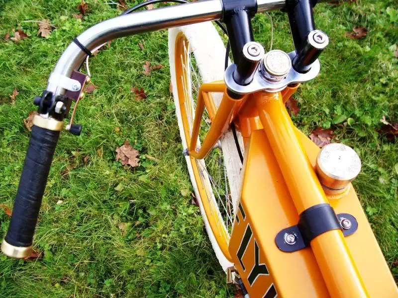

Finishing touches ...kill switch, steering stem cap and gas cap.
