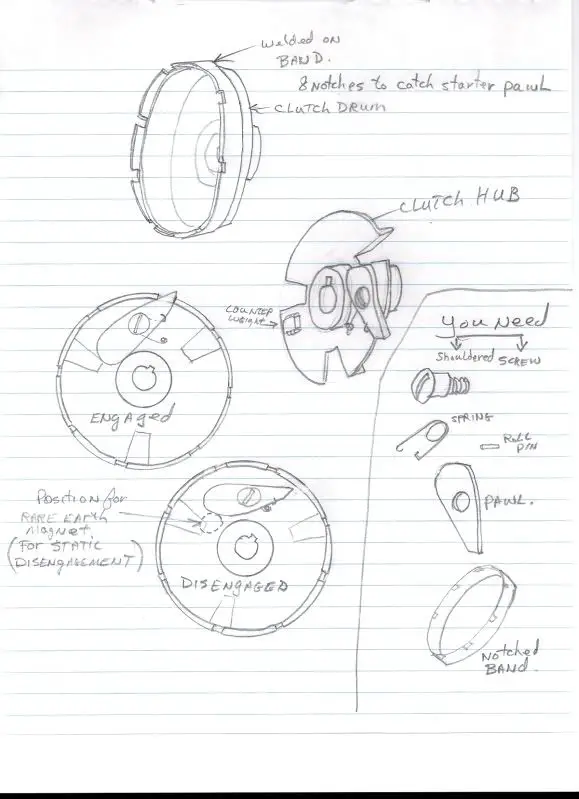

There is a pawl bolted to the clutch hub that catches via a very light spring in a notched band that is fastened to to drum. When not running, the spring pushes the pawl into contact with the notched band; when running centrifugal force overcomes the spring and the pawl disengages. There is a small steel counter weight welded to the opposite side of the hub to keep it in balance. If you are patient with me I'll post a drawing later.
