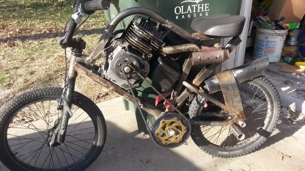

This is my 1st successful attempt at building a motorized bicycle. From what I see on here most people use old Schwinn type bikes. I chose to go with BMX for a couple reasons. I will keep those to myself! lol
I know the slant of the motor might raise some questions, and I was worried about it from the beginning but so far it has not cause any problems. I'm sure it will foul up the motor eventually, but h*** this thing goes and for this build that is really all I cared about.
Built with 90% found or scrap or junk or re-purposed bits and pieces.
probably a dozen different people have driven this thing a total of 100 miles, HARD.
I wish I had taken more pics of what exactly went into this thing and all the bits and pieces. But there's some good stuff here.

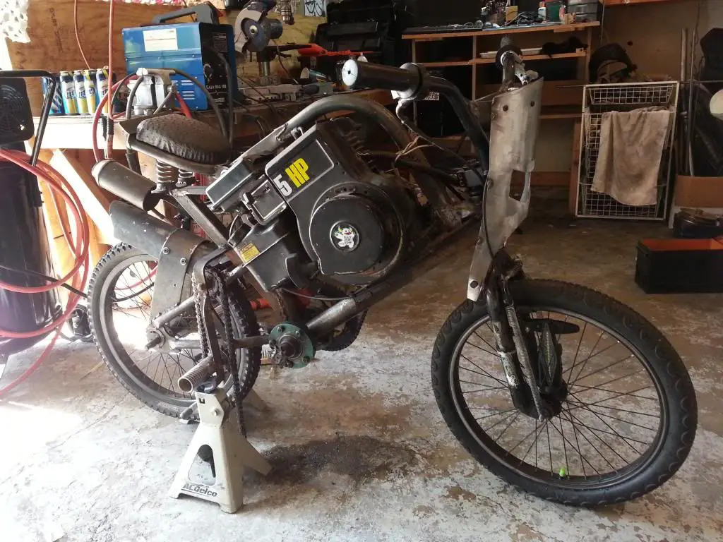

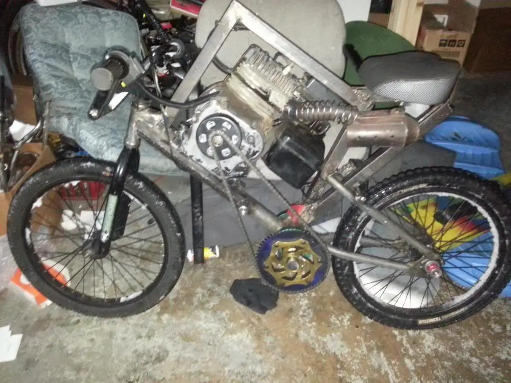

There were a total of 3 phases (so far...) of work done on this "thingy". A "thingy" that hits 41 mph. First it started off comprised of the BMX bike, and pulleys and belts from the Tiller that the motor came from. It "worked". Then I gained access to some junk go-kart parts. Some frame mods, and changing over to two chains (hence the name) were next. The 3rd phase

Thanks! I considered making a chest pad that continued from the seat and up that top bar but ultimately the rounded section looked way cool anyhow so I was happy with it. Here's a better picture of it.
It goes 41 mph, and breaks earth loose going up steep hills if your not careful! It even punched somebody in the face...

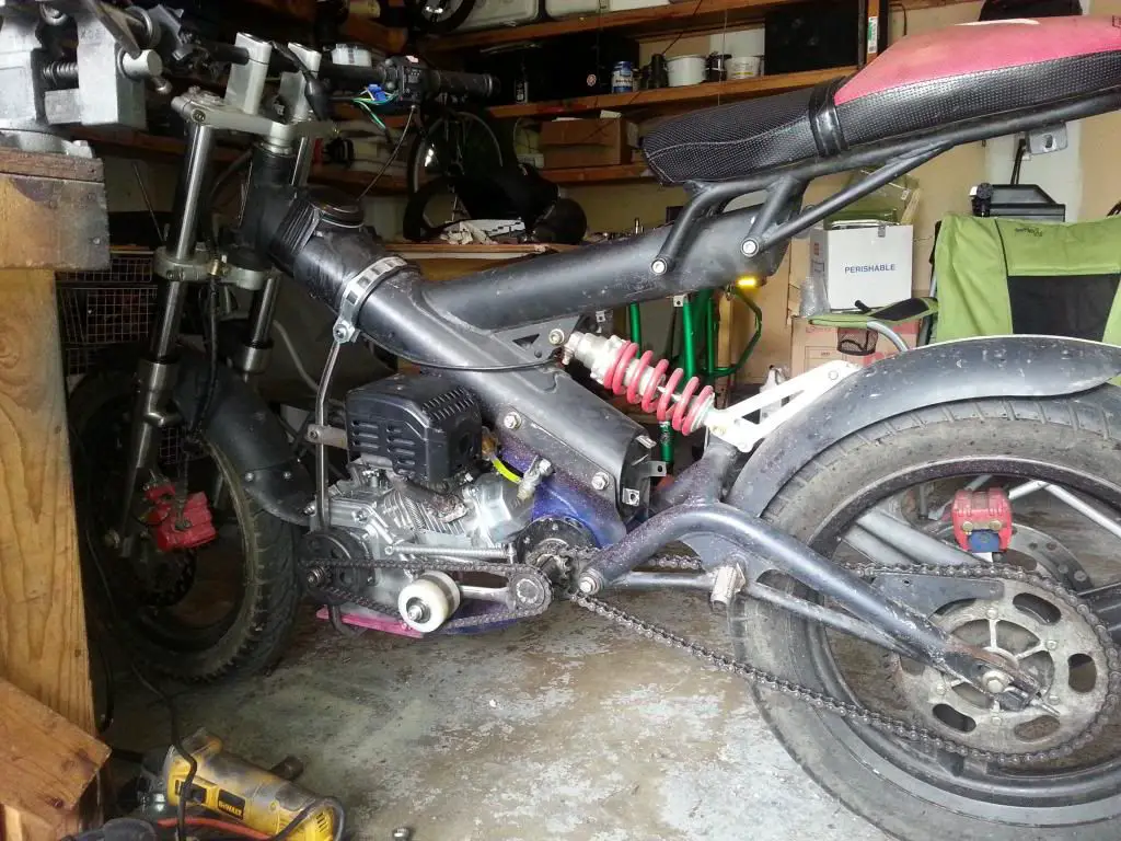

Here's another rig I did. But it's not a bicycle so I'll just put it in a comment!
Getting hit in the face with that engine must have been unpleasant, lol! That's like the first time I forgot to counter hold the right grip against the compression pull starting mine, BAP!
How come you didn't put a Lifan 125 on that Sachs? Preddys cool, just wondering since it would bolt right up.

Well I didn't have quick access to that motor, and I didn't want to waste time when i have harbor freight down the road. 212cc motor for $130 ain't bad. Plus, this is all really building up to what I am ultimately trying to accomplish which would consist of an entire frame build etc utilizing economical bits and pieces. Trying to make it a utilitarian device. I think of these projects more as prototyping than anything else. The compression on the 212cc predator motor will yank the cord right out of your hand if you are giving it too much fuel, to my understanding they are not equipped with a compression release trigger. The bmx bike did a wheelie right into a friend of mines face because he was standing in front of it holding the throttle while my other friend was starting it up. Was rather comical, everybody was fine surprisingly.
their compression release is on the cam, it opens the exhaust valve at slow rpm's then moves away upon startup. still it will get u sometimes. got to see it in action!!

I did take some pics of "the rest" of the build:
I wish I had finished that up with a pic that includes the rear wheel. Maybe I will add one later on.. But that's not all....
