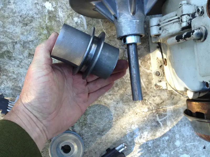

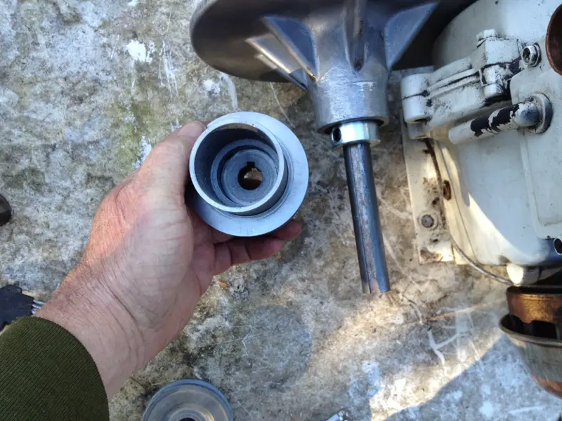

A couple of weeks ago I thought I wasn't going to be able to use the Constant Velocity Transmission. Bummer. I posted photos describing the problem and forum members gave it the "creative stare" offering suggestions. Curtis Fox and msrfan saw the solutions and right away Dale (msrfan) set to work making a cupped pulley on a lathe. A few days ago it arrived in the mail and now it is on the bike.
In the photos below and on the next post you can see the original housing and shaft. Also pictured is the extended shaft with a split collar on the front side and a lock collar on the back side holding the shaft snug in the bearings. There are several views of Dale's cupped pulley housing which rides on the extended shaft and is keyed so that the two are locked together. The pulley itself is free to slide on the housing so that it can be aligned with the sheave on the rear wheel and then welded in place. It appears that the pulley needs to be right where the transmission bearing is located, which is the reason for the cupped housing sharing the same space. Great solution to the problem! The shaft is long enough that I have temporarily placed an additional pulley to assure myself that at a future time I could have a belt running to a generator or alternator for powering lights and horn. Don't know that I will, but I could.
This has been a major hurdle in the build and I am relieved to know the transmission is going to work... "with a little help from my friends", as the Beatles sang.

Hey SB the Picassa photo order may not suit you but you sure ordered the right parts from the right guys! Very impressive to get 3 guys on the same page of a problem & come out with the solution, especially when each are located at a considerable distance from each other...anyway a "special" bike should involve special & talented friends, which you all are. Rick C.

Looking good sb. Are you leaving that collar on the shaft? If so, just wondering why.
Without the one on the back side of the transmission there is a bit of wobble of the shaft at the bearings. With it there's no wobble. Maybe that's why on the original shaft there was a nut at the front side and directions for a certain amount of footpound pressure. With the cupped pulley there is nothing firm for it to butt up against without the collar there. So it seems to me anyway.
SB
Yeah, you're probably right. I had a similar problem on the 5/8'' keyed shafts of my homemade 2 speed trans. I fixed it by drilling and tapping 5/16'' X 18 holes and inserting button head bolts in each end. Still had to Loctite the threads. Looks like you should be fine with that setup.
Good. I'm glad you think it will be okay. It will be something for me to keep an eye on.
SB
If worse come to worse you can take one of the 5/8" to 3/4" bushings i sent with the clutch and slip it over the jack shaft and drill and tap it for a bolt........Curt, that drill guide is the bomb!.....Thanks msrfan. Yep thought about it for a couple days,come to me about 3 am SB knows that time well when the pillow will not let you alone until you salve the unsalved, was going to make three and it come to me make one with what ever inserts needed. I had already sent him a bushing for his clutch and some key stock to change it form 5/6" to fit the 3/4" clutch form Fastenal. and now when he is done with it,it may be handy for me as can make any kind of insert that fits 3/4" hole in the guide.......Curt
