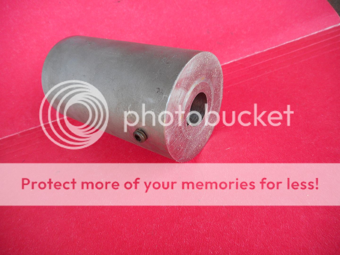

curt, I missed your post this morning and starting making a pulley mount at work today. Here's what I got done so far.

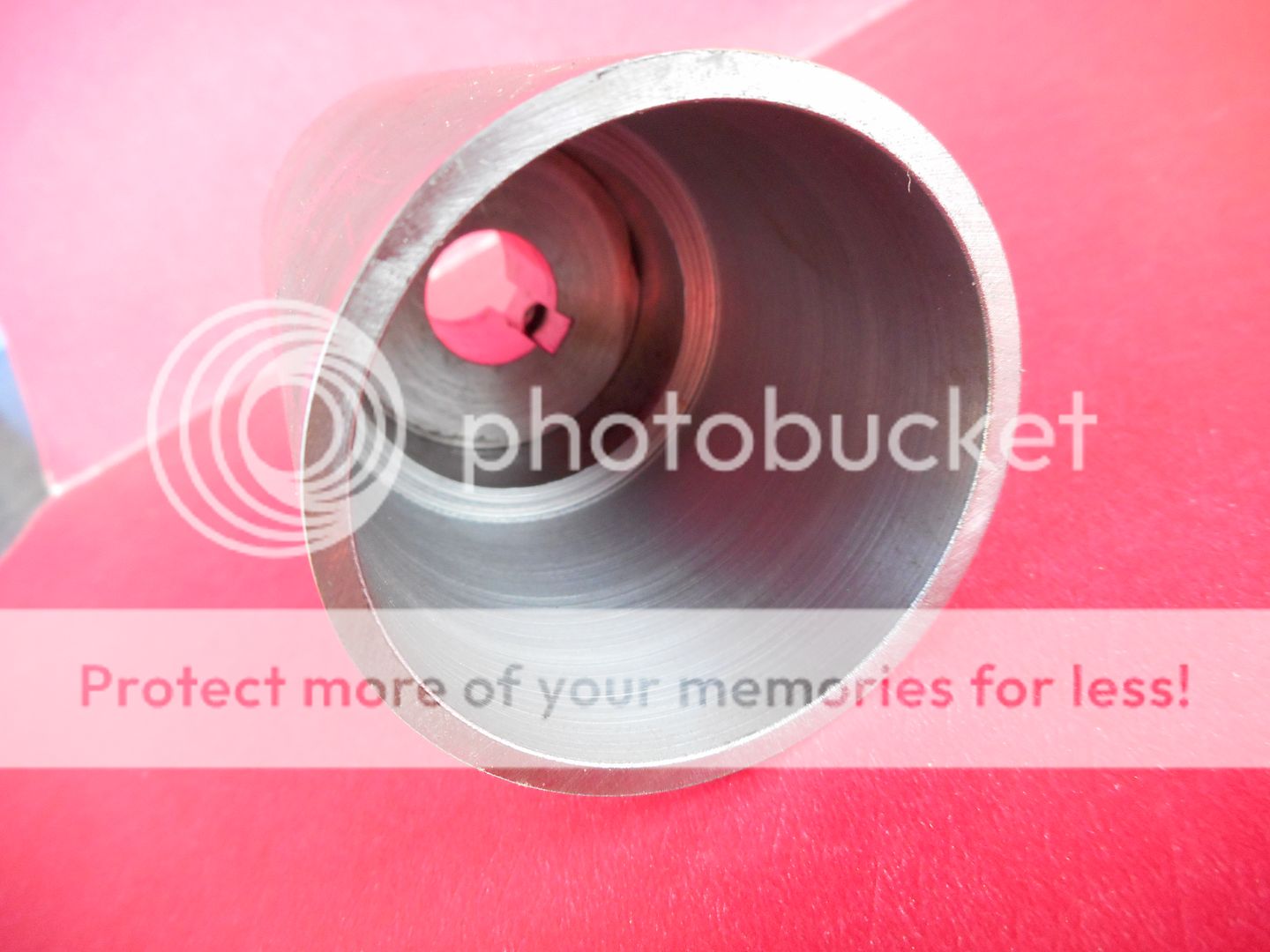

I found some thick wall tubing and pressed a smaller piece into it. Then I
bored it to 5/8'' and broached a keyway into it. It's a full 1'' to give lots of support. Then I bored the tubing to 1 3/4'' inside and made it long enough to align with the rear sheave and then sb can cut it to length and weld the pulley onto it.

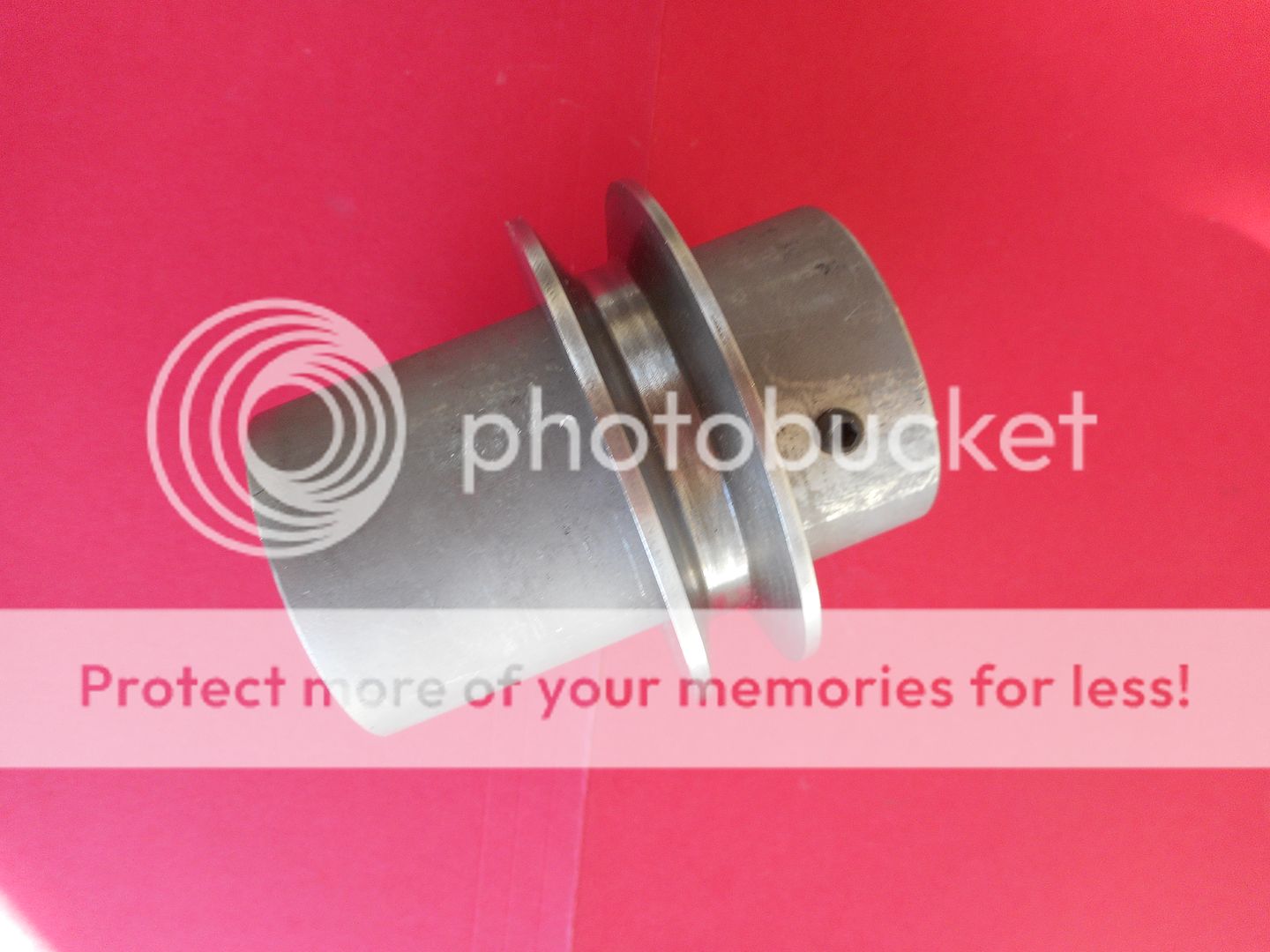

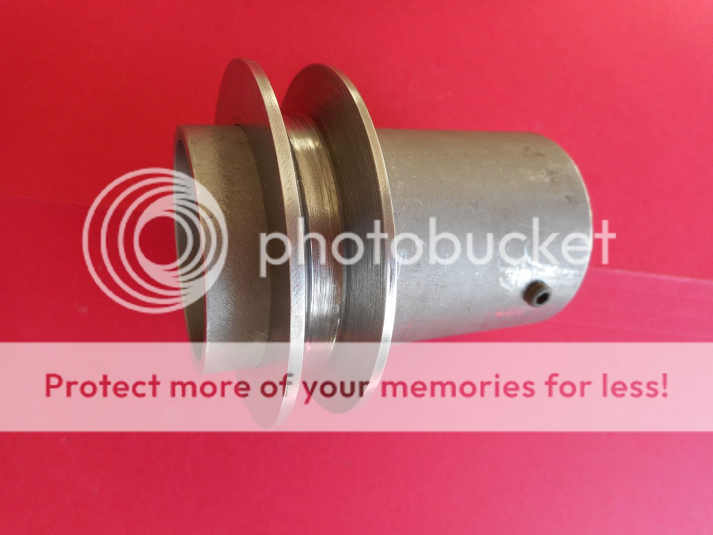

Okay sb, I made a crude pulley this morning that will help you set up your final drive alignment. It slips back and forth on the tubing. When you determine the position, just have it welded in place and remove the excess. With the close tolerances to work with, I could only manage a 3'' O.D. also. Curt may come up with something better, but you can use mine to get your dimensions.
PM your shipping address and I'll get it in the mail. We'll get this figured out one way or the other.

I can't thank you enough for your consideration, kindness and generosity. It is truly remarkable. I will try in my own way to pass it along as best I can. And really nice work, too!
