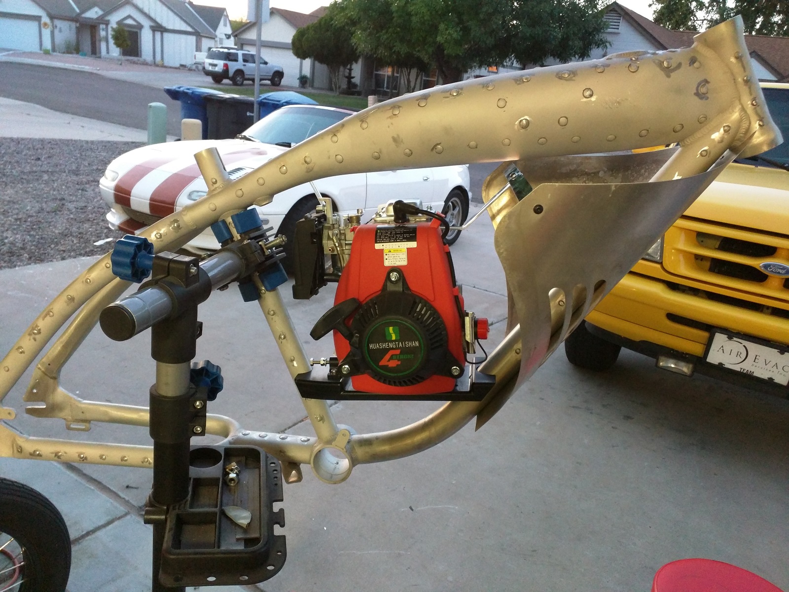

Haven't rode it yet, but this base design looks to be the functional base...
The engine has room to slide all the way forward and the 360 grip U-bolt clamp is still easy to get to.
It has side tabs to keep the flat part rigid yet bendable for tube angle.
If need be I'll supply a couple little drilled pieces and bolts to set the angle and keep the shape at the bends via the side tabs.
The front is the easy part and where extenders for wider frames will go.
The business end is the back end and transfer case mount.
The TC has new mount holes to lower the extra long output shaft closer to the base and below the oil filler.
Yes, it's a breeze to change the oil with a syringe with this design.
The back piece sports 2 360 grip U-bolts to mount it flat against the back side of the seat post.
This is what gives you that 3rd strategic mount so the engine has no side to side wobble, both clamps are easy to get to and adjust, and once all 3 are tight nothing moves.
The main point however is how to get that to the pedal system.
Just a little engineering and metal work ;-}
Even on this tight Fito with 3" wide tires and extreme seat angle this design fits right in.
Both the pedal chain ring and 9T sprocket can be moved laterally for perfect chain alignment, and the little tensioner sprocket has almost no torque against it with engine power, or even with pedal power as the output shaft freewheels at the 100T T-belt pulley, and it is adjustable so no chain tension issues anywhere.
In fact, this 4-stroke shifting system is actually more sound than direct drive...
The drive chain is shorter and the tensioner much easier to keep in place.
Go figure I'd pull that off and with some luck have some for you guys to buy soon if you are liking this this solution ;-}

Put up a pic of your frame and the measurement from inside the seat post to inside the down tube, level to ground, ~1" above the pedal sprocket, that will be your base length.
This Fito for example is only 7" but the stock engine with can exhaust and awkward air cleaner even fit.
Competence is high we can even get the stock chain guard on.
We had to trim the flywheel cover where the tensioner is and cut the choke lever down but she fits nice and solid.
