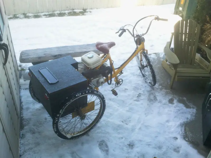

    well sorry for not keeping you guys up to date! The trike is done and I got about 900km on it (it is my daily commuter lol). I started on it at the start of april and finished it up around the end of the month. It has been quite fun and a learning experience tinkering with the motor and making little improvements here and there.
    oh and the top speed on flat ground with no wind is 70km/h or 43mph

    Thanks for bringing us up to date on your trike build. That is a very impressive bit of work there. Congratulations. Enjoy and ride careful.

    Nice work.
    Very clean. I like the big cargo box. You can get a weeks worth of groceries in there I bet.

    Yeah the cargo box is pretty big, I have had backpacks, my full size helmet, and in one case a whole computer in there haha. Havent went grocerie shopping yet. One of the advantages to a trike for sure.

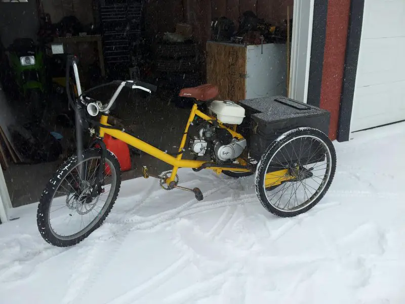

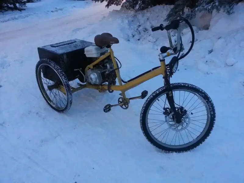

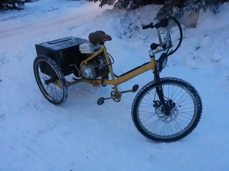

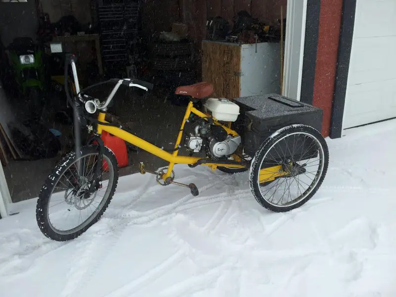

    Well some more updates, I am using the trike for a second season and its approaching 2000km. I did some safety related modifications.
    -New fork and brakes (dual 8" disks with avid calipers)
    -Rerouted exhaust to exit very rear of bike (used 3/4" plumbing lol)
    -Revised the lighting system. LED headlight and brake lights for decreased power consumption.
    -Some maintanence on the motor. Adjusted the valves, cleaned the carb, changed spark plug, and changed the oil. I am very hard on the engine and it still runs as good as the day I got it, perhaps even better!

    Some old winter pictures.
