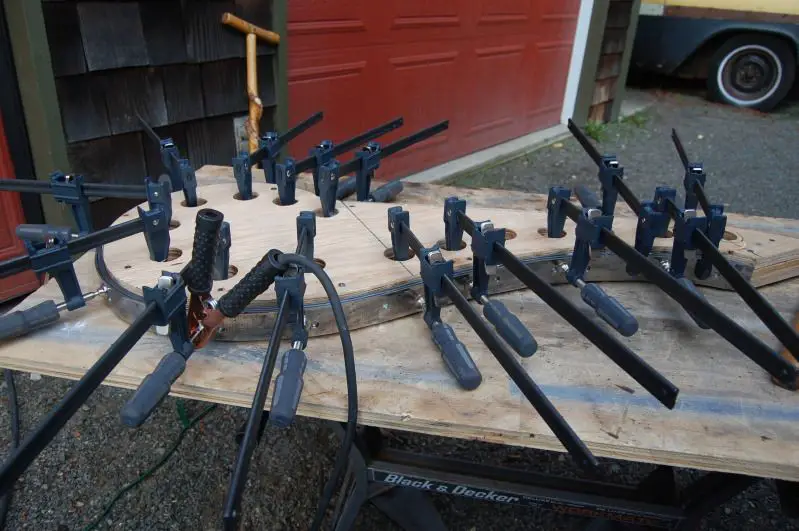

Just sat down from drilling the holes in the spring leaves. I'm pretty confident that this will work to our advantage and if it needs a couple more leaves I'll add them. May add a couple of supports under the seat to the front axle as well. No one will see them unless we run over them and then I'm confident even then they will be more concerned about self preservation than the correctness of the supports.

Steve your springs look good. Clever jug you made just like the old wood benders jig.

We had a rare sunny day here and I was able to get the springs welded up. Mr B's thoughts about welding them up with rosette welds worked beautifully and they went together quickly.
Each weld was ground down before the next leaf was added. There are 3 leaves on each one at the moment and I'm going to add a 4th when I get more metal on Tuesday.

That's looking real good, Steve. I hope your fair weather holds so you can keep right on working and sharing photos. Summer isn't all that far off now. These tri-cars are going to be a lot of fun!

Really pleased with the way the springs worked. I'll have them finished this week with luck and mounted so we can get a look at just what we have after all our planning. They do have some springing action as a bonus.
Once I have these to where they are working right I'll build a second pair.

Glad to hear this is working well!
I was a little nervous about a untested idea and still hope they will be strong enough to support seat & rider.

I had planned to bolt or rivet the leaves together and when you suggested rosette welds it made perfect sense to me. I look at these as more seat supports that look like springs than springs but there is a surprising amount of spring action in them.
I was wondering if the heat from the welds would cause the metal to soften but there doesn't seem to be any. At 250 pounds I'm not light and I leaned on the C part of the spring as hard as I could and when I let off it, I compared it to the other spring and there was no difference in shape. The original springs had two 1/4" thick leaves so I figure that 4, 1/8", leaves will work alright. I hope to have the seat mounted this week and I'll give it a test when I sit in it. I can hear the springs screaming in agony now, along with begging for mercy. :)
